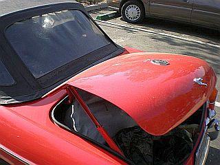

I also noticed that the trunk/boot lid appears to have a bubble or bend up on the drivers side. I suspect someone attempted to shut it while it was locked into position. How malable are the trunk lids, or is this a big issue to repair?

The trunk lid on these cars should have had two supports from day one, as many have that bend in them for the reason you described. It's hard to get that bend totally out. If the inside brace isn't broken, I'd lay it on a piece of carpet to protect the paint, just as it sets on the car, apply some hand pressure on that spot might take a bit of it out. Only push on the edge, and if you can straighten it some, I'd get a kit from Rick Ingram with two compressed air type supports, one for each side. I guess Rick still sells them. Like some say, I'd relocate the cut off switch to another area. Kind of amusing located where it is. PJ
Yes...I'm still in operation... contact me off-list for information and pricing. (Thanks, Paul!)
Here's what "can" happen when a friend tries to "help" out...
