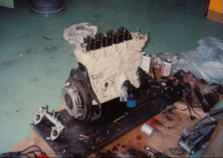

Opting for practicality over originality, I painted mine Cummins beige. I like the color and oil leaks etc. show up nicely on it! Topped it with a crinkle-finish valve cover and it looked sweet! /bcforum/images/%%GRAEMLIN_URL%%/grin.gif

bugimike

John Moore
A local guy here has a MGB V8 and he painted his Rover Engine Cummins Beige, it looks great! Also, glad to see you have a can of 'wrenching fuel' near your engine too! LOL!

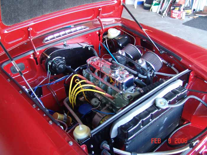

I chose Austin-Healey green from POR-15. This is a brush-on enamel but you can thin it with mineral spirits to spray items like valve covers. Blocks, being rough, take brush painting very well. The POR paint was excellent. One brush-on coat did an excellent job of covering and the paint has held up much better than spray paints I've used. They have other colors and perhaps they have a red that will match your Longman head.
See my engine at:
https://home.mindspring.com/~dklawson/minipics/EngineCompartment1.jpg
