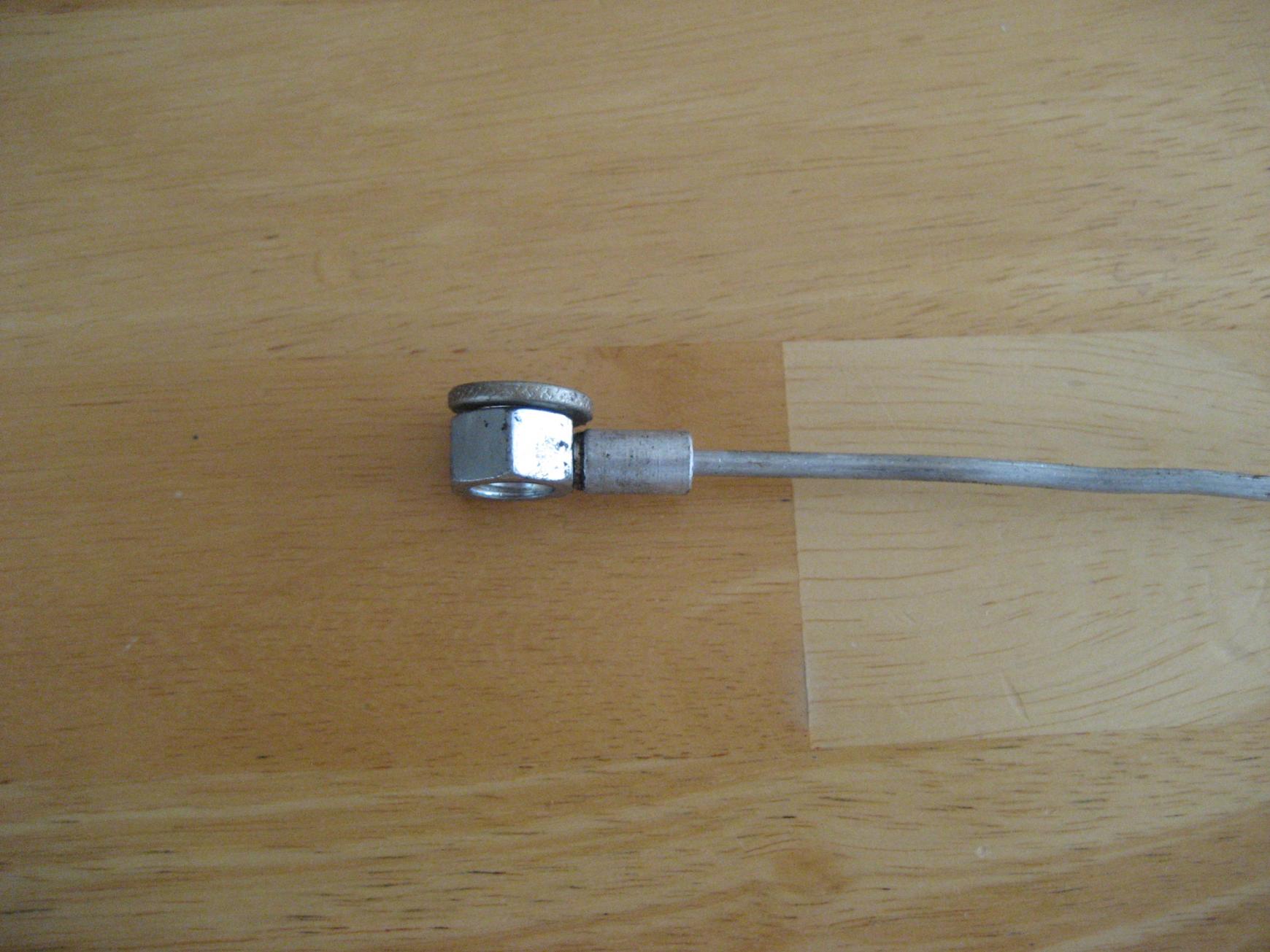

Hey guys, I just discovered a very easy way to get the top nut and washer "started". I used a magnetic parts picker-upper to hold the nut and washer.
Worked like a charm; the nut went on in seconds...

Thanks, a real Top Tip!
