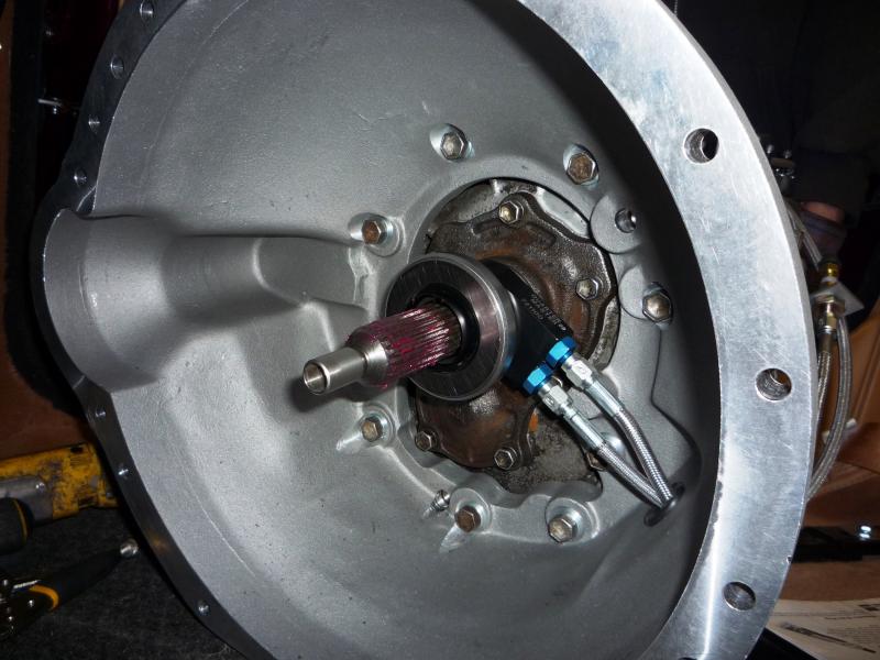

In another forum, I have been watching a curious Midget project - the guy is swapping the engine but keeping the transmission (which is the opposite of what I would do) More to the point he has installed a contemporary thrust bearing. Thought it might be worth sharing here.
Thread is here: https://forum.retro-rides.org/thread/208938/1963-midget-nissan-cg13-project
thrust bearing is this:
Is that a hydraulic throw out bearing?
when I did the 5-speed conversion on my TR6 I got rid of the clutch slave cylinder and installed a hydraulic throw out bearing. I like it!
do you have pics? Also, how did you determine which bearing to use? and, how do you bleed one of these puppies?
thanks!

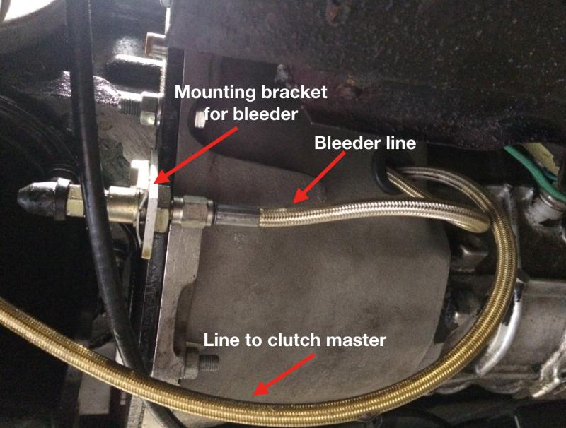

I found a pic.... hope this helps.

Elliot, where does the second line go in your picture?
JP here's a photo looking up from the bottom of the car. One line goes to clutch master, and the other line (bleeder line) terminates in a mounting bracket attached to a mounting bolt on the bell housing.
Thanks for this! I wondered if that is what it was. I am tempted (one day) to plumb a similar line at the high point of the 1500 clutch line (higher than the MC)
