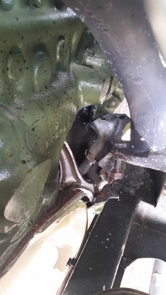

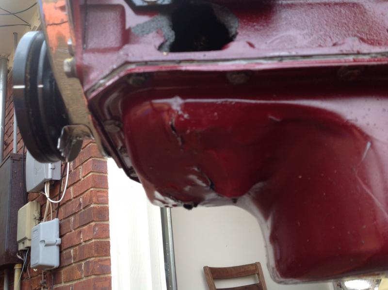

Major engine failure a week ago Saturday. The picture pretty much says it all. :(
Looking for leads to a replacement 1275 block around the Portland Oregon area.

You need to see what you can salvage since you will probably need much more than a block. When mine (MGB) let go everything but the head was trashed and a few external ancillary parts.

I'm sure your correct that I will need many more parts than just the block. I will be tearing into to it more over the next several weeks to see what all is salvable.

No warning. It had less than 2000 miles on it after a rebuild/refresh (at a shop that's no longer in business). I thought the work done was good, so not sure at this point what failed.

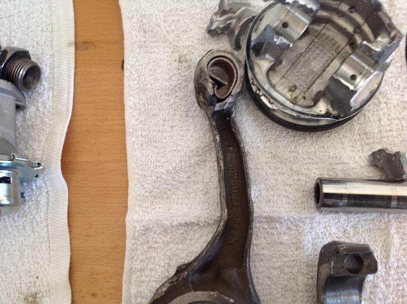

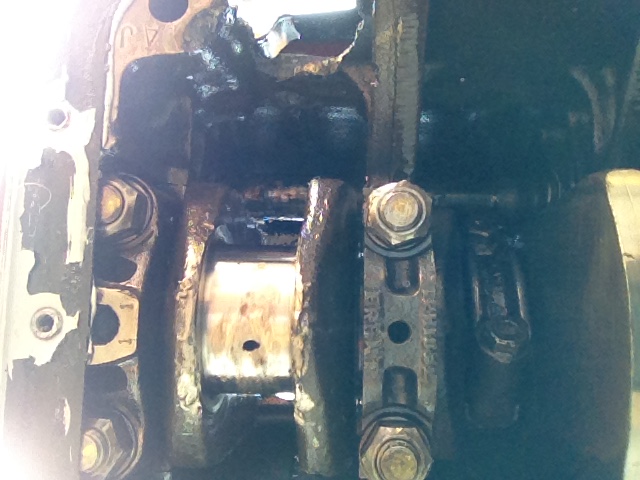

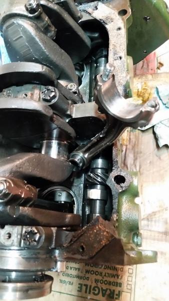

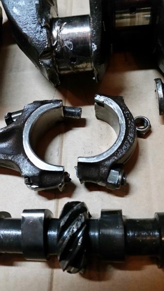

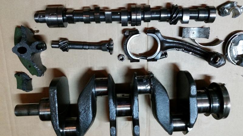

Have engine out and completely dissembled. As BlueMax suggested it looks like #3 rod bolts failed or came loose (one nut sitting in pan). The block, oil pan, rod and piston of course are ruined. It also took out the distributor drive as well as the drive gear on cam.
To sim’s question. This happened under normal driving. Just light acceleration up a hill.
