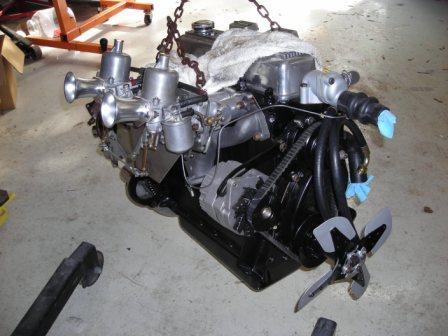

Piece of cake! I recently built an engine for a TR4 then changed my mind and put it in the TR3. Quick swap.
