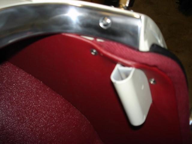

Well here is one. Think I do not have a pic for the rear but it is tucked behind the board and held in place with that screw just near the top bow holder.

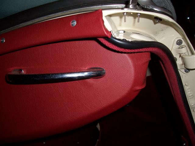

Try this, I will keep looking. And guess what, this is not Miss Agatha. Just a shot I had to show what was done behind the seats.

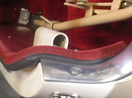

This is what I have for the other end for my BE.
Scott in CA

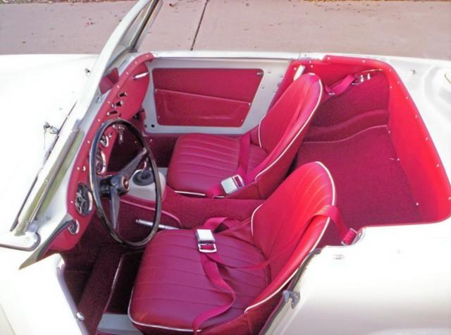

Hear is the final, I hope, word on what to do with the rear of the door seal on a BE. See the above pic for the front.
