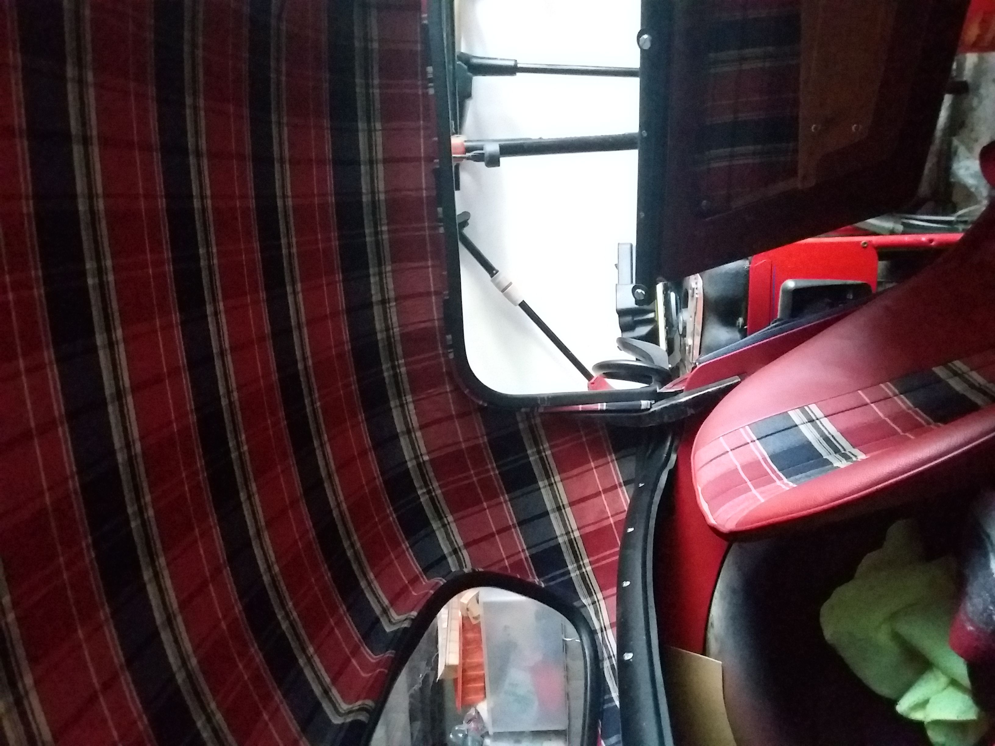

I've committed the sacrilege of installing a headliner in my frogeye hardtop
My idea was to salute the Union Jack and my scottish heritage while coordinating with the red paint and pearl white hardtop. Oh yeah ,I went with blue carpet.
Love it. I've considered doing a headliner in my hardtop when I get to that part of the project.
