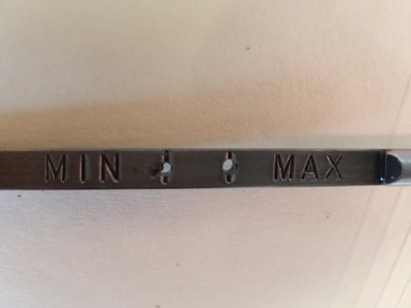

I just checked my car and there is no washer brazed to the dipstick nor has there ever been one since I have owned the car. That is not to say that there should not be such a washer but there is no "stop" on the dipstick as mentioned by Red and perhaps the repeated in-out of the stick by previous owners broke the braze resulting in the washer's loss, etc. In any case--on my car at least--the bottom of the dipstick is definitely landing against the inside of the sump which sets the depth of the add/fill marks on the stick which have worked for me over the years.
I am attaching a close-up pic of my stick showing two small holes I drilled at the add/full lines. When oil is fairly new and has not yet picked up a lot of contaminants, etc. it is sometimes hard to accurately read the oil level on a stick. However the presence of oil provides a film that remains in the holes, whether or not the oil is clean, and makes for easy reading.
