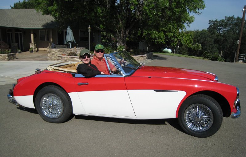

I have a picture also. The resolution is low so the red looks a little washed out.

:thumbsup: Very nice! But, who is the happier one, driver or passenger??? I truly can appreciate the thrill of your drive as my first Agatha drive is still in the forefront of my memory and it began the first of many journal entries. Enjoy - that is what life is for.
J
Jerry
That is my daughter in the passenger seat. She has always "claimed" the TR3 as her car. But after riding in this one, she may change her choice.
