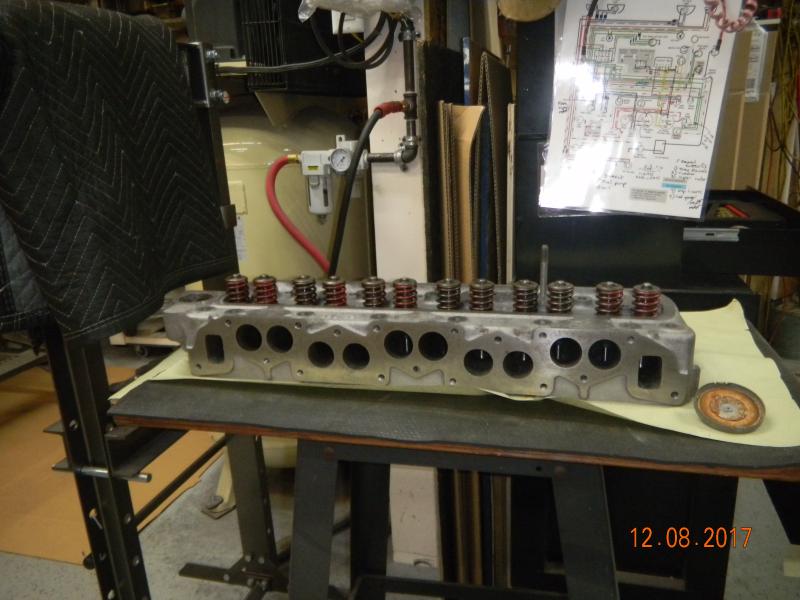

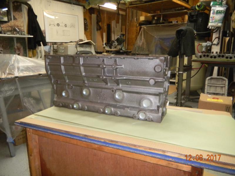

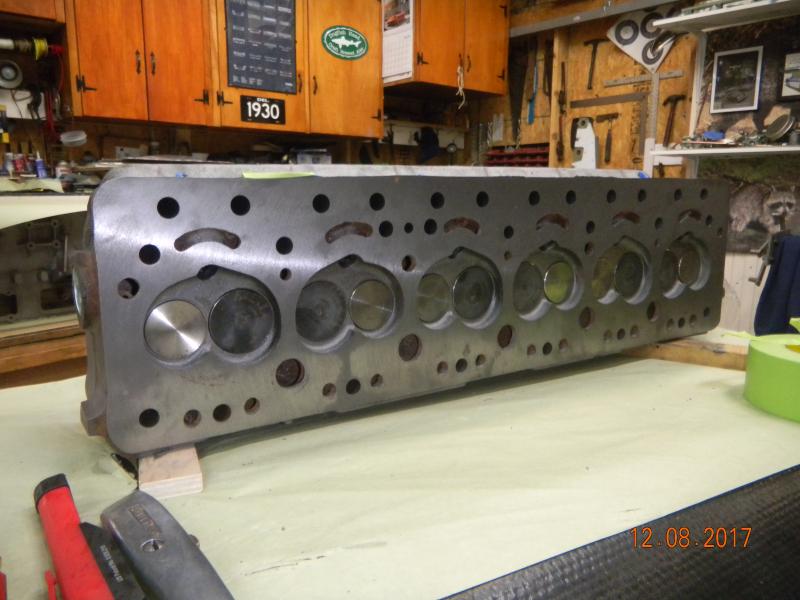

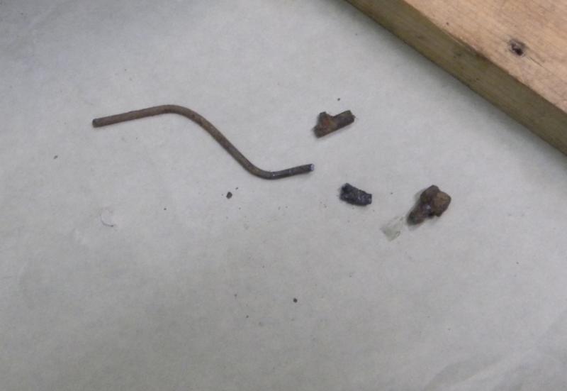

got my head and block back from the machine shop. while blowing out all the passages i found this in the one coolant passage. fullsizeoutput_17b.jpg had to break it a few times to get it out. first i thought it was something from the casting. still not sure. it was hard to break and pretty brittle.
CraigC
It looks like one of the wires that support/strengthen the cores when the block/head were cast. Not uncommon.

at this point i have gotten my crank, block and head back from the machine shop. my original hope was the engine would be in fine shape and i would just need to do some minor work to get it running. but when checking the main bearings, i knew that was not the case. the crank was turned to 10 over on the main and rod journals. the cylinders looked really good so we just reamed the top and honed them. they are standard bore. originally i thought they had liners in them but discovered they did not. just looked that way from the bottom of the engine.

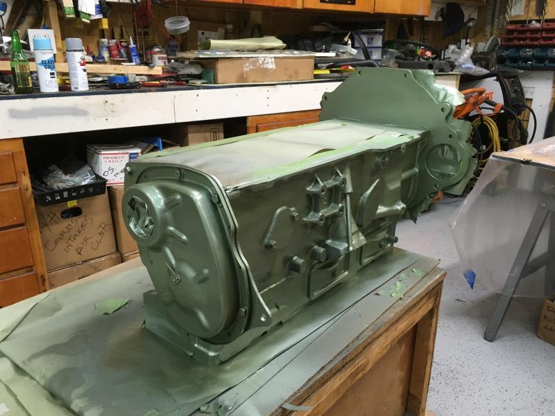

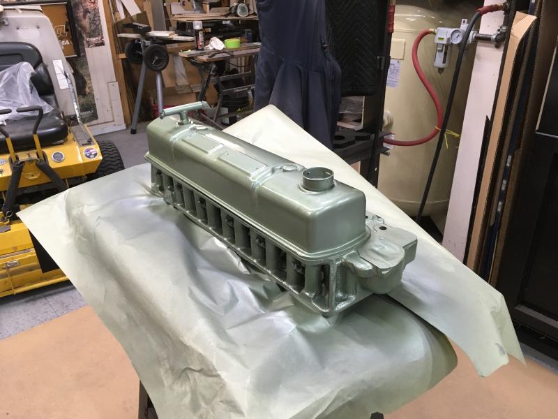

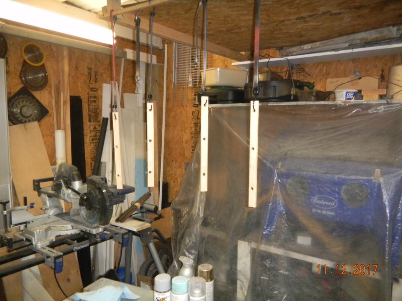

at this point i have ordered bearings, rings, and a host of other parts to start this rebuild. i ordered them thru Tom's toys in oregon on the end of year sale. with Christmas coming i knew i was going to be very limited on time over the next couple of weeks. So right now i am just trying to get prepared. first thing is i wanted to get some paint on the engine parts before too much rust starts to form. So yesterday and today i have been painting. (some parts i had painted while waiting for the machine work to get done.) i realize i will probably have to hit it all again once assembled but i wanted to get some paint on now.
thats about it for now. i realize there will be some surprises. (see thread on cam bearings) but that is part of the fun. And expect lots of questions to come.... for instance i just read somewhere that the head bolts should not be run down to the manual spec but hand tightened. they could crack the block if torqued. not there yet so i have not worried about it. one step at a time.... ha

One of the wonderful things about all the photos members post is seeing their work spaces. Always a joy seeing what they hang on their walls and how neat or messy their work space. Certainly adds to the enjoyment of watching someone else's rebuild.

I did the head on my 80 Spit and the head on my GT6 and both had stuff in the passages, almost thought it would have over heated the GT6.
