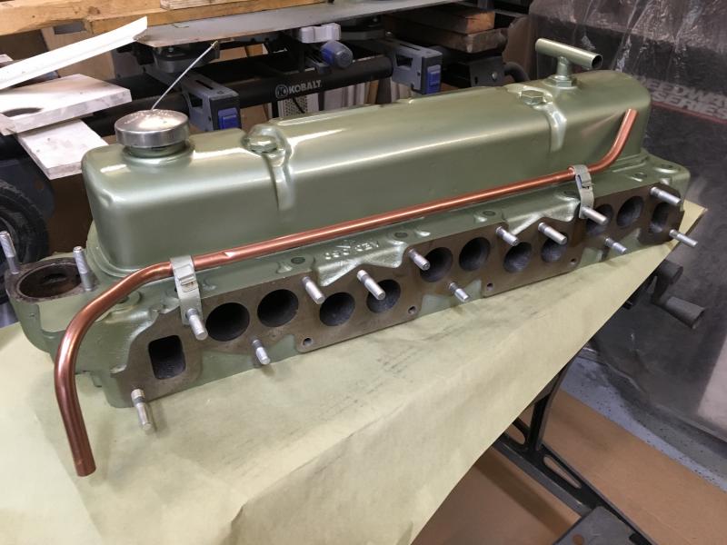

i purchased three different manifold studs for the head. went out today just to see where they should all go. the parts pictures i have are not very clear. basically you get 5 short intake studs. 2 long intake studs and 6 exhaust studs. the 2 long intake studs and the exhaust studs look just alike to me, so really i got 8 long studs and 5 short ones.
in the pic below you can see how i placed them in the head. the three center ones at the bottom and the 2 center ones at the top are the 5 short ones. is this where they should go? i do not want to put longer studs in where they might hit the throttle linkage or something else.
Thanks

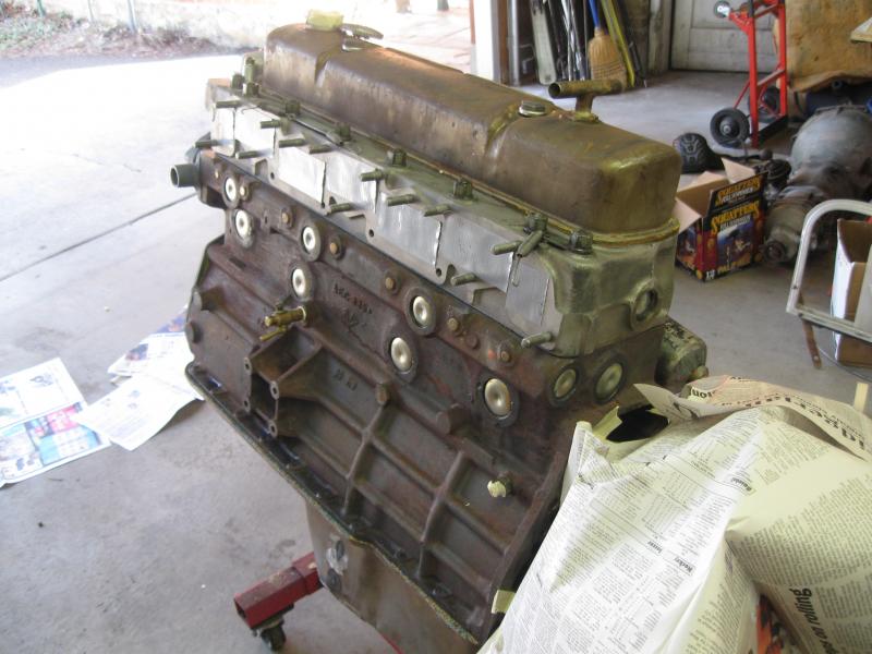

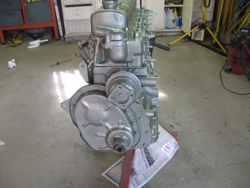

Here are a few pictures that may help.
Keith
Keith
Thanks for the pics. i tried to blow them up. it looks like you have seven short studs and six longer ones. not what Moss shows but maybe i have something mixed up in the way i read it. might order two more short ones just in case.....
