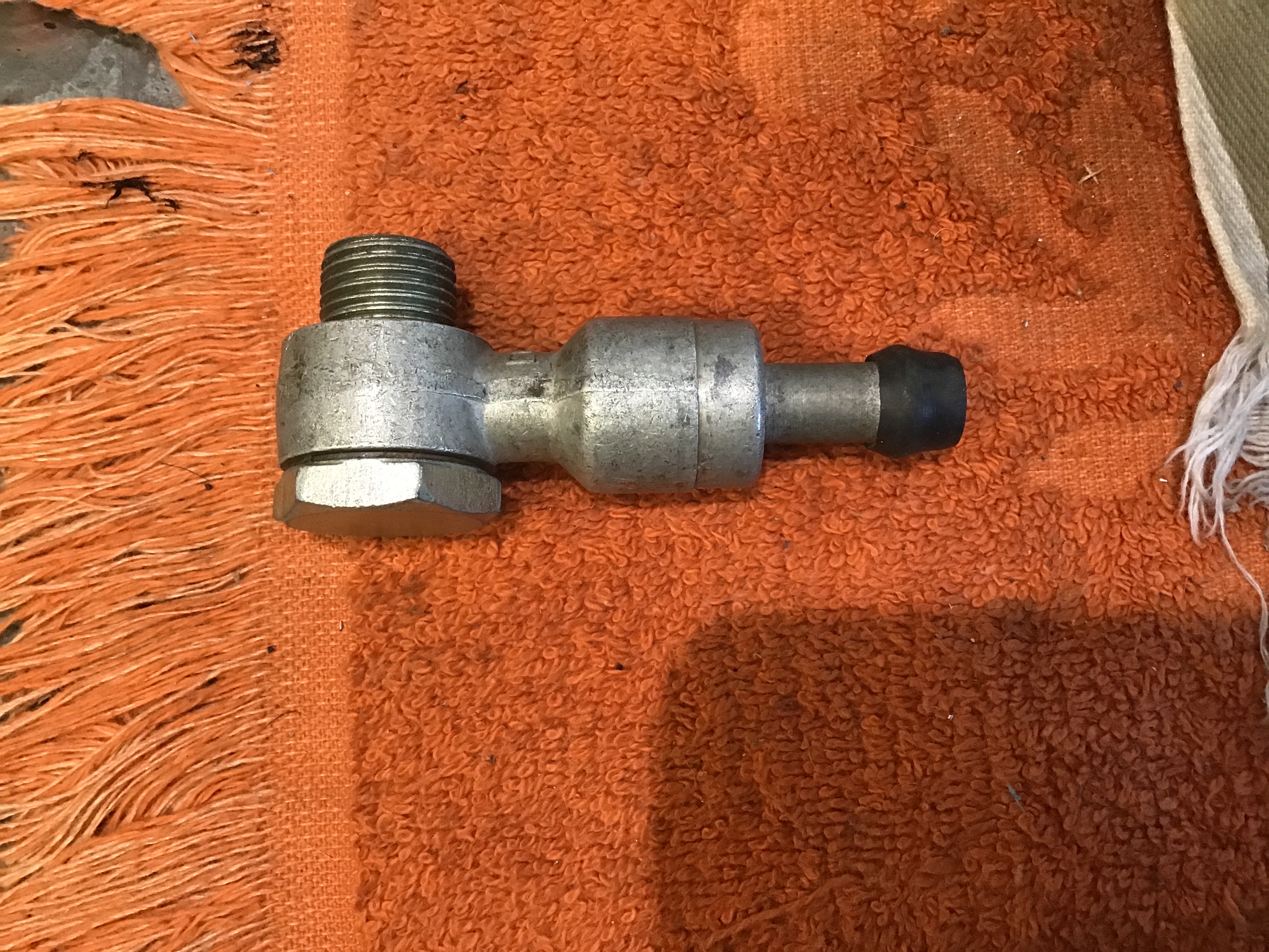

ok the previous owner has fitted a brake booster. there is a unconnected tube, I assume this is to get Vacuum from the engine. how and where to I connect it in ?
steve
Moss #582-996 is the check valve that was on the late Bs that came fitted with the brake booster from the factory.
thanks
i have to remember to check the B pages for engine stuff
Here is another style.
