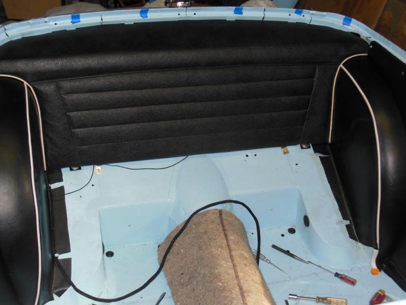

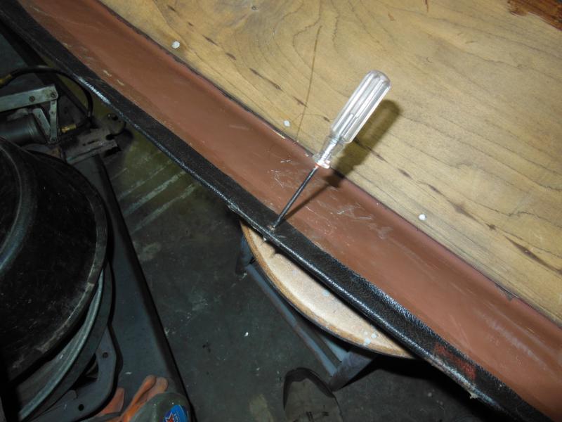

I noticed something I had not been aware of in that there was some kind of bracket used to hold the top part of the back seat in place; the bracket looks simple like perhaps a J shaped hook to fastens to the seat and then to the tub and is covered up by the trim. Does anyone have a picture of an original?
I've had two TR3A's and neither had a bracket there. That's not to say that there wasn't one, but the seat back stays in place without it.
Yeh I have had a few tr3s myself and none of them had a bracket. I did have the seat keep sliding out of those slots one on and drilled a couple of holes on the very lip of the back side of the seat and pulled the seat in from the trunk and wired it to those C shaped brackets that the seat wedges into.
I have no life, so finding new things on a tr3 interest me; how exciting. Anyways, when I noticed how the tub had a recess where the back seat goes and there was a corresponding hole in the seat, I thought I had figured something new and astonishing out. Perhaps I could make them and become rich.
The way I see it there was some engineering for something there and maybe the early cars had something.
David posted a bracket for the steering column that I had never seen before-- plus I kinda thought before there should be something there to hold that side. Moreover, the radiator over flow tube bracket was unknown to me until a couple years ago, so there is hope for more unknown parts on a tr3 kind like "exhibition unknown" on TV.

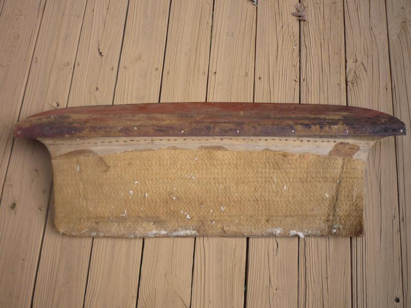

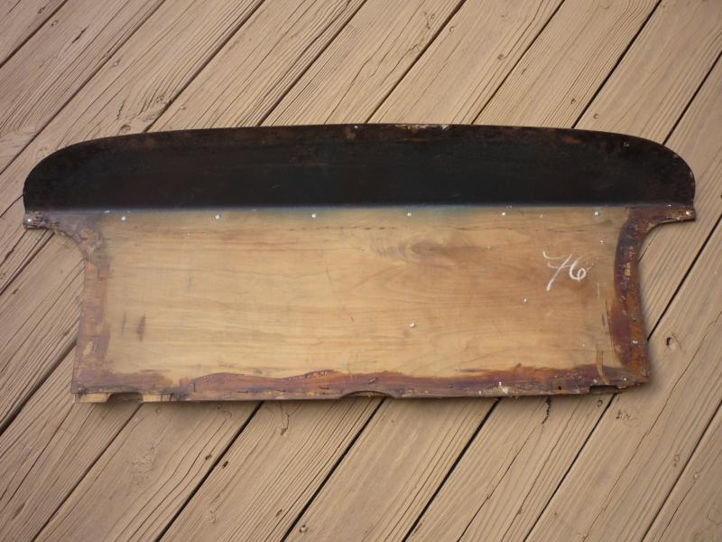

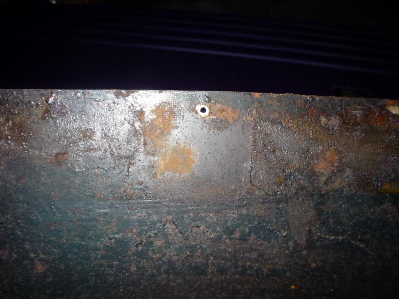

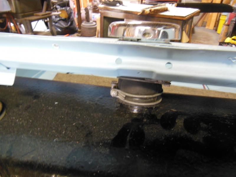

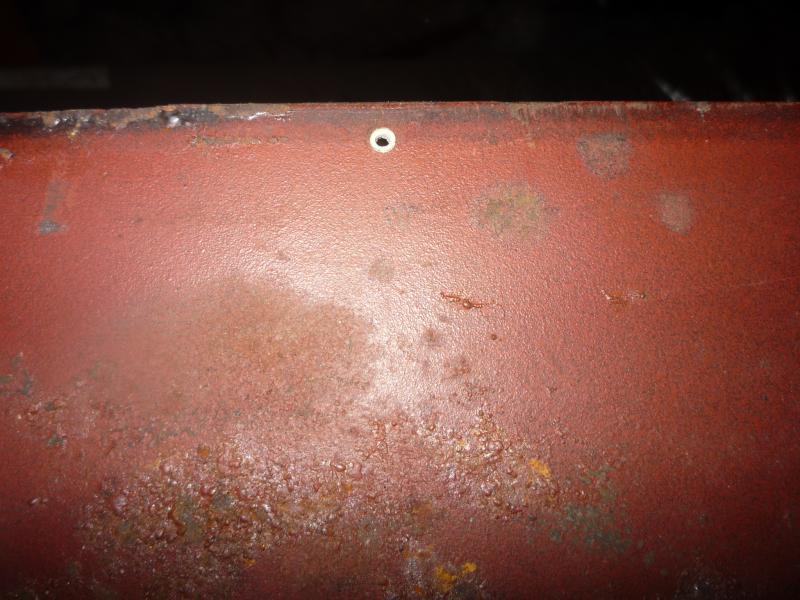

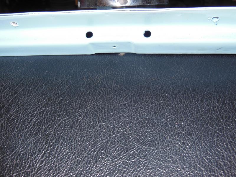

I hear Tropic6 I have those holes also, and I have a hard top hooked up with all the fittings on another car. This indent is dead center and has a recess for something to slide back into right at area around the gas cap on the sheet metal of the tub. Is that a 3/16 hole I see in the center at the top back of your back seat panel or a speck of dirt?
OK - I see what you are talking about with the recess and small hole. I think my back panel does have a center hole but will confirm tomorrow.
My guess is a bracket that looks a lot like the other back seat brackets on the tub but was screwed onto the seat first then when the seat was slide back a screw was put into the tub to hold the seat from sliding forward. Or maybe kinda like the ones on the bottom of the seat; something simple. I have had the seat slid forward before and wired them back. Don E would have probably known.

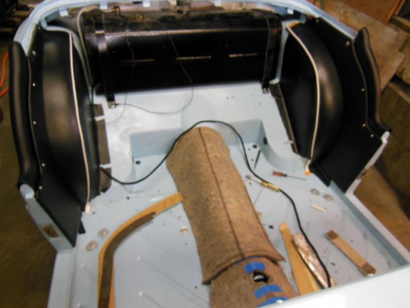

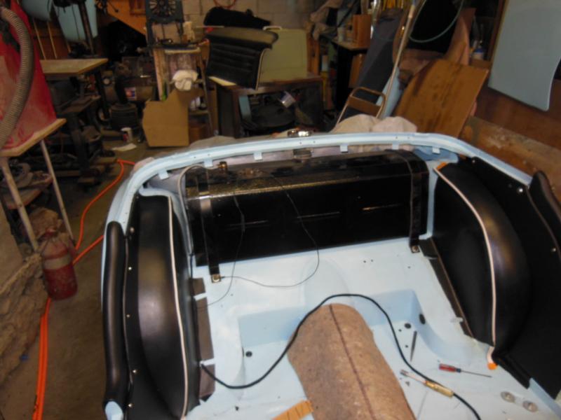

I got the back seat in anyway. The hole that is by that tentative bracket I suggest is also the center for the trim.
I struggled with how to do it; I cut some foam but decided to glue right onto the medal. It is far from perfect and I pulled it up and glued it 3 times. After getting sooo much glue on the seam and moving to 3M 99 for better sticking, I was able to turn the hard nylon seam down--- then laying the glued up mess flat parts of the nylon seam down the edge of the arch.
It might have been better to take some very fine cotton batting and put some on either side of the seam, just a little; it was something like that originally . Moreover, this really nice retiring upholster named Char made me some softer white piping to go around the trim.
