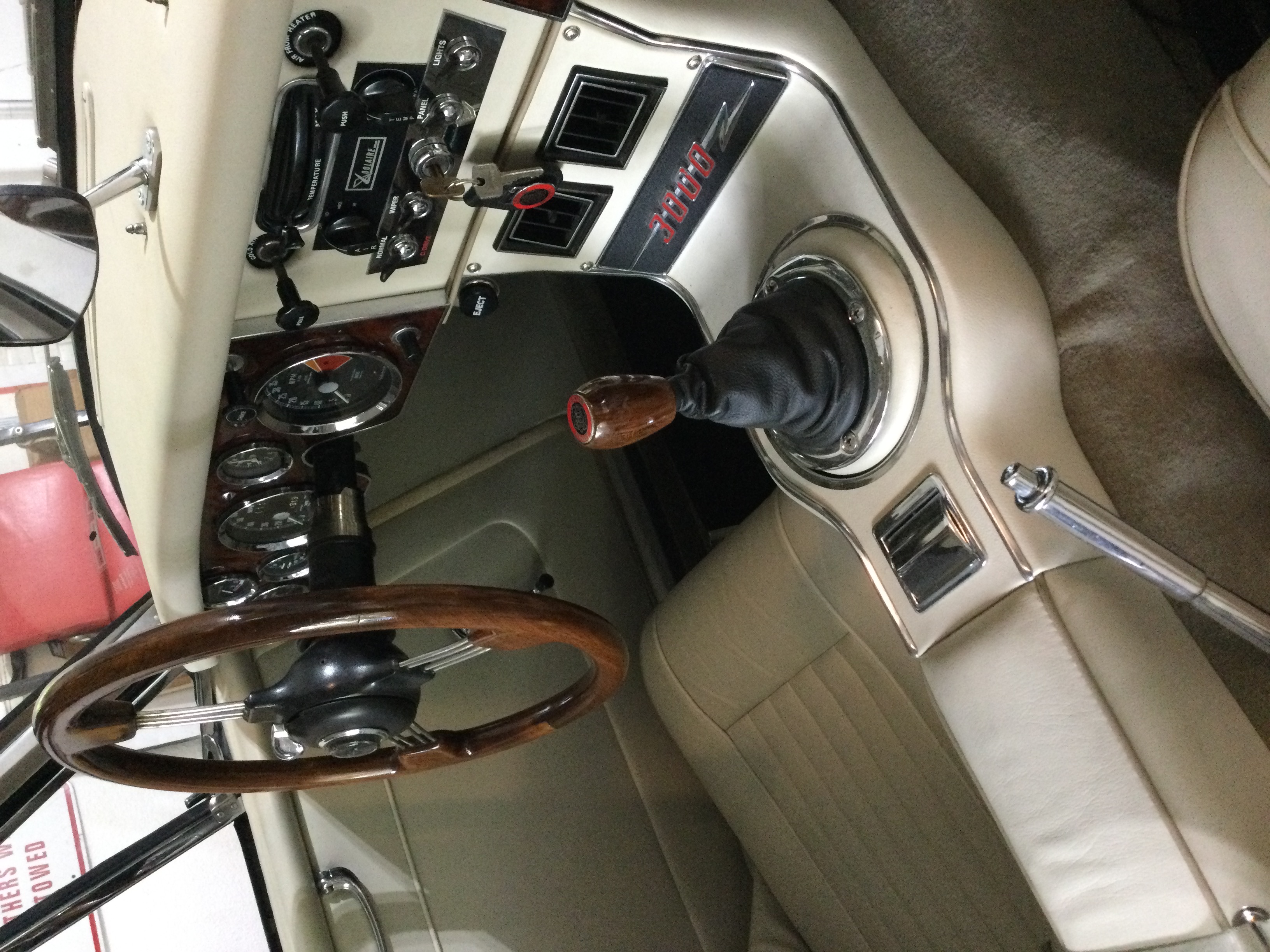

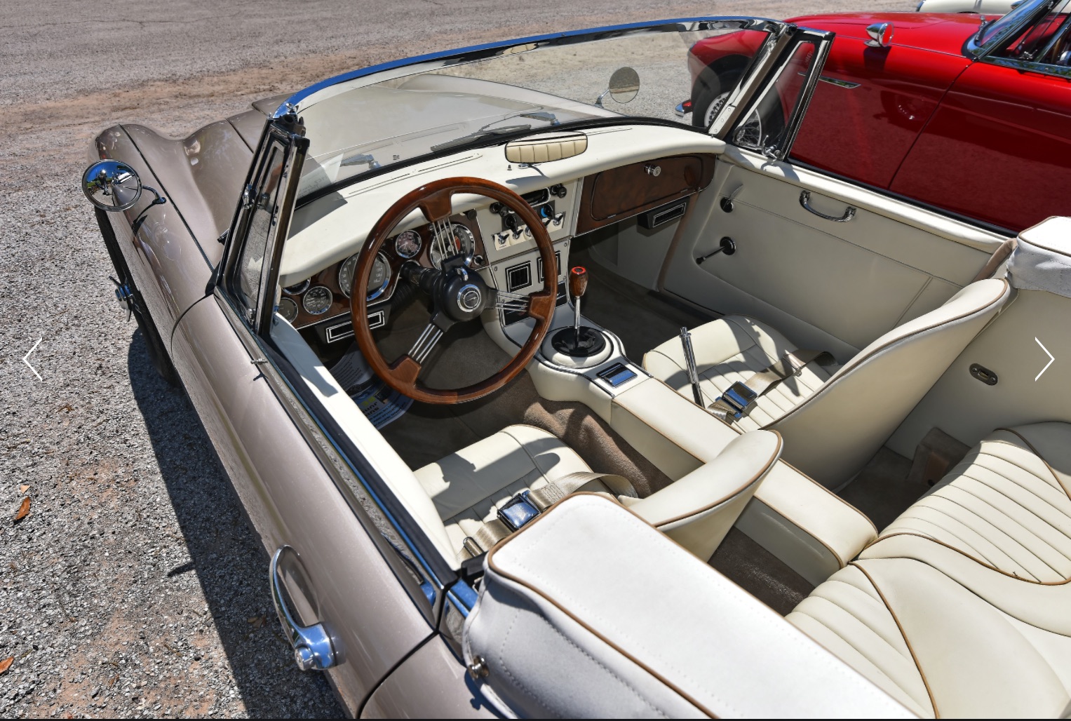

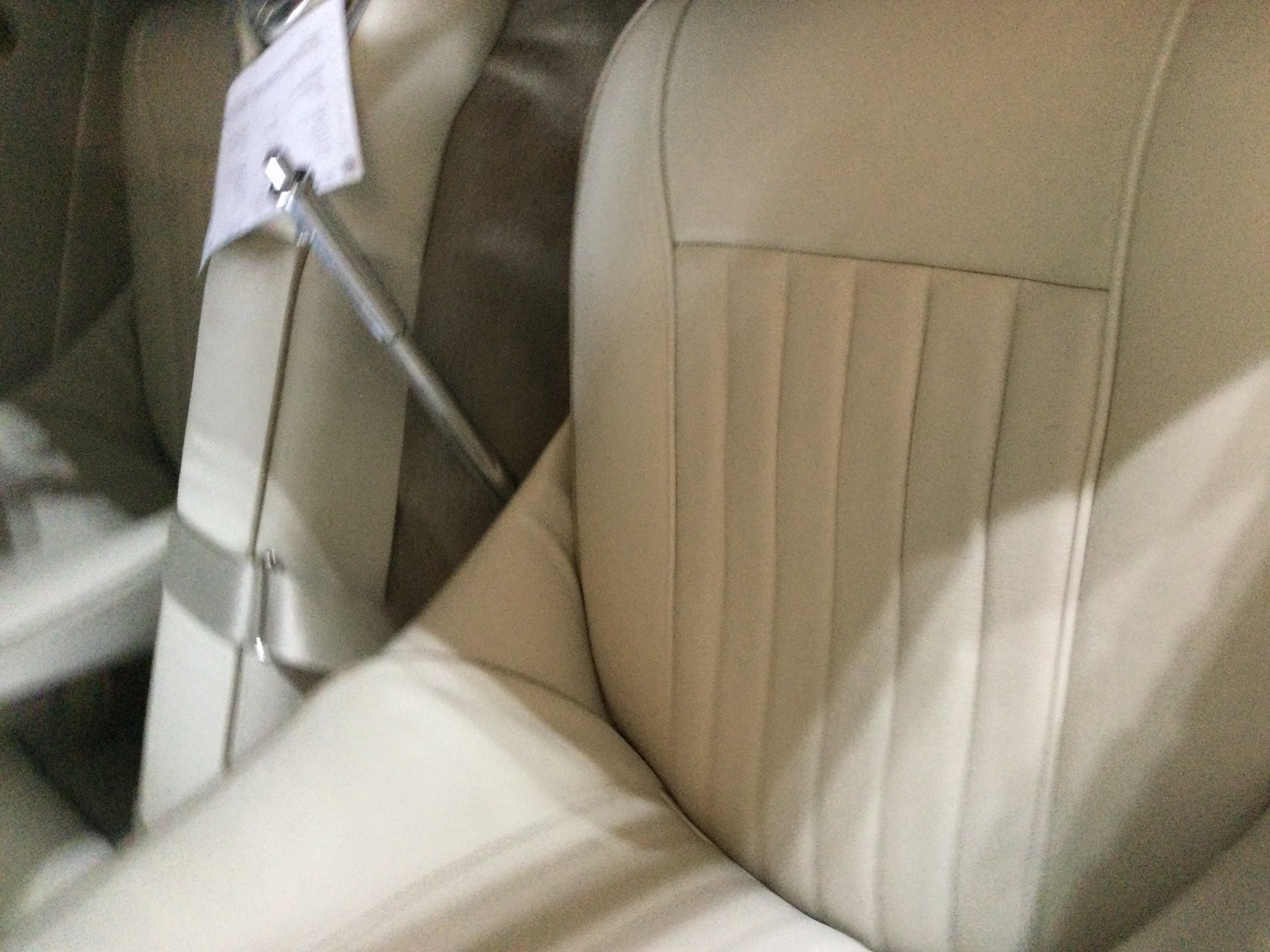

Here is some photos of my interior. The color is “grey”, but is more like a eggshell white. The rear side panels are smooth because I wanted then that way. The Factory would have still used the “square” pattern which didn’t match anything else except the rear squab in vinyl interiors. I also went with the same color for door arm rests and dash pad. Seat Piping was done to match the carpet color. There were some BJ8’s from the factory with the grey, but had red or black carpet. Somewhere,I have photos of them.
