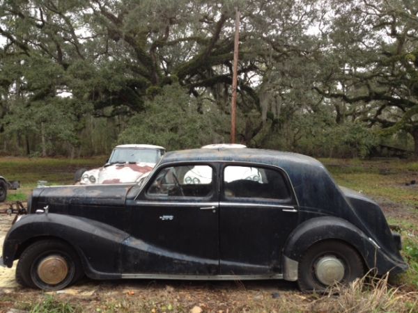

A buddy and I just purchased a 1949 Austin Sheerline A125. We found it local in Louisiana and for quite a good price. She appears to be very structurally sound (surprisingly no rust). We are planning to do more of a restomod with the mechanicals but make the exterior stock appearing.
She was delivered this past weekend and we spent two days cleaning all the "stuff" out. I purchased a shop manual for it. My experience has been with Corvettes and I am almost finished (will never stop) with my 86 Corvette.
I am sure I will have a lot of questions so please bear with me. I will need to find a bunch of parts and will be selling some I am sure. I do plan on rebuilding the engine as a side project.
How about some pics.
