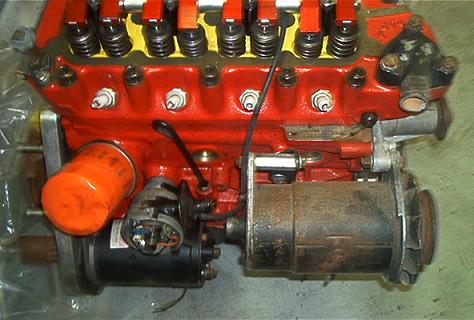

Here's a picture of the beast, notice what I was telling you guys about where the oil filter is located, pretty wild huh. I interested in finding out more about orgin of the block, Metro? Mini? but it for sure is a A+ series block, which probably means it has larger rod crankshaft journals as well, you the rod crankshaft journal stayed the same on all the A-series engine we're used to seeing 948/1098/1275, but that made them larger for the A+ engines.

Very cool engine. Should be interesting once you get it opened up and see what other goodies are inside.
Sure would make getting to the oil filter easier.
Very nice. Wonder how one gets ahold of such an engine???? /bcforum/images/%%GRAEMLIN_URL%%/smile.gif
Oh my goodness, looking forward to hearing/seeing more on this engine. Make it preaty as well on the outside Hap.
Rimflow valves, with ceramic coating on the exhaust valves and piston crowns, teflon coating on the skirts. Reworked head with volume-matched combustion chambers. Gilmer belt timing gear, 1.5 roller rockers, shaved flywheel, competition Datsun clutch, gear reduction starter, larger diameter alloy water pump pulley, wedged crank, reworked and balanced rods, three angle valve grind, and TOTAL rotating mass balance. (from harmonic balancer to pressure plate)

I guess we'll find out in the near future, it's awaiting it's turn /bcforum/images/%%GRAEMLIN_URL%%/smile.gif I'll say this though, nothing you mentioned isn't something I have already done before to a engine. It will be nice to see in a UK built engine, but I don't expect to be shocked, after seeing Huffaker, Tabor or my own work, we can do ever bit as good as the Brits can, maybe better in racing because we got much better gas to make some real horsepower with /bcforum/images/%%GRAEMLIN_URL%%/smile.gif Personally I don't see the need for the A+ block, if we can run them up to 9000 rpm in racing without a normal A-series block and not explode blocks, then they are pretty tough, although it does make for neat conversation piece and wil be very uniqe on the side of the pond. I would never suggest trying to find a A+ block from the UK for this purpose, too costly, too much overkill.
