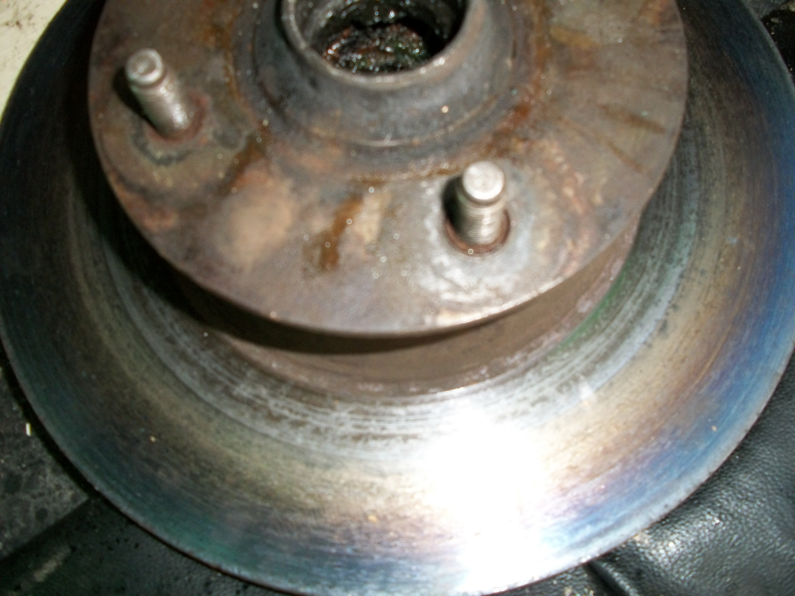

.IMy concern relates to the fact that the front drivers side wheel on my TR3 once locked up when I was going 70 mph. I fought the car over to the side of the road. There was a grease fire near both calipers that I put out with road gravel. After the tow truck brought the car home I took a look at the front wheel that was canted over about 15 degrees. The disc was heat damaged and scorched ,the caliper was damaged,the stub axle was ruined. i don't know why this happened and I'm being extra cautious with the new brake setup.I don't need the kind of adrenaline rush this incident caused.
