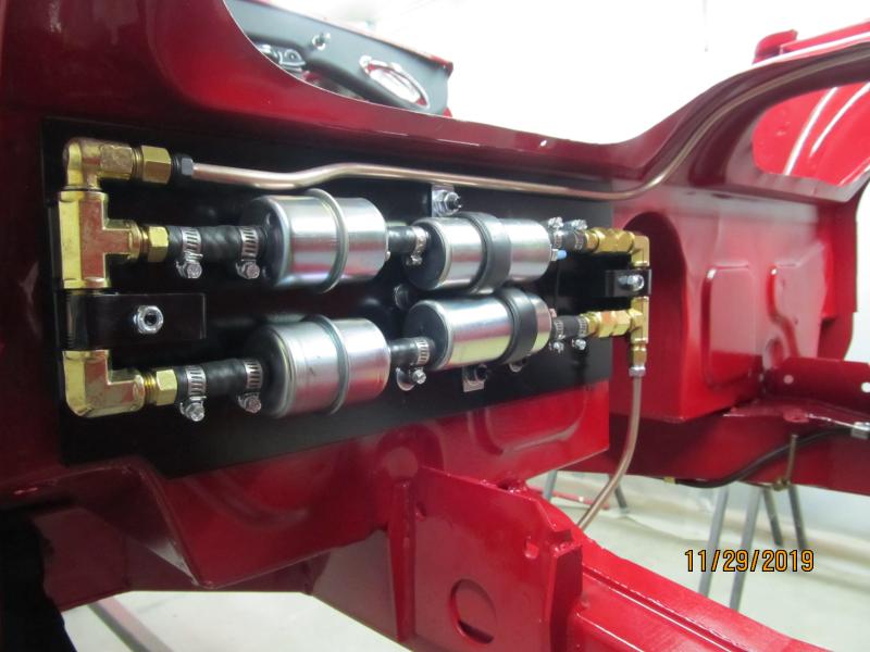

When mounted with the rubber isolator mounts, you can hardly hear them. My dual setup:

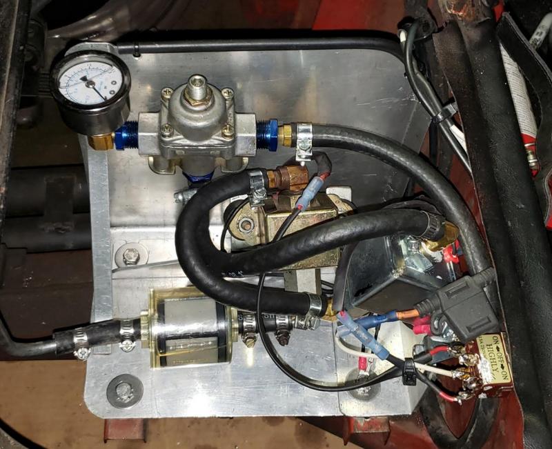

I really like having a back-up too. Here is a pic of my set-up in parallel with check valves (regulator is up front at the carbs).
Michael Oritt
Red--
That is VERY nice work--more along the lines of systems I have seen on high-quality yachts than on race cars!

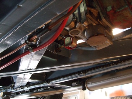

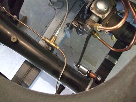

Dave you have done beautiful work with your fuel pump arrangement. I too spent quite a bit of time deciding which way to install a dual pump system. I have never understood the need to install fuel pumps on the Healey that need a regulator or an additional external check valve. Just seems more complication to me unless you are running a highly modified engine. So I decided to install pretty much what the Healey originally had except that I used two electronic SU pumps and installed them in series. One on each side of the axle housing using the original mounting on the right side and making an exact copy of the mount to the left side. I have been running this set up for about 10 years with no trouble. I also worried about putting the additional pump above the exhaust pipes. After trying different approaches to isolating the left side pump from the exhaust such as making a pan or box under it i decided that any attempt such as that was useless because if there is a pronounced leak the aforementioned appendages would prove inconsequential. The only protection being to do a good job installing things and then disciplined inspection. I did run copper through out, I'm not sure that is any more of a deterrent than rubber hoses because anything can deteriorate. In 10 years I have never had a leak, thank God. As a comparison, look at the fuel fittings around the carburetors that are right above the exhaust manifold. How about the small weep tubes coming out of the intake manifold and dangle right near the exhaust down pipes. All potential fire hazards. As for worrying about nesting the fuel line near the battery cable. Well that's the way it was built to begin with. If that continues to worry just separate the nest. I don't have a good pic of my dual pump arrangement but I have one of just one side. The other side is similar. Then another pic of the unnested cable and fuel line.
But of coarse whatever way suits your fancy. This is how I did it.
I think the main issue with pumps sitting above the exhaust was cavitation ('vapor lock') of the fuel above the hot exhaust. Kinda moot since you have the same issue with the carbs sitting above the exhaust (unless you have a 100S).

Bob, you might be able to make a case for that if the car is sitting still but under way I think there is enough air movement in the axle housing to keep vapor lock at bay. As a comparison, I have made quite a few custom exhaust systems for Corvettes. Trying to keep the pipes as close to the body as possible I have at times had 2.5” pipes as close as 1/4” from fibre glass without any heat distortion or discolouring.
So, the answer is to never sit still in a Healey? I wish it were that simple, but stop lights/signs and traffic jams keep getting in my way. Neither of my cars has heating issues underway, but the temp gauge goes up stuck in traffic, and both my cars have clean blocks, uprated radiator cores, and the BJ8 has a Texas Cooler fan. Both cars have cavitation issues when they're hot and have been, you guessed it, sitting still (esp. on hot restarts).
I heard somewhere, possibly Anderson/Moment that the reason for the switch from port to starboard were due to heat issues near the exhaust, but I can't prove it. I haven't heard of a single Healey catching fire because of a fuel pump leak but, I also don't have any heating issues with the BN2 that I can attribute to the muffler cooking the pump.
