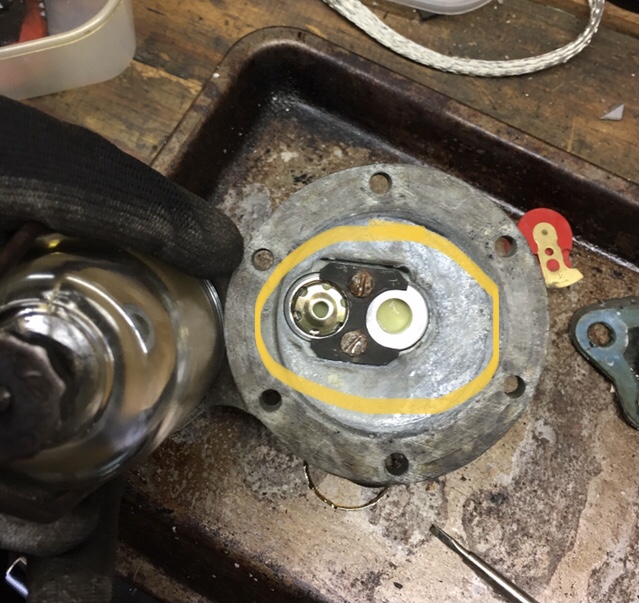

Perhaps the 2 valves are in the wrong way ? Circled yellow in the pic. Or the diaphragm is holed. This is what let me down before. I know you say it’s a new one but I’m afraid that is no endorsement.

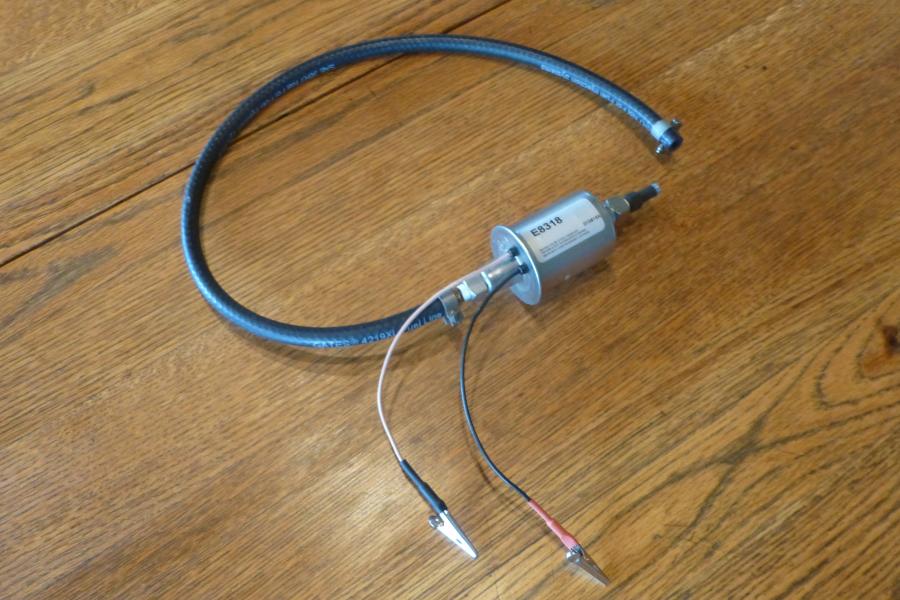

I always carry a cheap electric pump fitted with 5/16" (in) and 1/4" (out) lines for a quick get-me-home repair -- but it can also be used to prime the system.

Bridges the metal line from the tank to the metal input to the front carb. Clips connect to ground and the coil (so it shuts off when the ignition is off.
I Googled E8318 fuel pump and found an Airtex E8318 electric pump. The website had a make & model choice to see if this pump worked on your engine. It said that it did not work on a 1959 Triumph TR3.
What brand is your pump pictured? This is a good idea.
