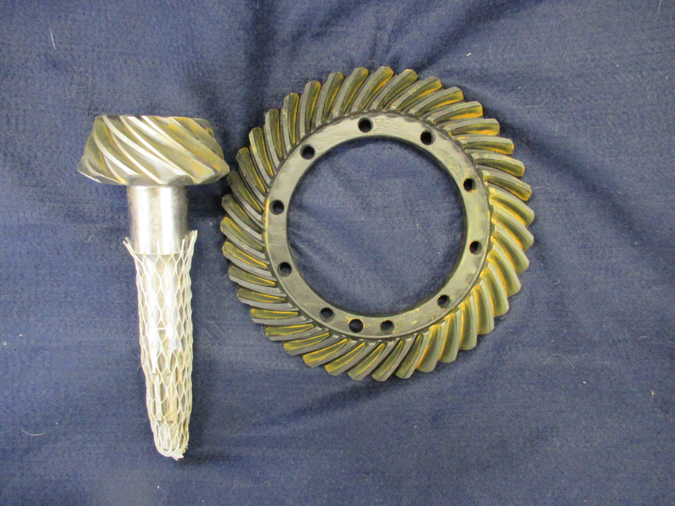

My mechanic and the differential rebuilding shop both thought the DWM 3.54 ring and pinion set were really nice quality pieces. I got them in 7 days.... UK to Colorado. They apologized it missed the intended plane or it would have been 6 days! I seldom get stuff from CA in 6 days!
