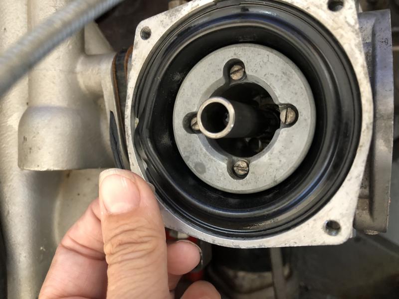

Because of the mentioning of a possible diaphragm issue, I decided to check both. This made sense, as I was sure that I, at least, had some power, which quickly was lost completely while running it with loose screws. The one by the radiator looked fine, but the one by the battery which had loose screws was out of alignment. I don’t know if that was like that before messing with it though, as I may have accidentally spun it myself while removing the inner piston screws, not the nameless other person.
Aligning the diaphragms, screwing down everything, and balancing I now have power, though not optimum. In neutral, pedal to the floor, I can only get about 2200 RPMs out of it, but at least it does something finally. This is, of course, after I tighten up the jet several quarter turns on both. I noticed the carb by the battery had its jet lightly covered in gas after this. Should I have screwed them down, not up?
The car also still surges when I get in it. I feel that if I can figure out why a suddenly weight change can cause that, I may have my answer.

Well I decided to take a look at it again, thinking that the only thing I haven’t tried was screwing the jet down the other way. (I said that I had screwed it up, but today noticed that causes the needle to get lower) When I began to attempt this, I noticed that the piston was stuck. It could go up, but wouldn’t fall down all the way. This is the battery side carb that had loose screws, and such. So I unscrewed the top and the piston falls back down. I then noticed a piece missing from the diaphragm. I don’t believe it was like that or even damaged slightly when I first took a look at it. I guess I’m stuck until I can get a new one.
Update:
Where do I go about getting a new diaphragm for a 150 CD zenith Stromberg carb? Like the floats, all I can find are for the Mk2 and 3s
trrdster2000
The 150 diaphragms will work from any of the carbs. All have the tabs that fit in the slots.

UmmYeah, I only recently saw that there is supposed to be a difference between the early 150CD diaphragms and those used in the later carbs. Like Wayne says, the later diaphragms will fit the early carbs. Just get diaphragms for 150CD carbs from a good source. You may pay more but give Joe Curto a call and he can supply what you need and the parts will be high quality. I assume Joe can also provide the three o-rings needed during the carb rebuild. From the picture I assume this is yet another place the local shop cut corners or didn't know what needed to be done. Some of the steps below wouldn't normally be necessary since your carbs were just serviced but I have questions about what that local shop may or may not have done.
I didn't really want to go on and on about the tuning of the 150CD carbs but it may be necessary. The problem you experienced with the sticking carb will have to be addressed when you get the replacement diaphragms.

Remove the 4 screws that hold the suction chamber (top of carb) onto the body.
Remove the suction chamber, the spring, and the air piston with the diaphragm.
Look at the needle. Is its shoulder flush with the underside of the piston? If not, loosen the screw on the side of the piston's bottom and adjust the needle until its shoulder is flush then retighten the screw. (A small steel ruler can be helpful to make sure the needle shoulder is flush with the bottom of the piston).
At the other end of the piston, remove the four Fillister head screws that secure the collar holding the diaphragm in place.
Remove the collar and the diaphragm.
Clean the carb body, air piston, and suction chamber if they are not already clean.
Look at the picture linked below, then look at your carbs' diaphragm and the top of the piston.
http://images.lotuselan.net/lel/55381/1/diaphragm.jpg
NOTE THE TABS on the diaphragm. You will find mating recessed slots on both the carb body and the top of the air piston.
Put a diaphragm on the air piston so the tab goes into the slot on the piston.
Refit the collar and four Fillister head screws and tighten the screws.
Place the piston back in the carb body making sure to align the diaphragm's remaining tab with the corresponding recessed slot at the top of the carb body.
