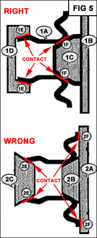

I've fought with tire guys too. Unless the balancer is locating on the inside taper of the inboard side of the hub and the outside taper of on the outboard side of the hub, your wasting your time and money.
All the shops I went to slapped the wheel on there machine, stuck a cone on the balancer shaft, and clamped it tight. This method will be locating your wheel on front and rear surfaces that are not machined and true. See the points 2E and 2F on the image above.

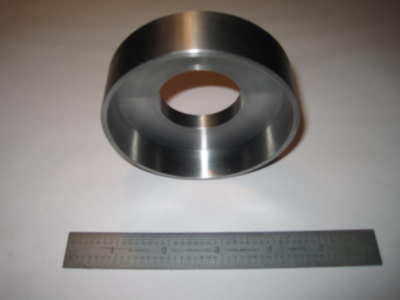

One correct way would be to use a stock tapered adapter on the inboard side at point 1F. For the outboard locator, I machined an adapter that located on the outboard taper of the wheel.
This worked for me. A better way is to actually bore the inside of a spare hub out to the diameter of the balancer spindle, and do likewise to a spare knock-off nut. I later did just that.

I went to a tire shop that's been around for a long time and discussed the above diagram with the owner. He sent his tire balance guy to the warehouse where he found the correct cones to fit a wire wheel and they also turned the tires on the wheel to get the best balance. Very pleased with the result and the worst of the lot required less than 1/2 oz on the inside rim. Old guys rule!
