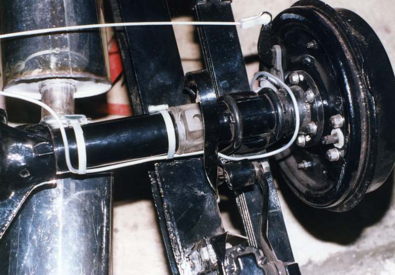

I believe it was simple mild steel wire, twisted like safety wire to fasten it in place. Sorry, no photos. Didn't even own a Polaroid the first time I changed those bumpers, let alone a digital camera.
You can see how I replaced mine during my restoration in 1987 - 1990. These rubber bumpers came from UK and were slit with one slit horizontally. I strapped them to the axle with stainless steel wire which is still there today.
