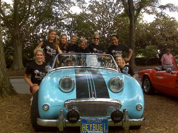

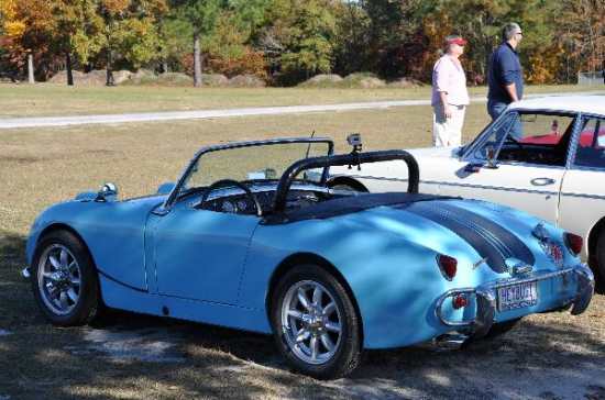

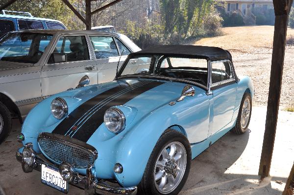

Just to throw a monkey wrench in the gears here.
I'm running 185x55 on 15x5.5s.
They must wind up close to original height since the speedo
is darn near spot on according to my GPS.
Yeah, I know...weirdo tire combo on a weirdo modified BE.
Hey, it fits my style...
:driving: :jester:

Are those Calif plates or do the ones from SC just look the same?
BillM
That is an old photo with Cali plates.
I currently run an old blue/yellow front
Cali plate that came with the car. "Heybugi"
I ordered a custom plate for SC that says the same for the rear. "Heybugi".
