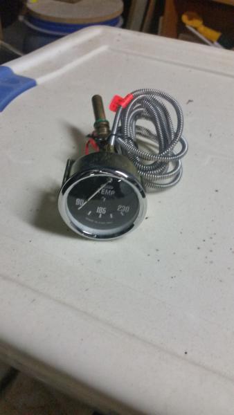

I have just bought a Temperature gauge clone on Ebay. It looks very good. It appears to be new with the correct domed glass and the face looks correct.
The seller says he builds them as a hobby and can do Fahrenheit or Celsius.
I am replacing an incorrect flat faced gauge in my panel.
He has another on Ebay now. Seller Streetrunnaz

Don't know if he does repairs. May be able to contact him through his Ebay name.
Is the capillary tube broken on them? I have seen an article on how to splice a new tube on to an old gauge.
