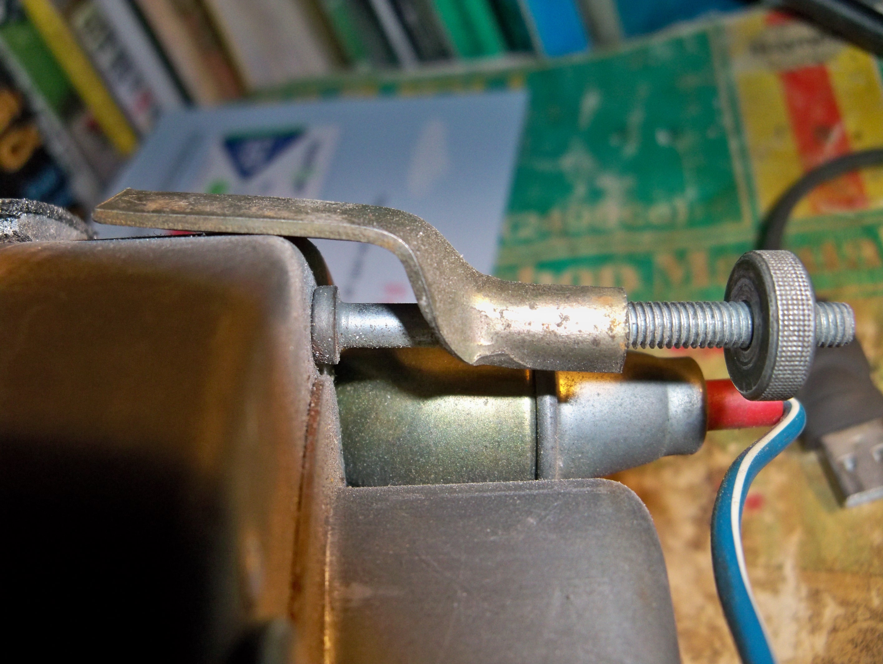

poolboy
Agreeing with CJD:
Those 2 shovel clamps holding the big gauges also provide a ground to the metal dash behind the wooden...make sure the ground eyelet is under one of the thumb screws for the shovel clamp

Bottom line - it was a bad ground. I ran a new ground cable from one of the posts behind the shovel clamp, secured between 2 nuts. I wound up pulling the tach out to make sure all the connections were good and the lights worked.
