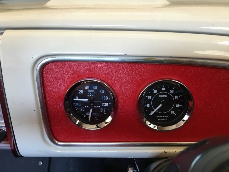

Proof I suppose that I'm a car nerd for sure. I've been looking for a tach for my Morris Minor as it doesn't have one from the factory. Wanted something to match the oil/water gauge I added -- standard Smiths 52mm size. Settled on something modern that fit, but wasn't happy. Then last weekend I was searching again for options and ran across what I think may be a new product, a 52mm tach from Smiths! So of course I had to get one. Simple enough to swap, and looks just right (and works great).
It's probably slightly pathetic how happy this made me today.

I have seen one or two small Smiths tachs but I don't remember a 52mm one that looks like yours. It probably is a relatively new offering.
I think your tach looks great. May I ask where you bought it?

BTW, excuse my rudeness. Forgot to say how good your new tach looks. :cheers:

I got the tach from Mini Spares in the UK:
https://www.minispares.com/product/...search/classic/tachometer.aspx|Back to search
Minimania lists it as well, but when I called they were out of stock. Got it in about 3 days from Mini Spares.
Definitely a new product. The Mini Spares images show that the gauge is made by Caerbont who is the current copyright holder for gauges marked "Smiths". They have introduced a number of nice instruments over the past couple of years. They have been very good at keeping the classic look while using modern electronics.
I am surprised MM have a somewhat comparable price to MS for the tach. At today's exchange rate, MS charges $195 while MM charges $230. That's still a big enough price difference to justify shipping charges from the U.K. My experience is that I get parts from MS in about half the time it takes to get them from MM... and I usually save money.
Regardless, I like the look of that tach. Thanks for sharing the pictures and information.

Looks great Drew! What was there before?

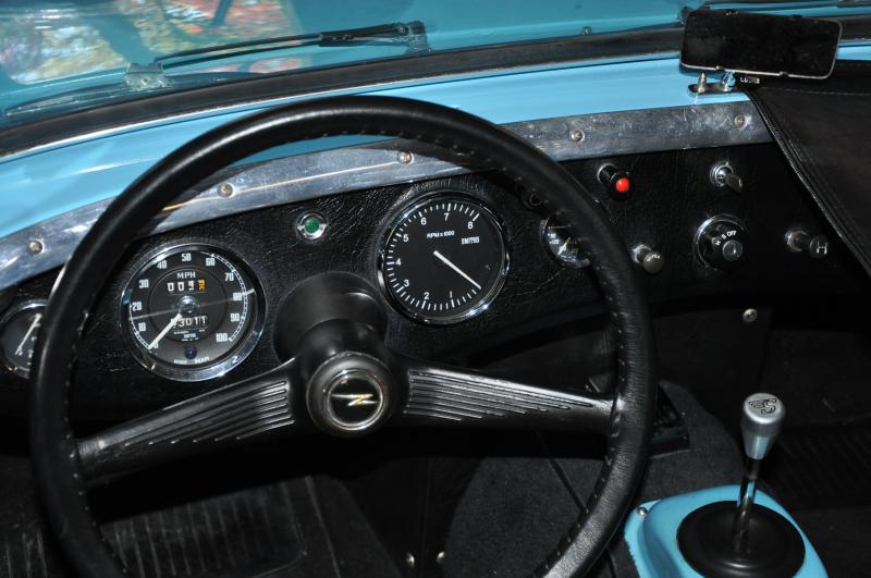

This is the one I had made for my Sprite. It is nice to just see the needle around 12:00 and know it is near time to shift.
I opted for no redline pointer....that point sorta depends on what is going on at the moment.
:cool-new:

Dang! That is SWEET!
I'm so excited that I found it. *Almost* looks like it could be a factory option -- that was my goal, to have the Morris look like a hypothetical "S" or "GT" version if such a thing had been offered at the time.
That tach in your Bugeye looks great, matches the later speedo nicely.

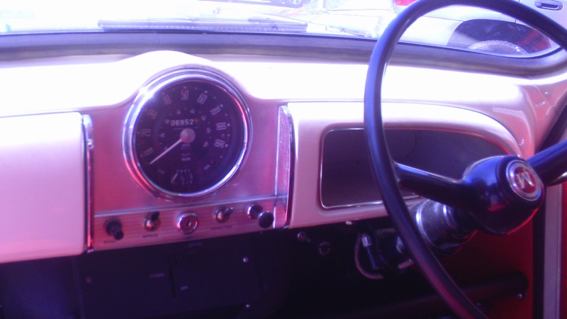

It was just an open glove box. I found some red vinyl at a fabric store and it was a surprisingly good match for the interior. After the vinyl ages a little it will look like it was always there. I made a little panel to fit in the trim opening and used a hole saw to make the openings for the gauges. Trying to keep things looking as stock as possible.
This is the best pic I have of the "before" dash.
