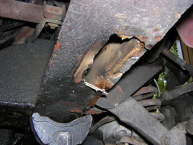

I've torn both sides out on mine. Had to weld in steel plates to beef things up. I'm running a non-standard 3/4" bar that has shorter arms (so it's probably like a "normal" 7/8" bar).
Photo courtesy of Safety Fast.

yep. you made a mess Lee.
Not mine Jack. Just a picture of a example of what could happen. Thinking about modding mine before something like this could happen. Preemptive strike so to speak. Been running a anti sway bar since the '70's and would not be surprised to find cracking there now.

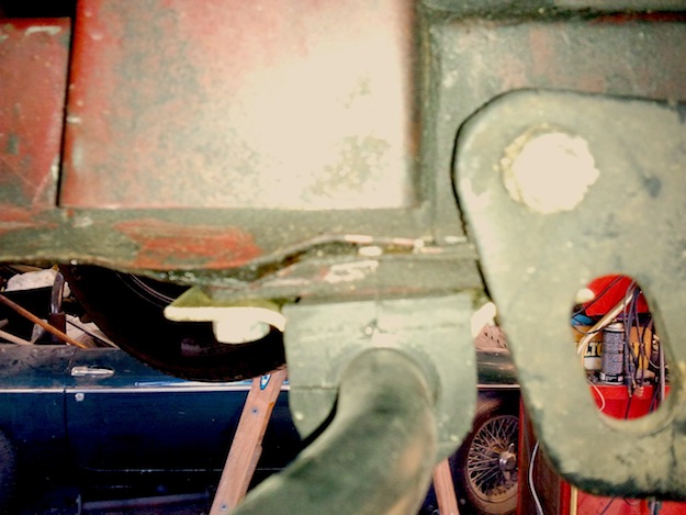

Here's a picture of the outside edge of the passenger side chassis leg on my 1979 Midget. Addco 3/4" bar #131, less than 3000 miles use!
