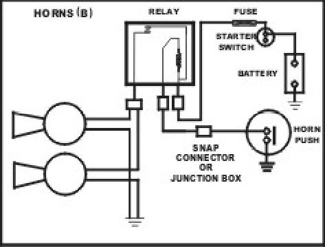

Yes, you definitely need a relay. The wiring diagram in the shop manual shows how to wire them, and it shows the relay as well. This diagram can be found in the Haynes manual too. The horns themselves are simply wired in parallel; the relay switches them in the usual fashion.
I'm away from my office now, but if you need more info let me know and I'll scan the wiring diagram. Every Sprite owner should have a copy...!

I don't doubt it will work for a while, but I suspect you will fry the contacts in the horn button or steering brush eventually. Those little suckers pull a lot of current (stock ones are ~12A peak, ~6A average, EACH), and the fact that they are an inductive load will cause quite a bit more sparking at the contacts than normal. I'd really recommend putting in a relay--cheap and simple.

As stock, the full amperage goes through the switch, which eventually causes it to fail. It'll fail even faster, with double the current.
So, as with uprated headlights, electric fans, electric fuel pumps and anything else that pulls a lot of power, a relay can be used to minimize the current carried by the horn switch contacts, and to reduce voltage drop.
Not totally necessary... just a little extra protection.

Thannks for the good info, I think I will not risk damaging the horn switch and install the relay. My shop manual does show a relay for the twin horn option, but wasn't real clear about the wiring. Your diagram provides the info I needed.
