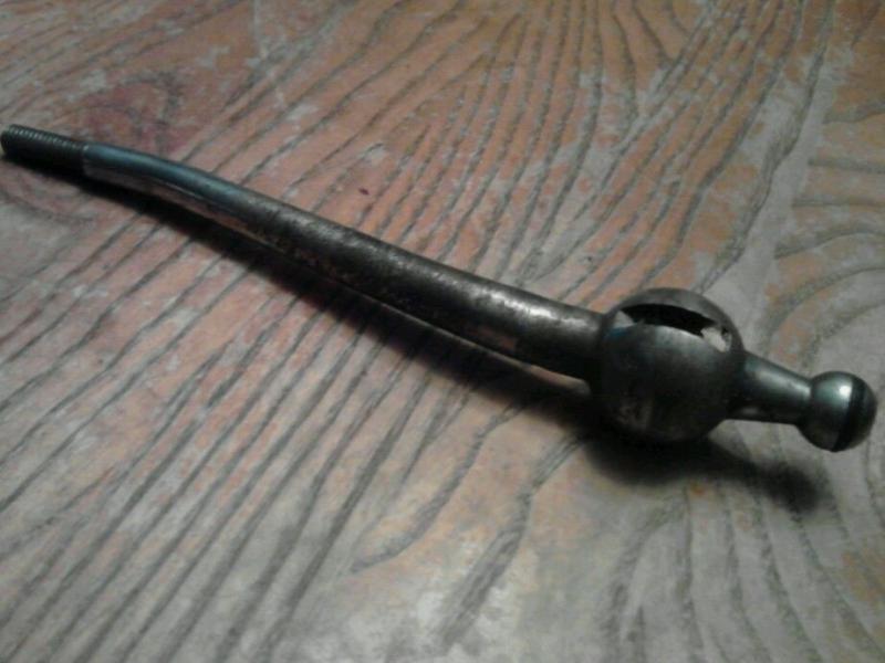

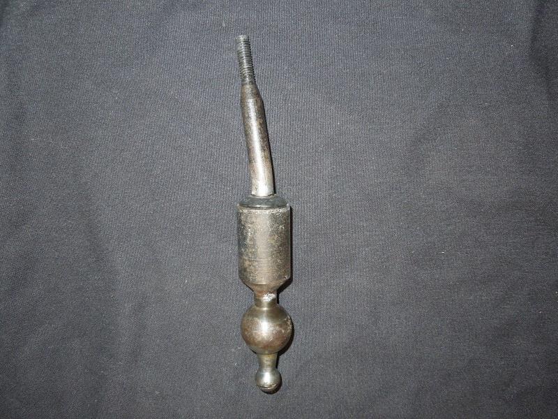

Will this 1275 shift lever fit in my Bugeye with a rib-cage trans
Rut
Paul,
That shift lever is from a later Midget and will work fine, but it will have the anti vibration cylinder in it.

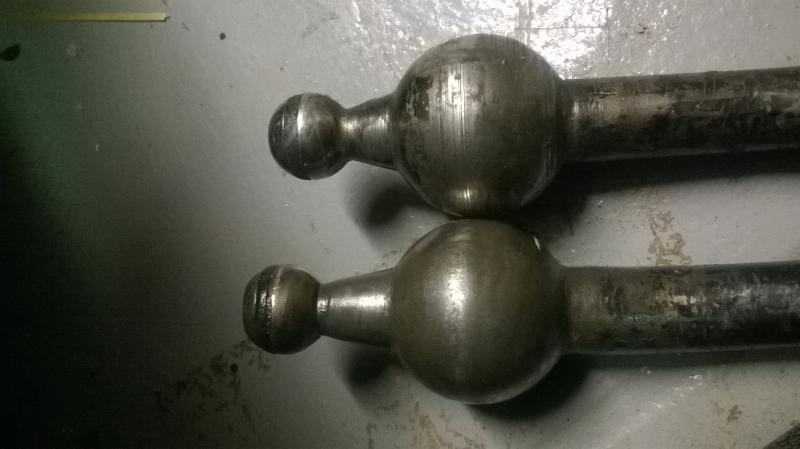

Here is a side-by-side for you. The short one is the smooth case.

Great photo! Thanks. It looks as if the one I posted is a smooth case, yet he says it came out of a 1964 Midget.
Paul
Gerard
Looks like the longer version to me. What does it measure from the bottom of the ball to the end? I'll compare to one of mine.
