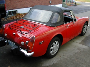

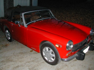

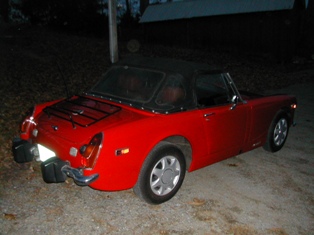

An opportunity for me to aquire a decent "driver" 1974 Midget RWA presented itself recently... tonight I inked the deal, she will be in my garage tomorrow night !
She runs strong, good oil pressure, tight suspension (the rearched leafs in the back are a little high I think), has a bad u-joint & needs lots of TLC - for example, turn signal lenses are showing cracks, lens gaskets look like a hen has pecked them, top is worn, bumpers need to be eventually replaced, rubber overiders need to be removed, dashpad is cracked... Rostyle rims are hiding under those ugly hubcaps, factory jack & lug wrench in the trunk & factory hardtop included...
Driver's are fun, you can drive & improve all at the same time !
What do you think ? More pics to follow, but these are the only ones I could get in the limited light this evening.

Nicely done. Besides, they're small enough that you can fit a whole bunch of them in a standard garage.
JPSmit
Looks great! and, remember Jer is one of this Garage Mahal guys that drives the rest of us nuts.
Was it local?
Jer
Jer
See I knew that I would find support here :smile: ha ha
Drew - Actually I was just out putting my 67 on dolly's to roll her across the back of the garage, so there will be room for the 74 tomorrow night!
JP - As soon as I get the plates/insurance on the 74 (Bridget), she will be driven to the Garage-Mahal (my mothers home) for a winter re-hab session, then she will be ready to join the 67 (Midge) at car shows next spring, think I will keep one at my home & one at mothers (where I go almost every weekend) then they both will get exercise ! Yes it was a local car, apparently it was a local car originally, then was bought & moved about 4 hours away, then current owners (now previous owners I guess) bought it & brought it back to home turf, looks like it was originally "Bronze Yellow" before being painted red (I already had my head under the dash/kick panels looking for original paint hints) - some typical repair has been done but pretty sound & straight (except for some paint damage where somebody learned the importance of door check straps when the new paint job had already been done - I have some pillar re-painting to be do)

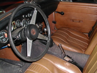

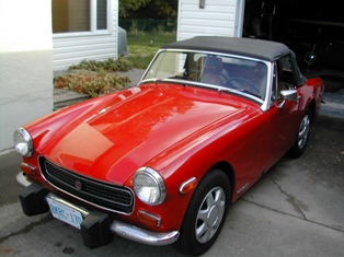

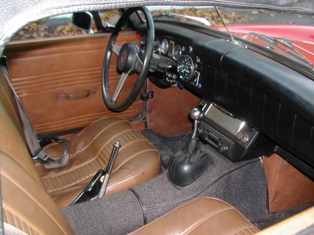

I got some daylight pics before she was put away in the garage to share.

sure doesn't seem to need much - gotta love those Sabrina's though
