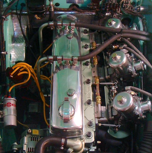

Dougie ....I cant help but notice you have two valve cover vent Ts on you car with two vent hoses , where do the hoses go and why twin T's ?
The motor on '57 100-6 MM vintage racer produces a lot of internal pressure, the twin breather outlets run from the crank case to the value cover and empty into a catch tank in the wheel well.

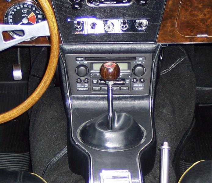

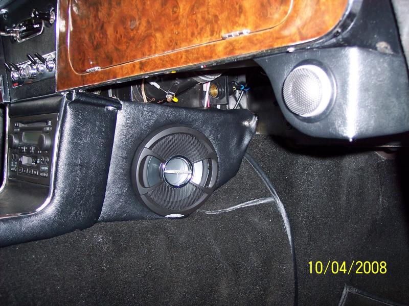

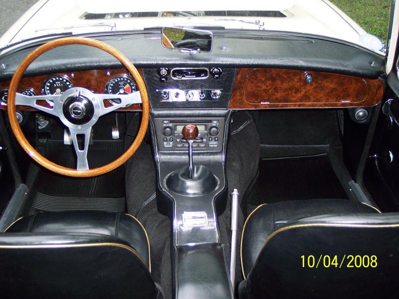

If you want decent sound from an inconspicuous time-consistent radio, then place 2 small speaker boxes above the heater duct and I expect you will be happy. If your radio supports more speakers, you can even add to the fronts by installing an additional 2 removable box/amplified speakers in back. Or, you can do what I did and install a replicated console (original on shelf) with the needed dimensional modifications to accept Bose head and equalizer, acoustically separated midrange speakers on each side of the console, tweeters at the ends of the dash and an amp supporting my subwoofer inside the spare in the trunk. Since most all was purchased from a salvage yard and came out of an Acura TL or on sale, the cost was reasonable and the sound perfect to listen to the Beach Boys when driving with the top down. But my approach is my approach and most all others have taken a different path and are as happy with their results.
