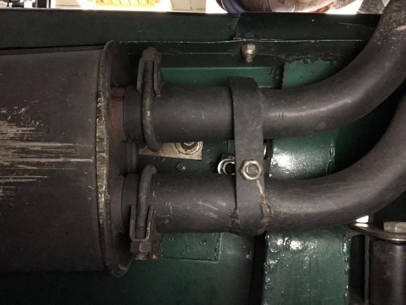

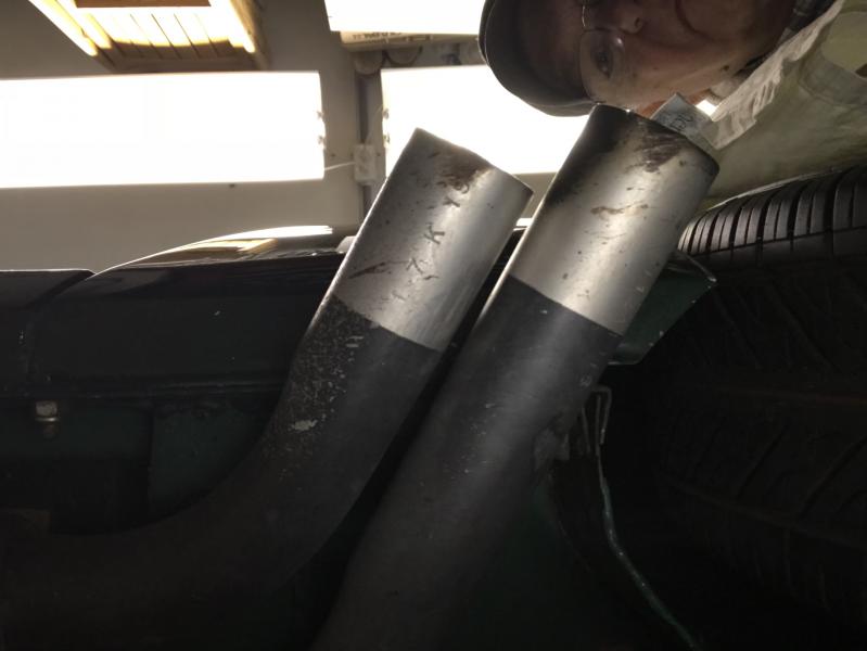

I just used a stock replacement muffler from Moss and had a local shop make a couple of 60deg bends in some exhaust pipe. When I got them home, I trimmed them to fit, made a hanger out of some bar stock and threaded rod to attach to the exhaust hanger on the rear outrigger, painted it all black except for the tips, which are silver.
