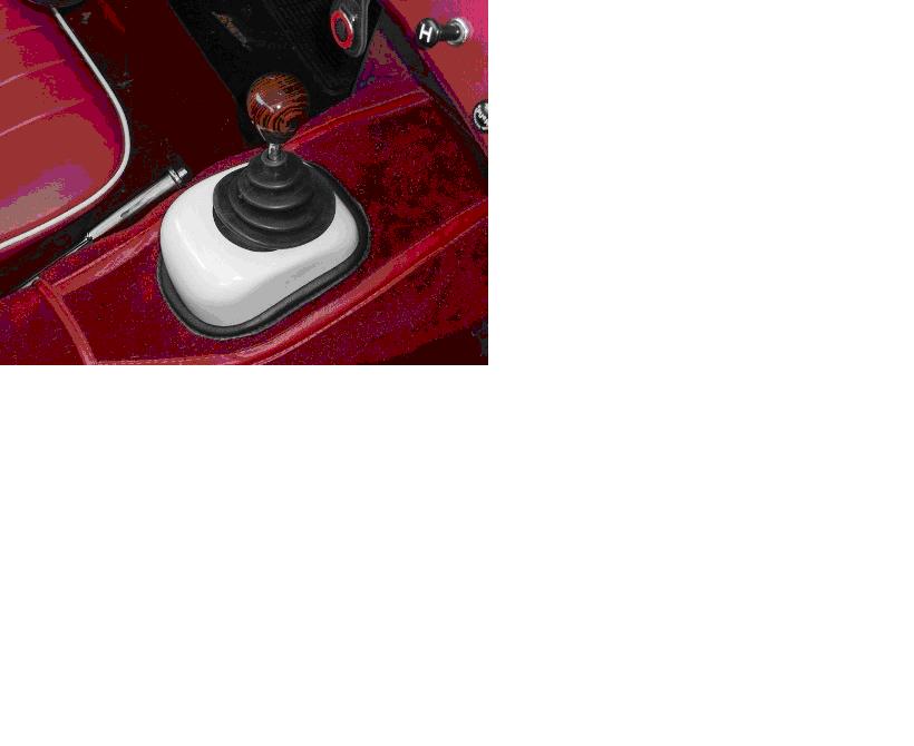

smaceng
this is the boot from a MGB, not sure of the year. I used it as the BE boot would not work with the Datsun 5 speed.

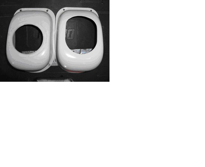

Take a look at the 68-80 all synchro MGB transmission as shown in the Moss cat. That is the boot that I used, but it also looks like it has a chrome ring or something to hold it down.
The photo shows the mod I had to make to the housing. since I can't weld yet (don't have a welder) I just opened up the opening toward the front. What needs to be done is to weld up the area toward the back, and then the MGB boot will great, and the stock BE boot may fit too.
