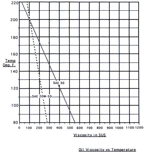

See attached graph --
A straight 30 oil should have a viscosity of about 480 SUS at 100 degrees F, & 62 SUS at 210 degrees F.
A SAE 20W-50 oil would have a viscosity of about 250 SUS at 100 degrees F, & 92 SUS at 210 degrees F.
The straight 30 oil might show a little more oil pressure when relatively cold, & less when hot, as compared to the 20-50. Surprisingly, the two oils don't reach equal viscosity until they are at around 200 degrees F.
It wouldn't be unusual for the oil temp to be at 210 or higher. In fact, it needs to get hot enough to boil off the water condensation/combustion by products.
D

That makes sense as I was almost shocked by seeing 60 lbs of oil pressure when the engine is not warmed up all the way. After it warms up to 180 or so, the max oil pressure is somewhere over 50 perhaps as much as 55 lbs. The chart would indicate that I should expect the same oil pressure reading after the engine warms up all the way when using the 20w-50.
