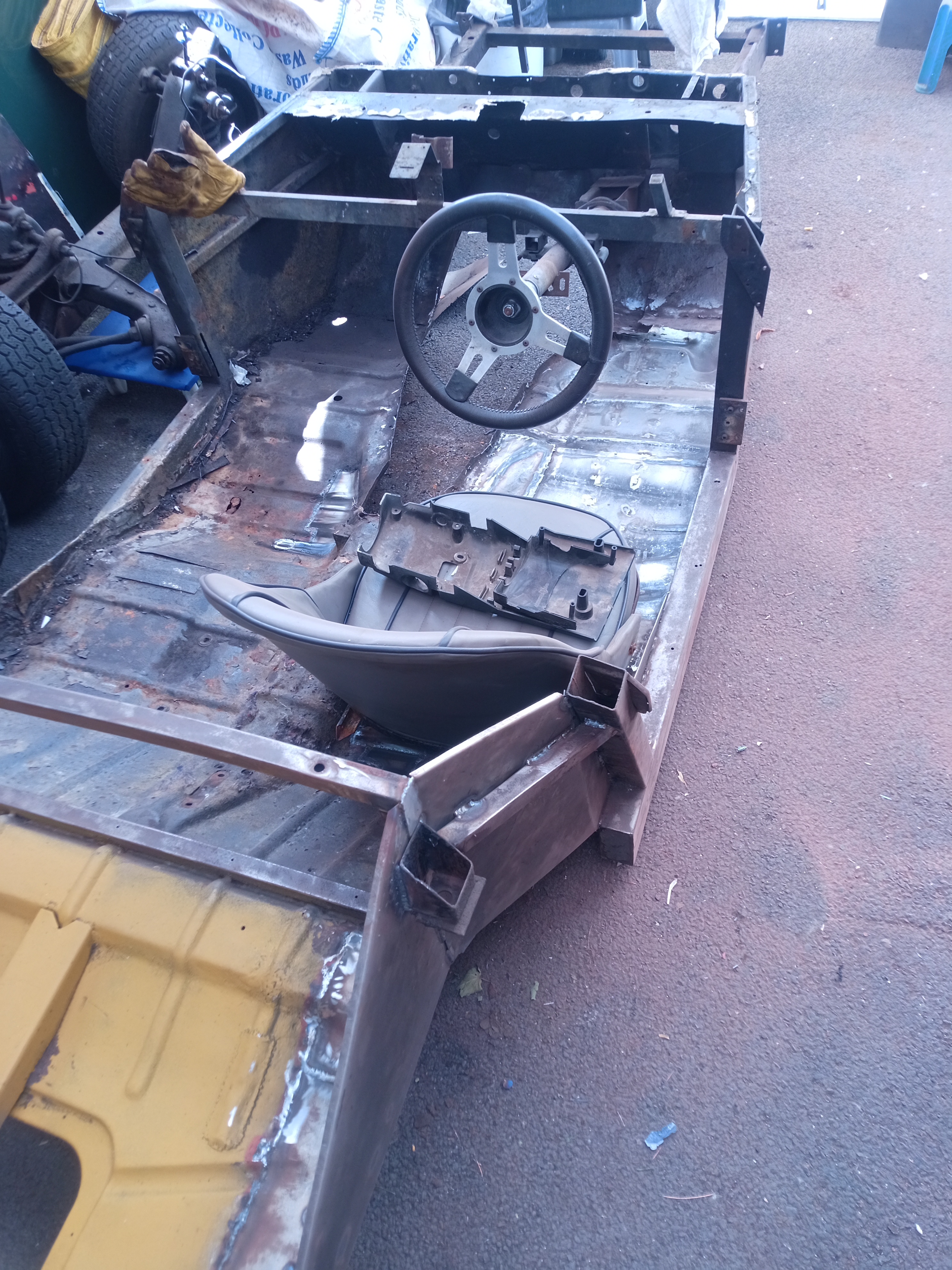

I will post the pictures as it was when i bought it, Her indoors thought i had finally lost the plot,

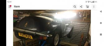

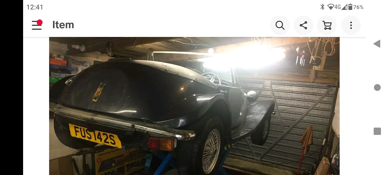

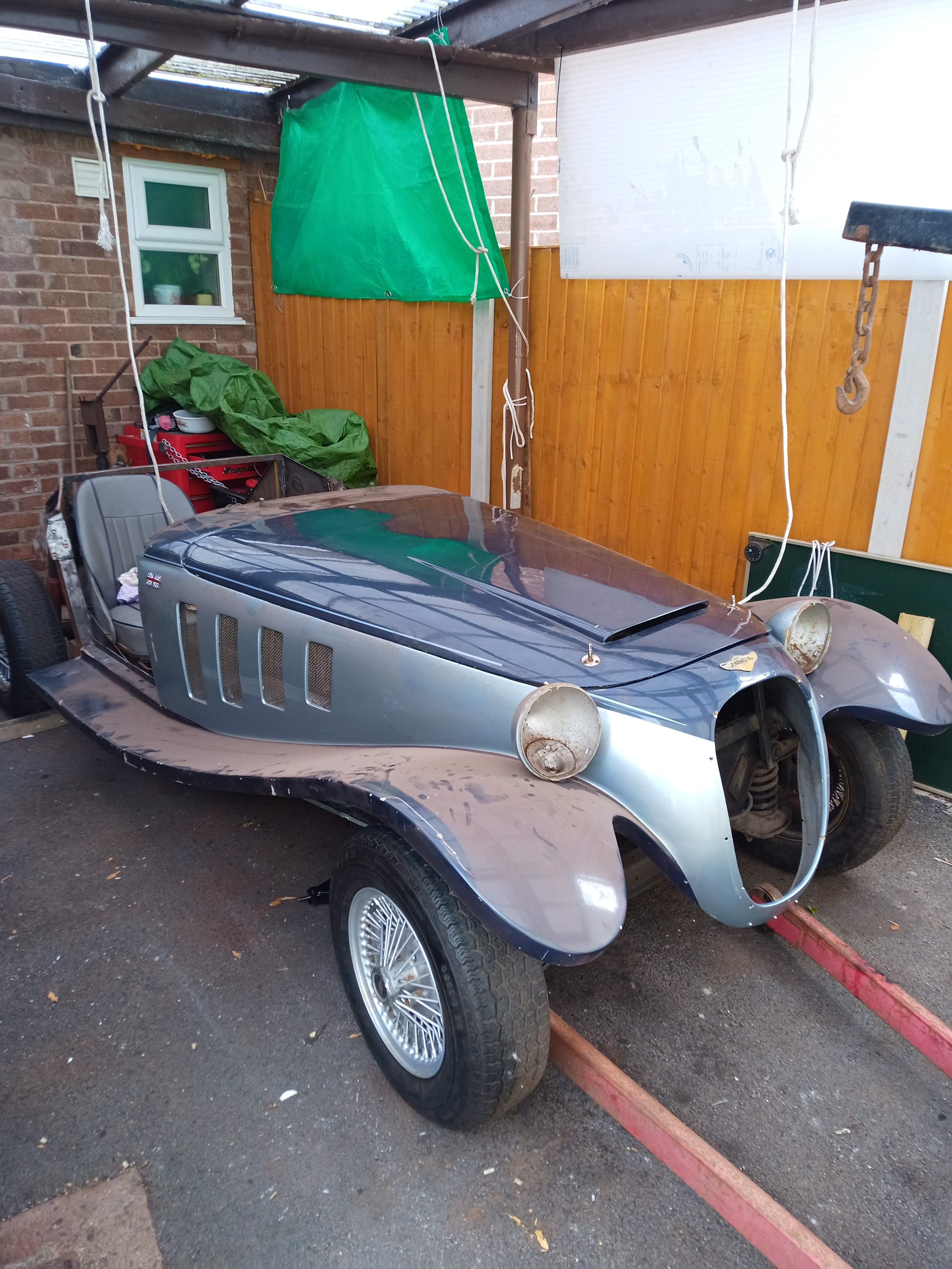

The guy i bought it from told me it was complete when he bought it the previous year and ran, it had been stood for ten years in a garage.
the first picture is how it was when he first got it, the rest are of how far he got in twelve months, He also admited he was no welder and was in way over his head.

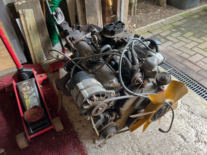

You will notice there is an Essex 3.0 ltr V6 engine which someone had shoehorned under the bonnet at some point. long gone was the 2.3 vauxhall slant engine that panther fitted.

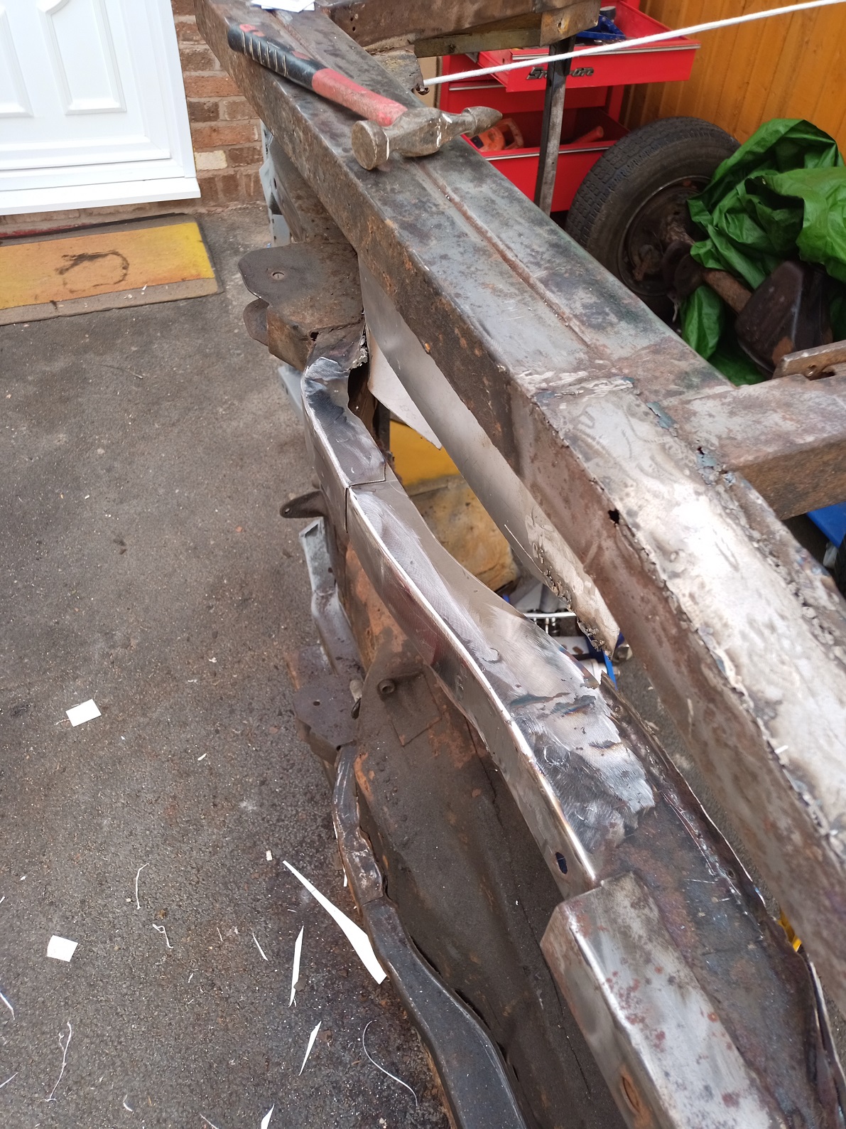

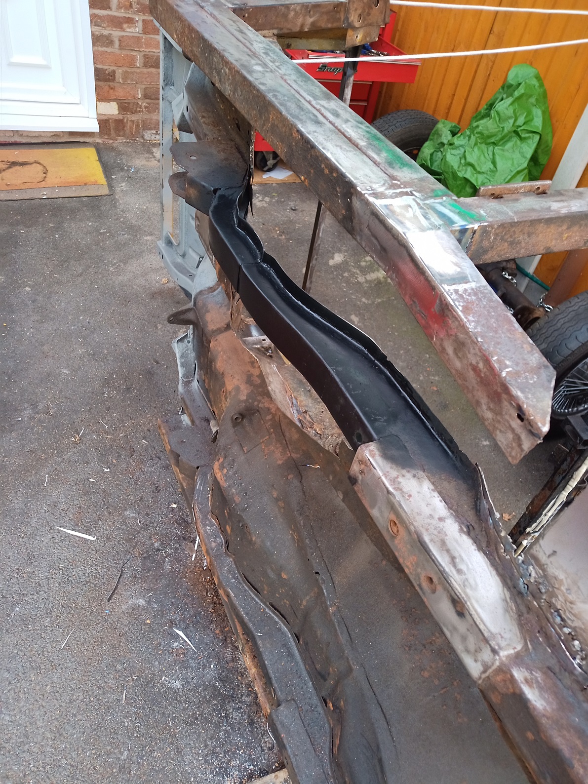

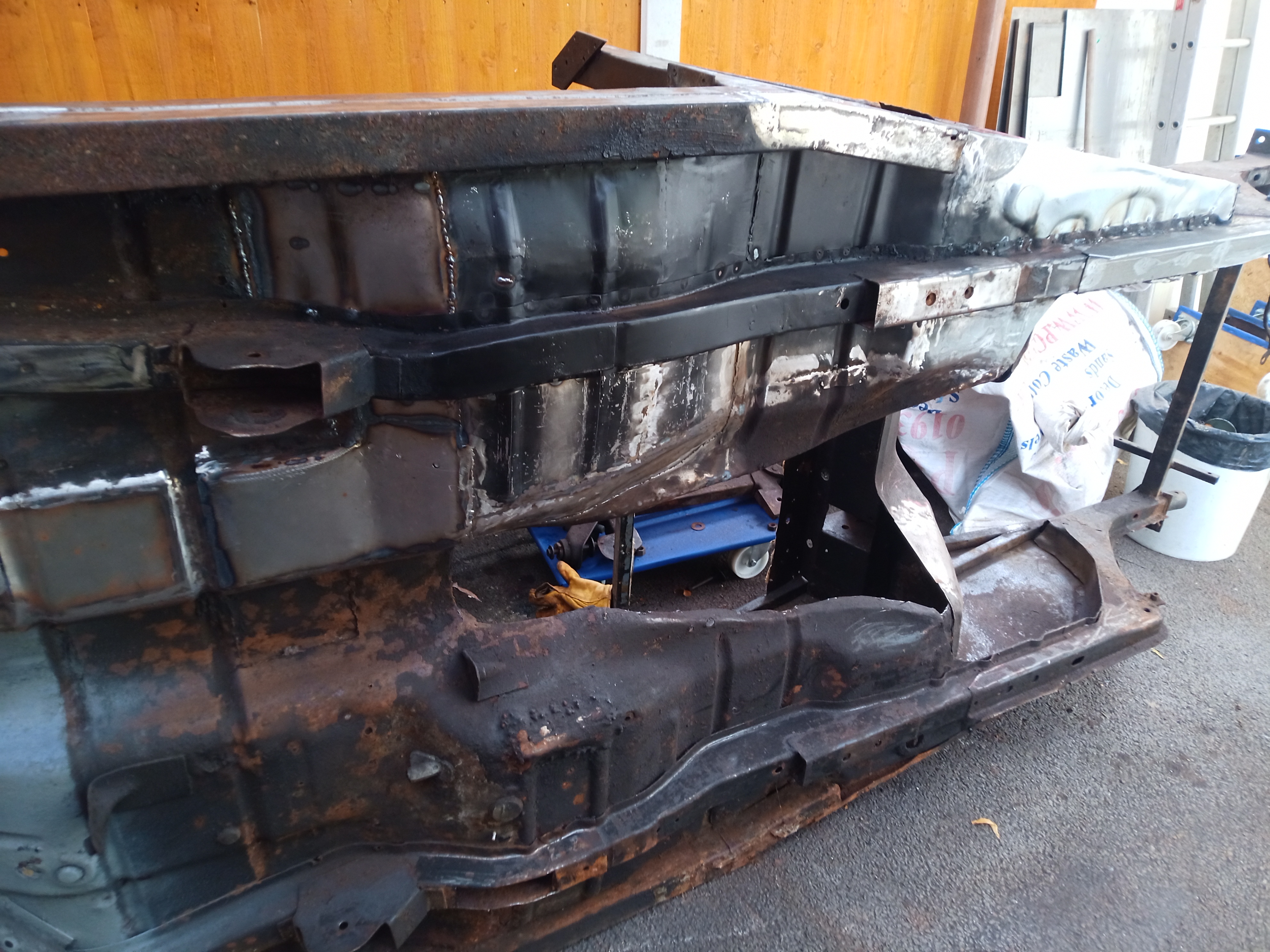

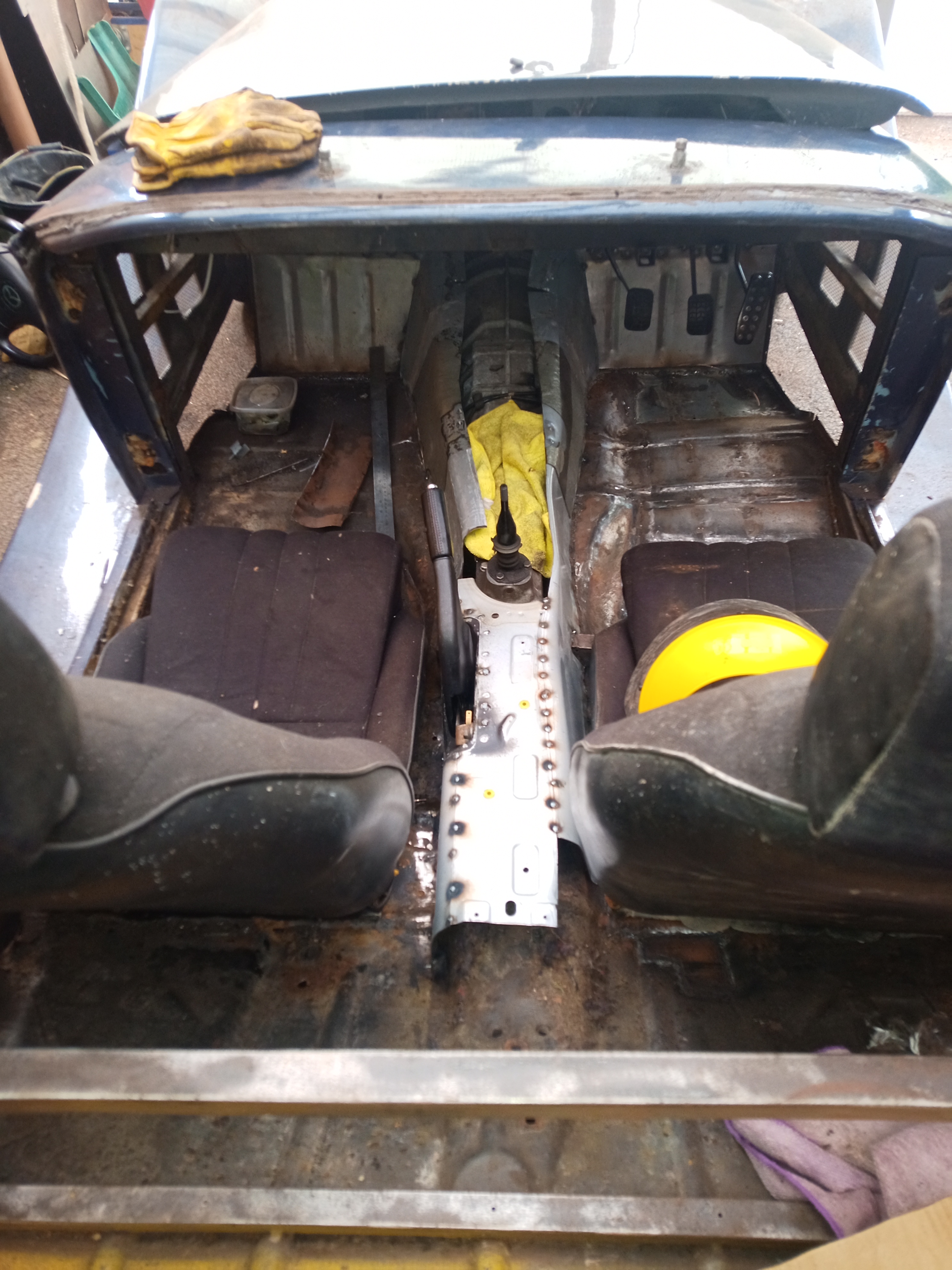

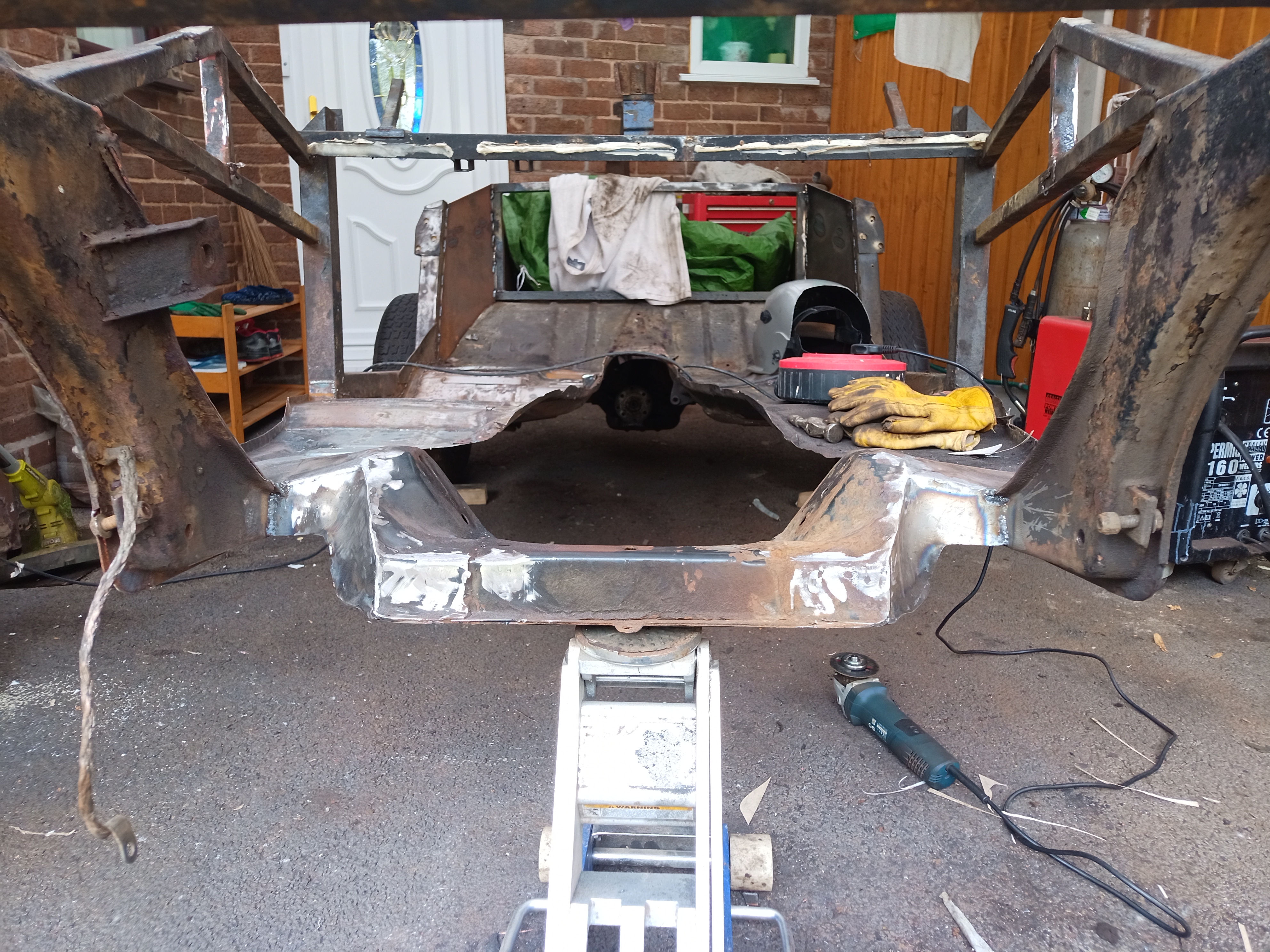

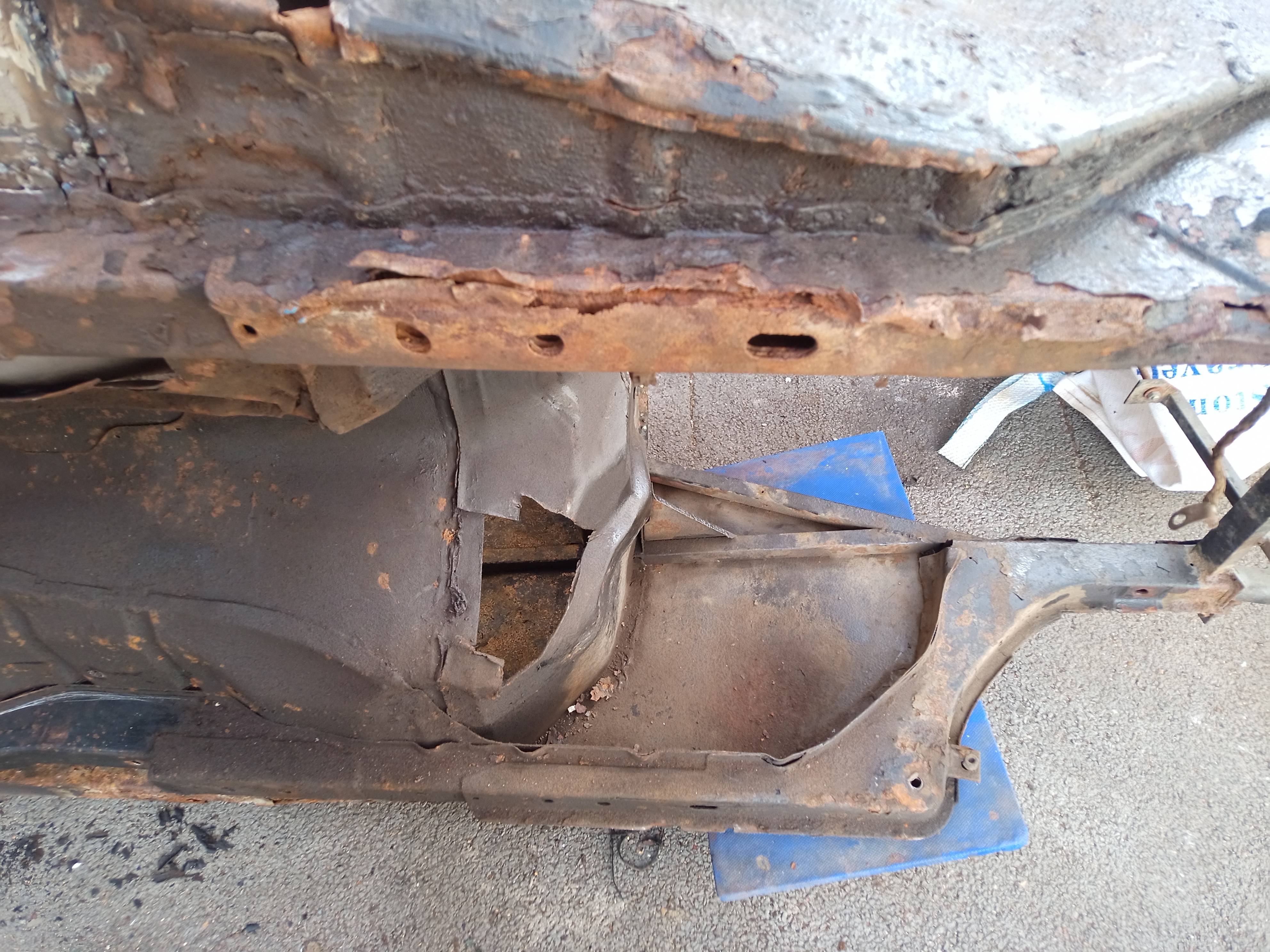

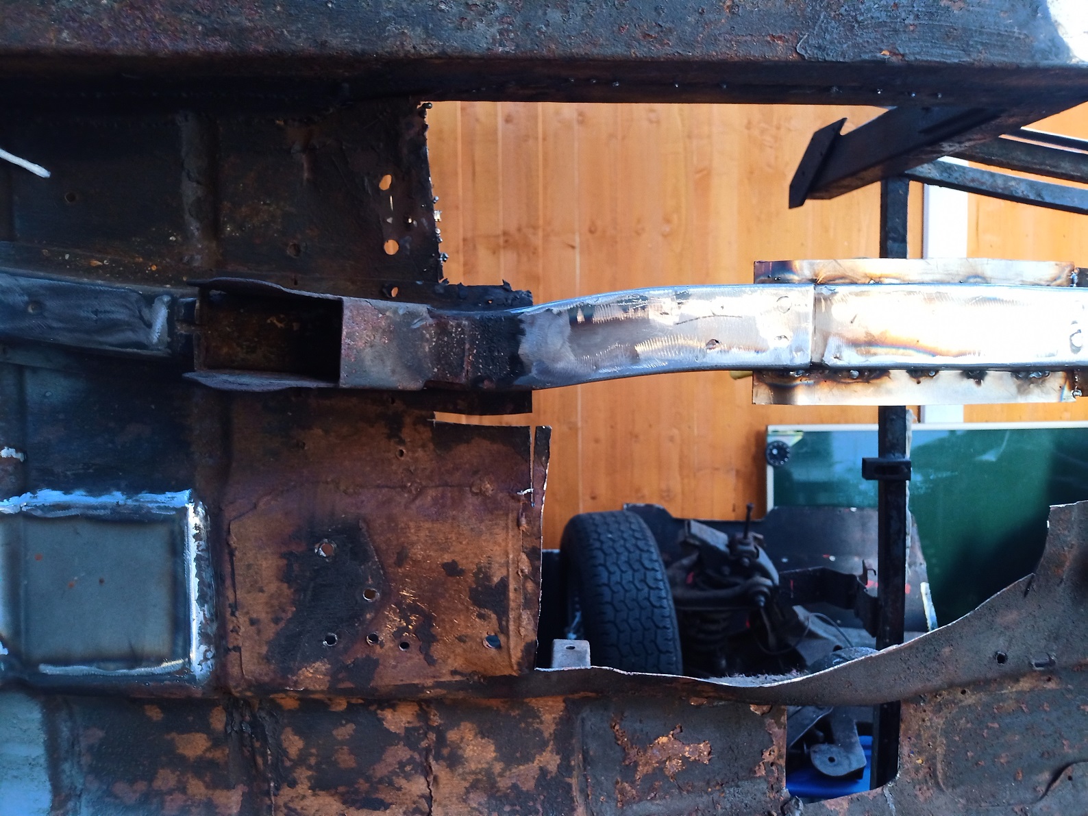

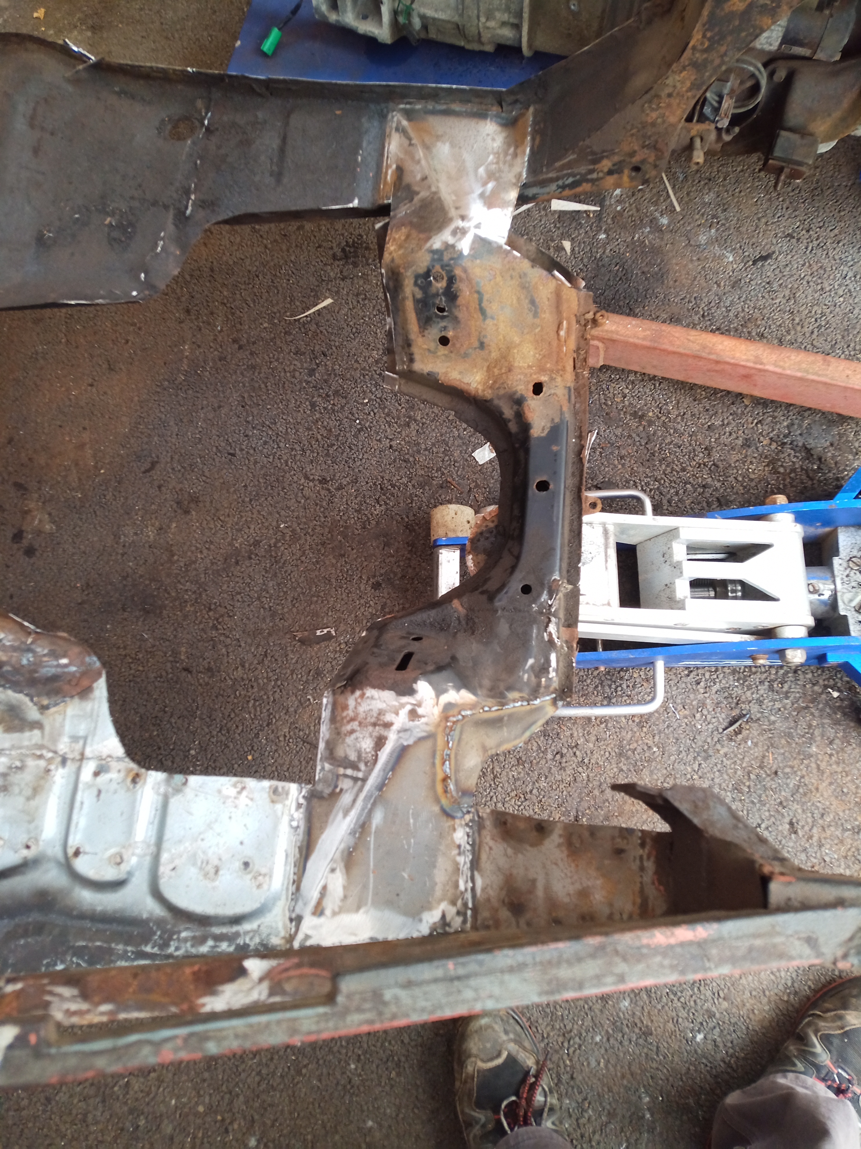

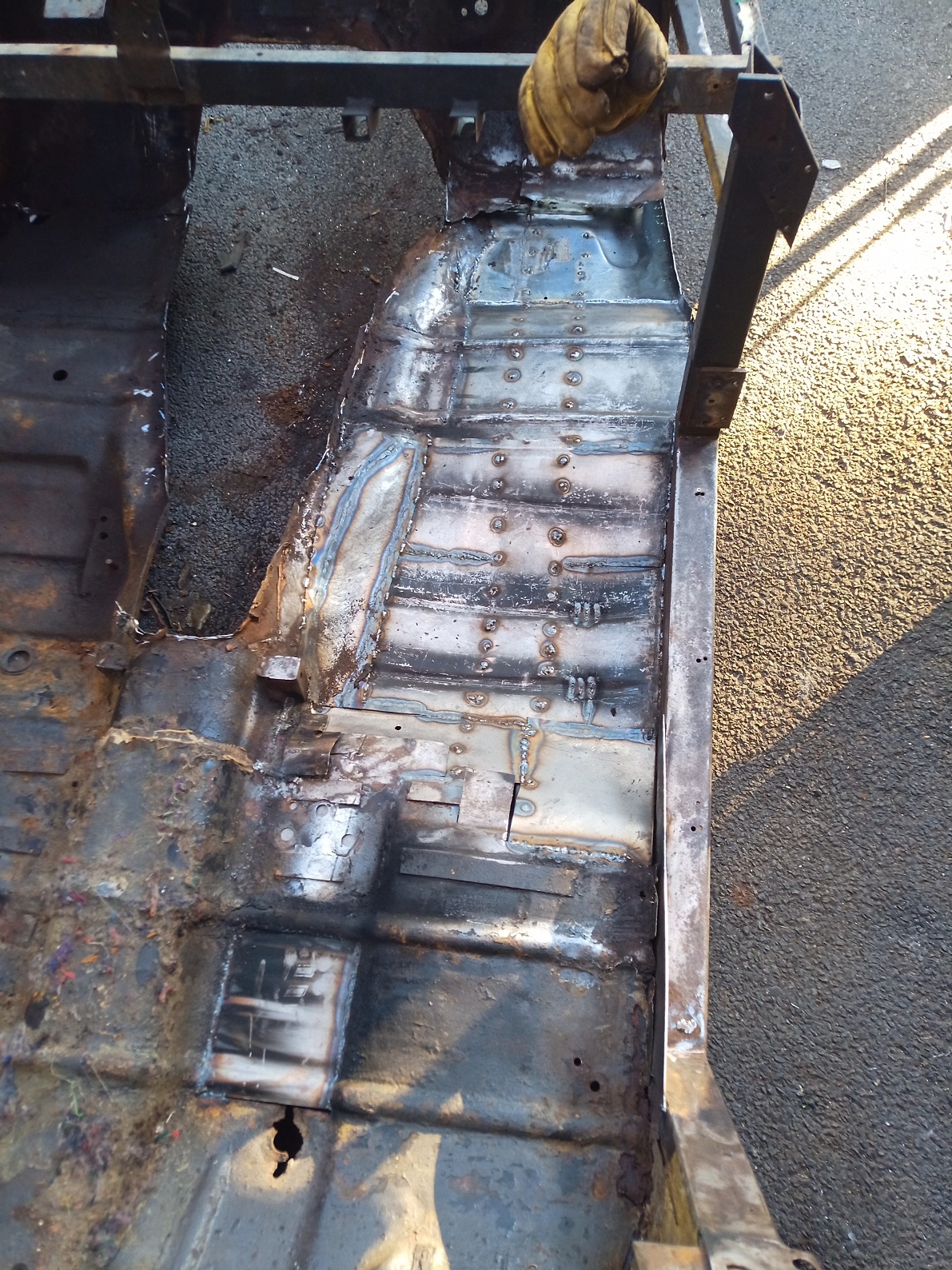

After i got the THING home, i decided to cut out what he had done and start over.
One good tap with a lump hammer and the floor he had tried to weld in fell out just leaving the piece of striaght box section where the chassis rail was meant to be.
That was the first job, "bulding a new chassis rail to support the floor, and re build the front chassis leg which nature had mostly reclaimed.
followed by a new floor, this all had to be hand made as no panel work is available at ant price.

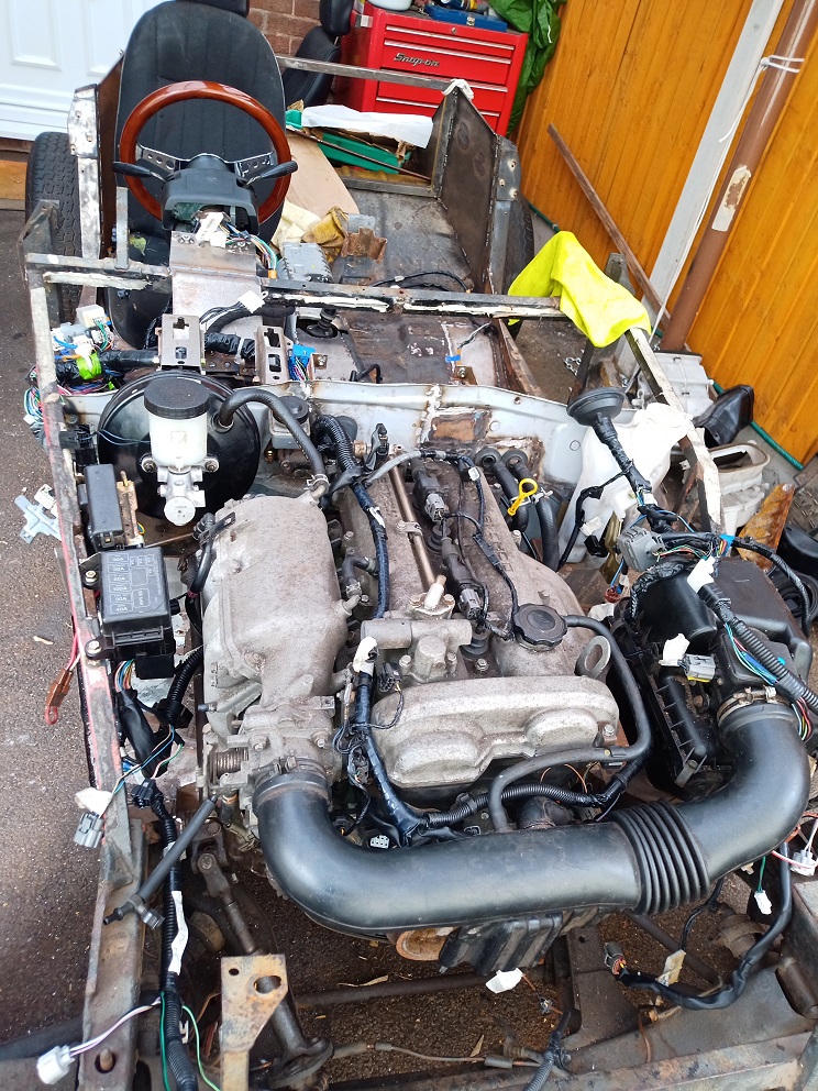

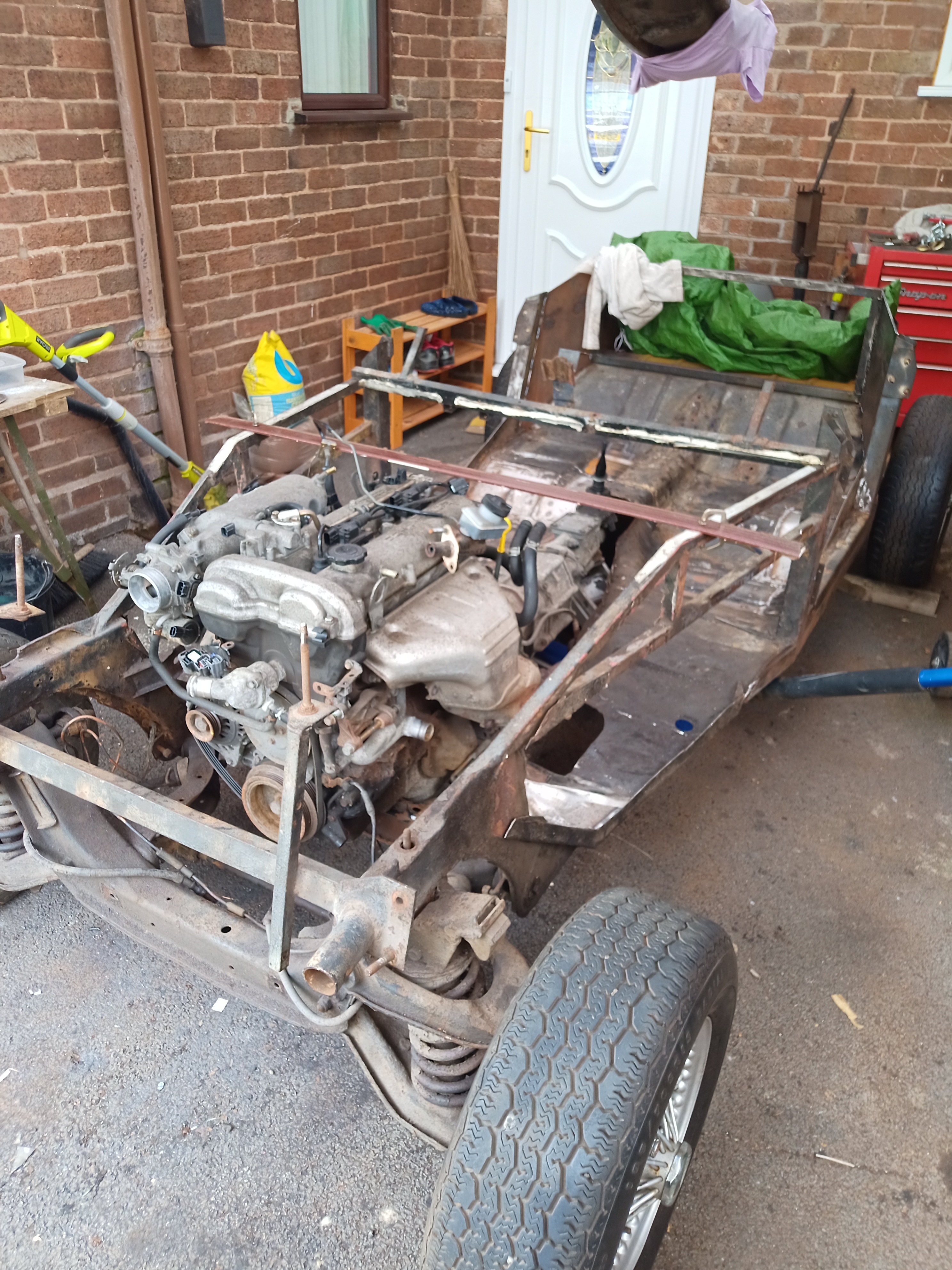

It wasnt long before i realised the essex V6 was totaly Not the right engine for this car, it was too big too heavy and the gearbox was only a four speed with too big a bell housing,
That engine was sold and i bought a complete MX5 1.8 vvt minus the interior.

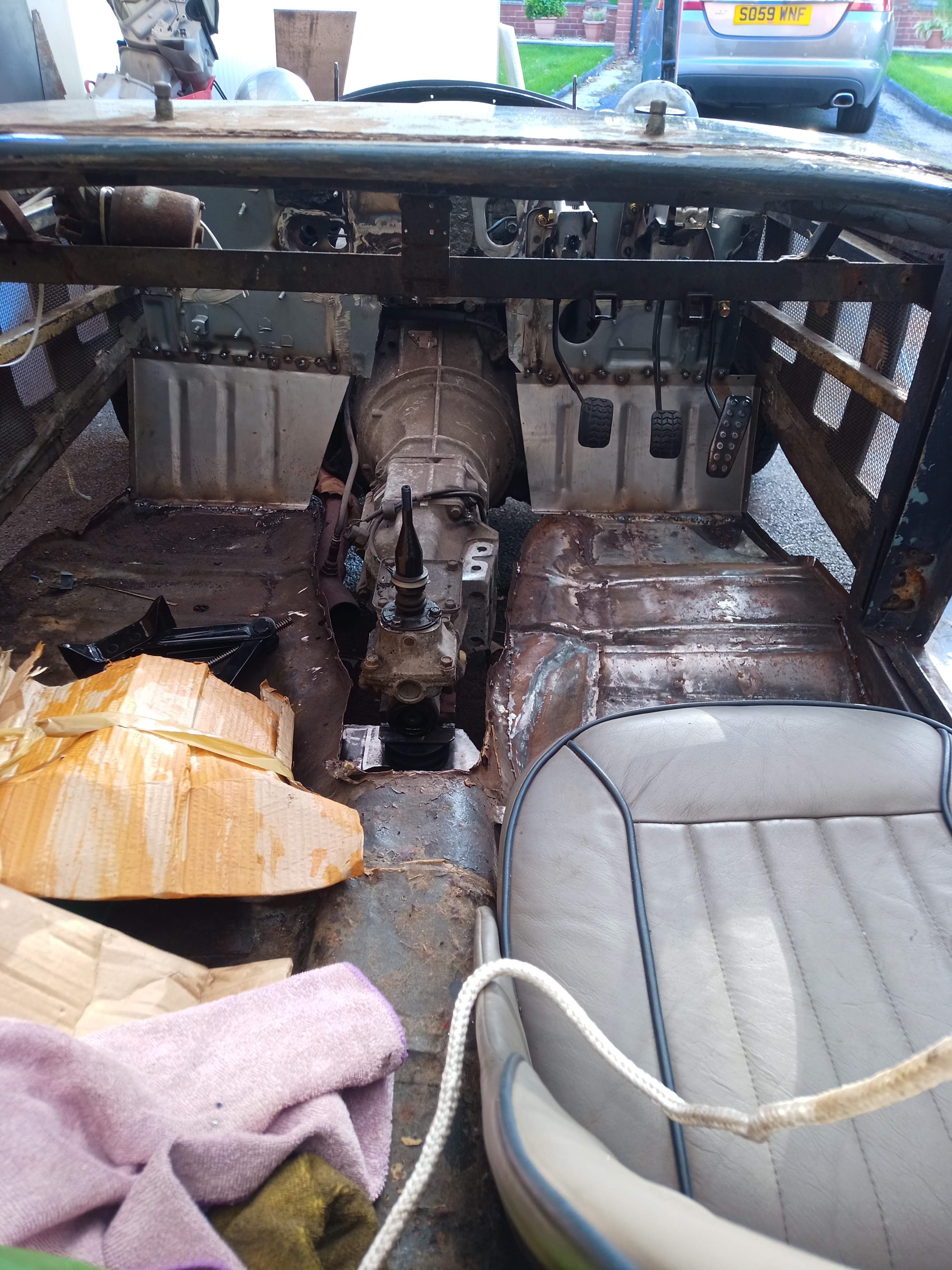

The transmision tunnel i had already removed due to the fact it had the origina vauxhall hole for the gearstic, Panther had plated over this and made there own, which again was plated over and another hole made fort he ford gearbox,
The pedal box was toast, was not worth the time to rebuild and modify for a hydraulic clutch, so out came the firewall, I had decided to cut and shut the one out of the mazda so i could use the mazda pedal boxes, servo and master cylinders.
As can be seen the original firewall was two parts with the pedal box on the rear most section, this allowed me to move the new firewall back 4 inches, giving me more room under the bonnet.
I cut out the centre horseshoe part of the mazda subframe and welded it between the front chassis rails, this has the engine mounts on for the engine. THis will stiffen the front end up graetly, and with the engine mounted 4 inches further back behind the front wheels should distribute the weight better.
Engine and box first trial fit, C of G should be a lot better than the orginal.
Dropped the body back on so i can work out where all the clever stuff goes and to make sure of bonnet clearence.
Mazda firewall cut, shut, and altered to fit, even the holes for the heater pipe have been move, pedals are all over the place, dont know why mazda made the clutch pedal that much higher than the brake pedal.

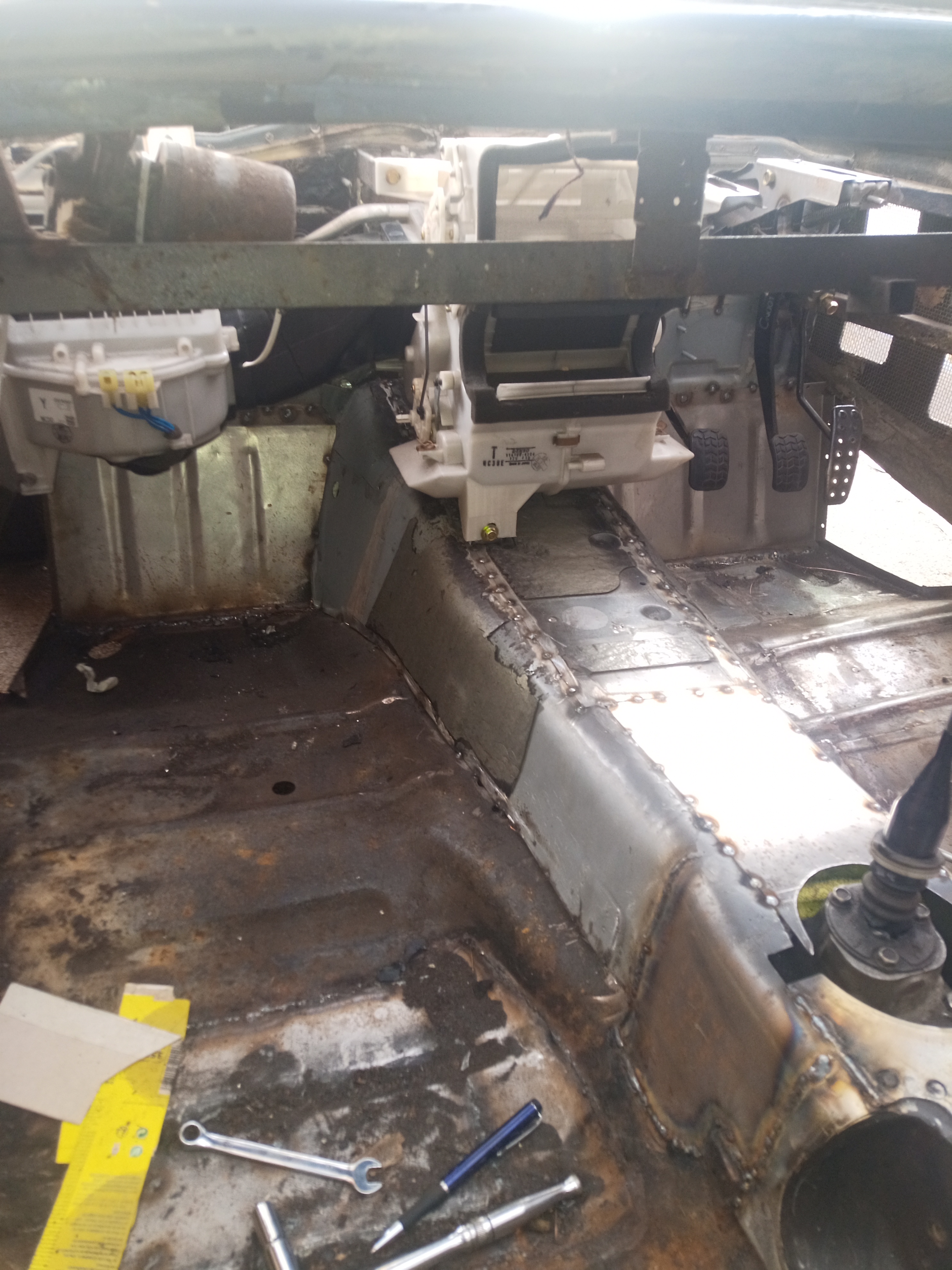

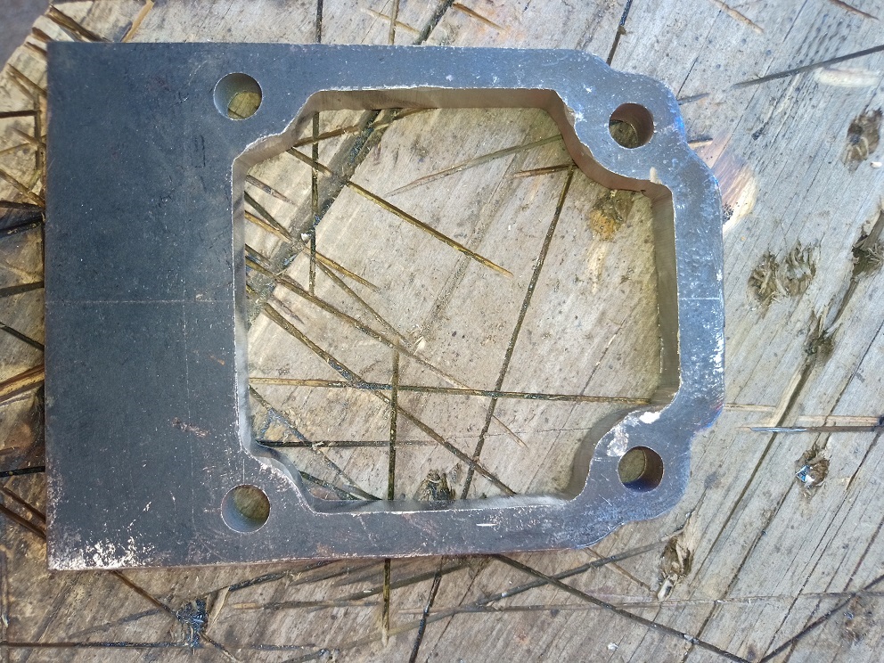

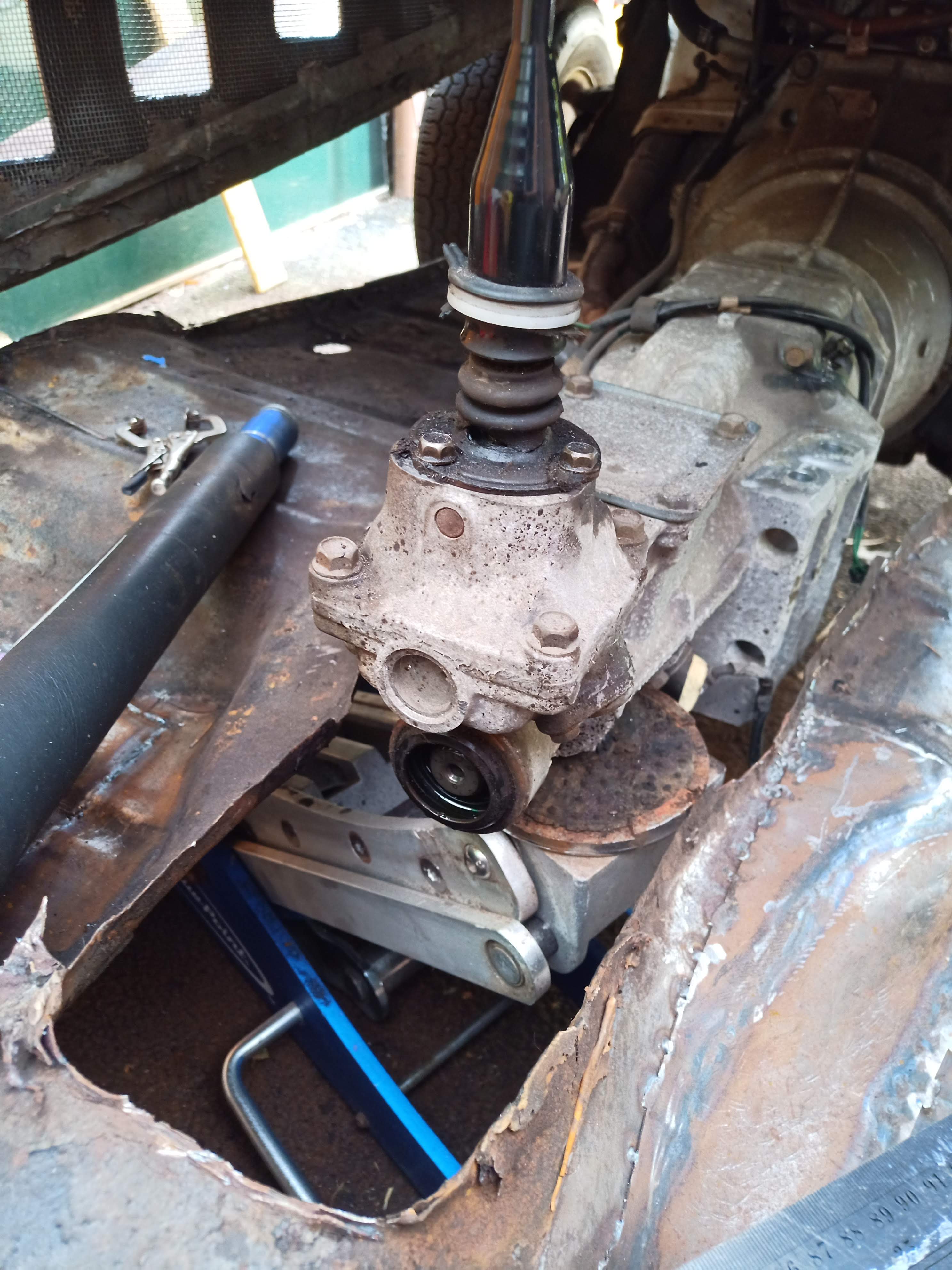

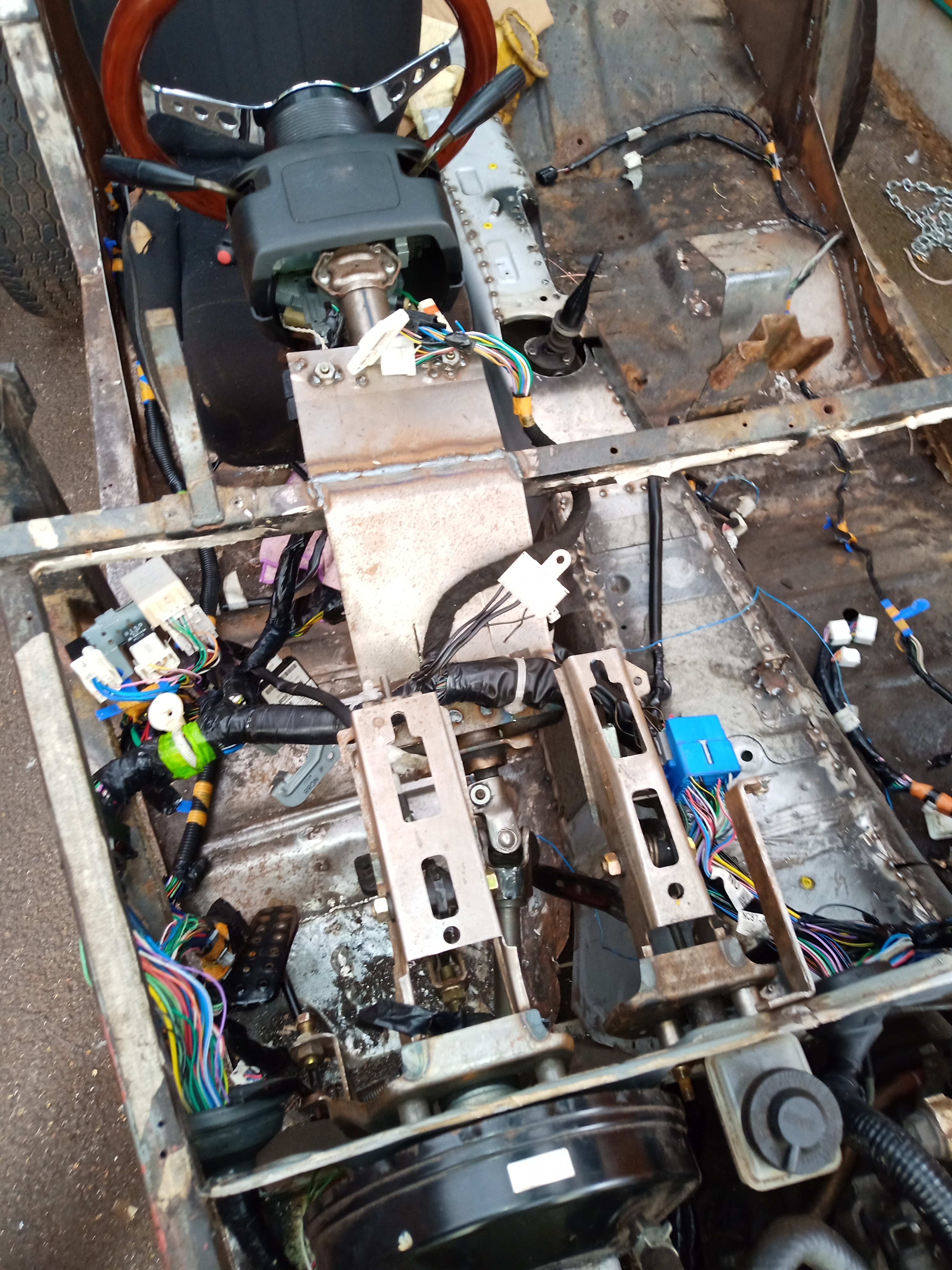

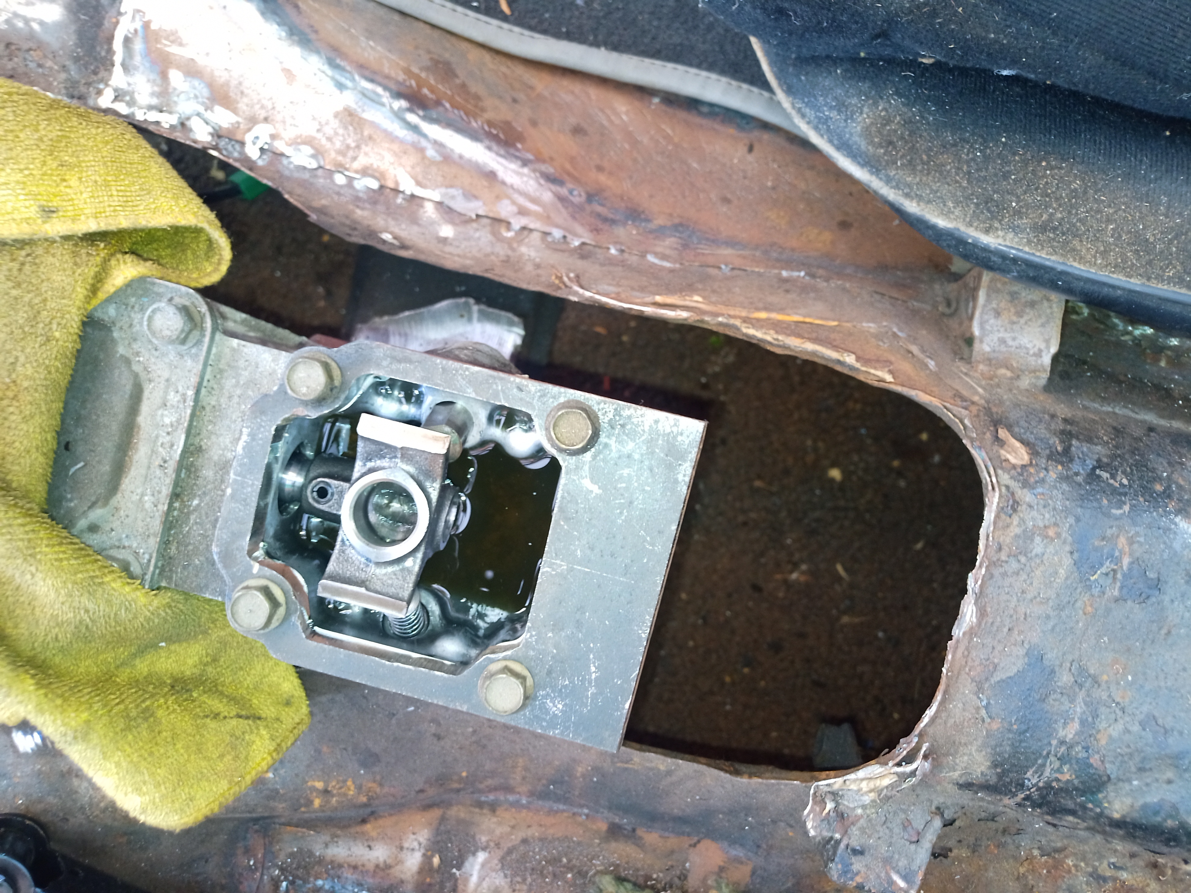

there was so much fubar on this car so i am fitting as much mx5 as i can,
showinfg the gearstick which was too far forward, almost under the dash,
so i made a pair of these, this one for the gearbox and another with the wide bit at the front.
this moved the gearstick back a good six inches, now the hand fall off the steering wheel straigh onto the stick.
then it was a case of cuttinfg and shutting the mazda tunnel to fit.
Now the handbrake can go where its supposed to be, not on the floor where Panther put it.

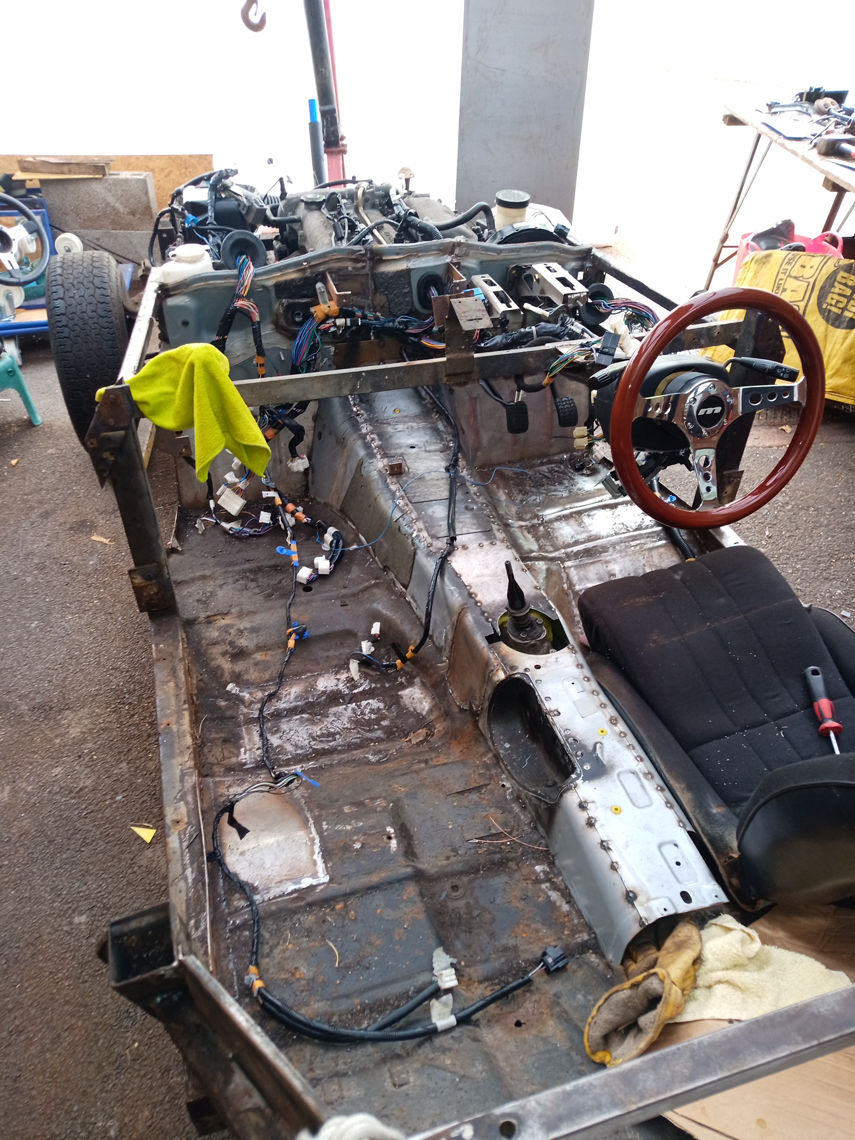

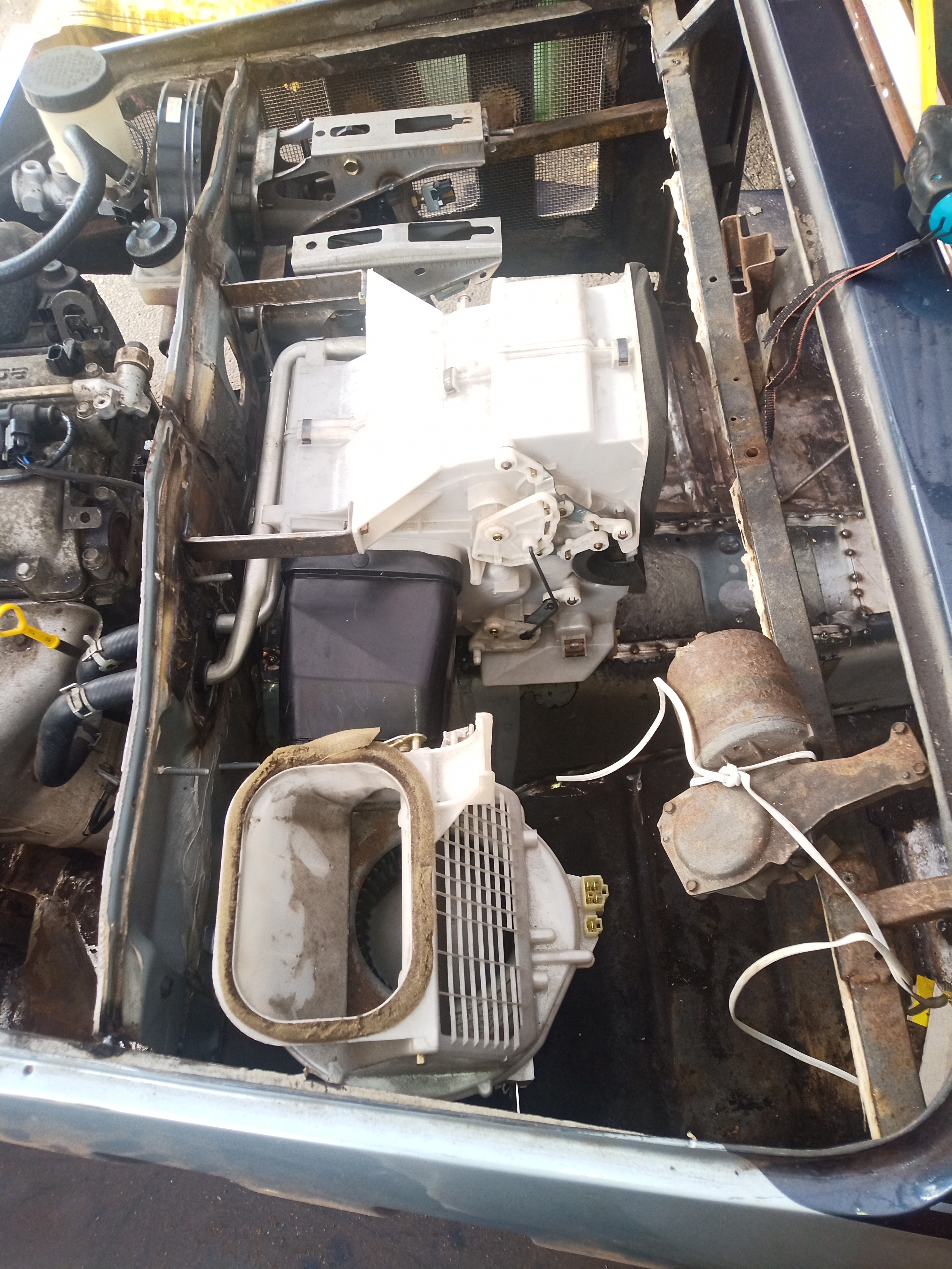

Mazda heater box and blower motor going in.
Mazda steering column and switches mounted, (the originals were toast wrong ones had been fitted anywayincluding ignition switch with imobilizer, mazda wiring loom going in too, including the alarm system but minus airbag and ABS and a bunch of other wiring thats not needed.
then all the bits and bobs in the engine bay, fuel pipes, relays, air box, washer bottle, clutch and brake master cylinder, just enough room for the rad up front, but no room for the battery, so thaats going in the boot same as the MX5, i have all the wiring for it.

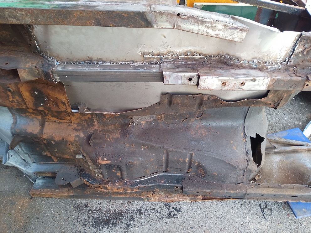

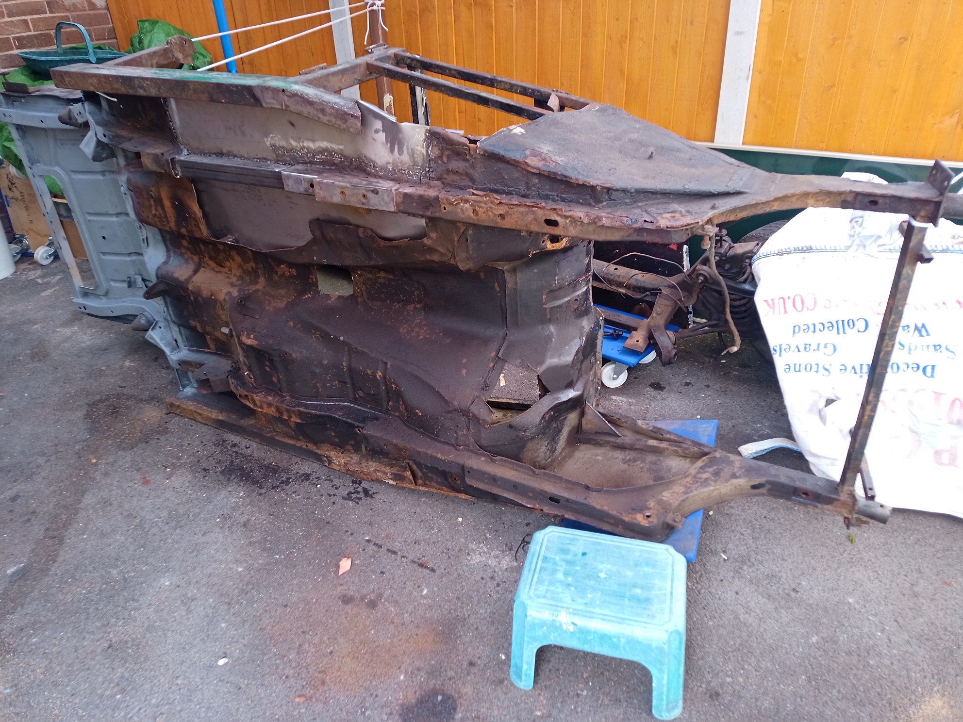

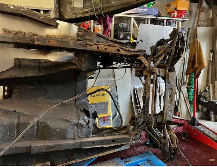

Tore it all down to the chassis now.
Everything gone to the shed for the winter.
Finished all the wedding topside.
For the moment now she is on her side waiting for the final welding underneath, but another project has reared its head that I have to get done before the end of January.

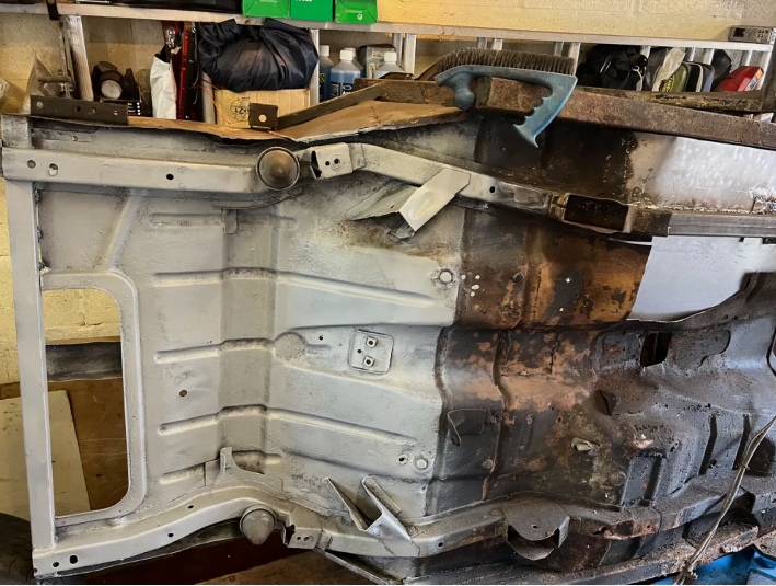

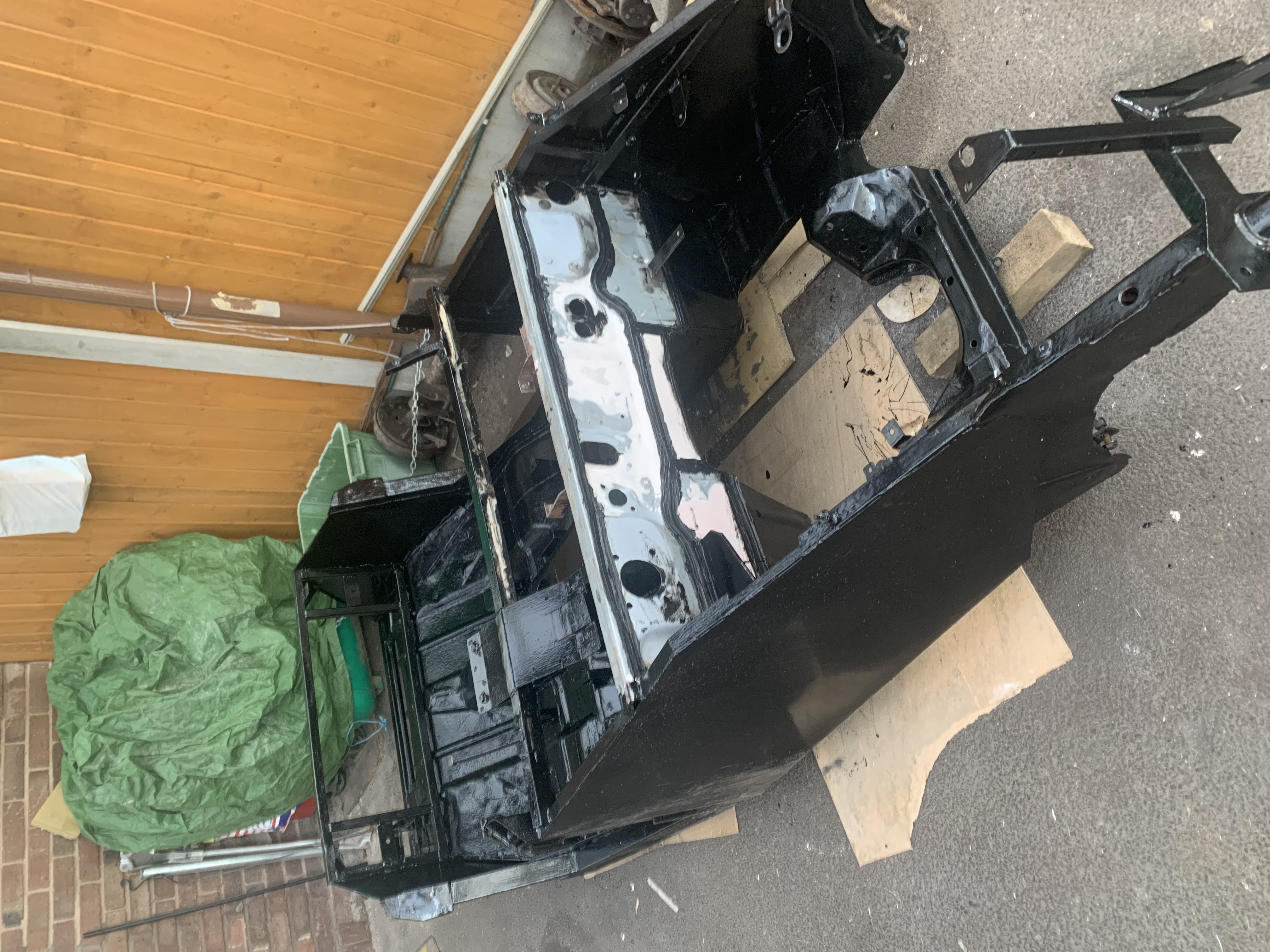

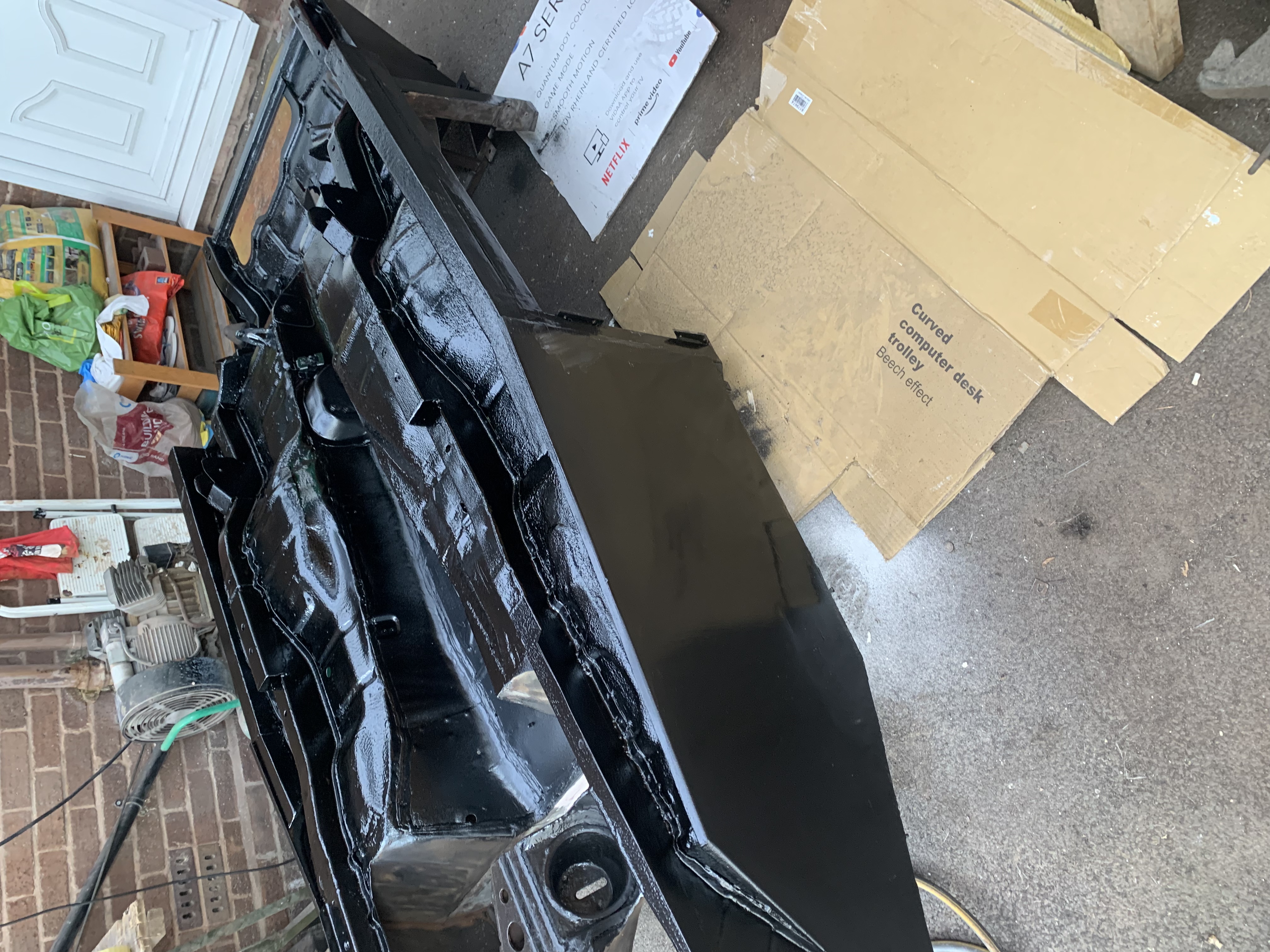

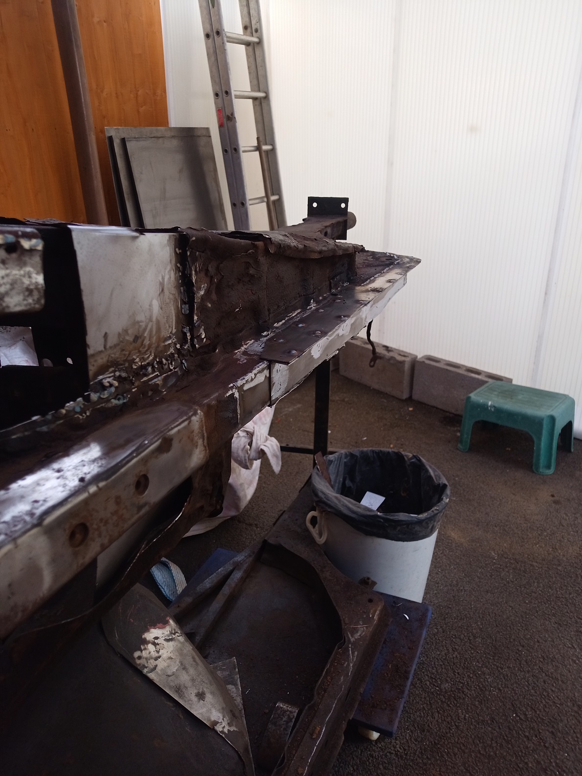

Welding finished before winter didn't happen, no surprises there, but the weather is starting to warm up here in the UK so i have had a few good days on it, weather permitting. Seat belt mounts fitted so they will now work properly, boot floor altered to take the new fuel tank i made, clips for the fuel line and battery welded to the chassis rail fuel line from mazda fitted real nice with a bit of tweeking,
So now it is time for the big clean up before i get some paint on it,
Pictures to follow
mezy
mezy

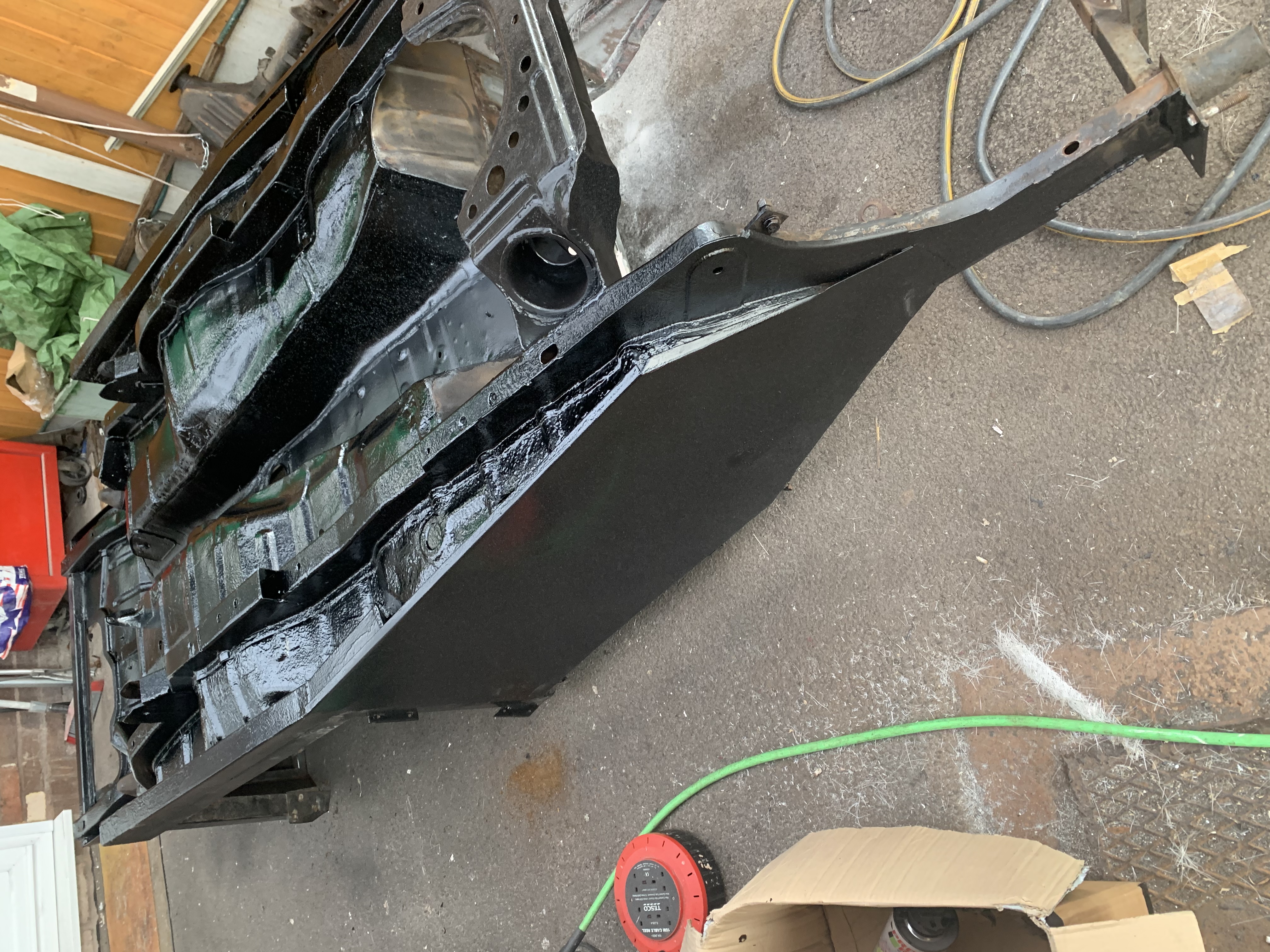

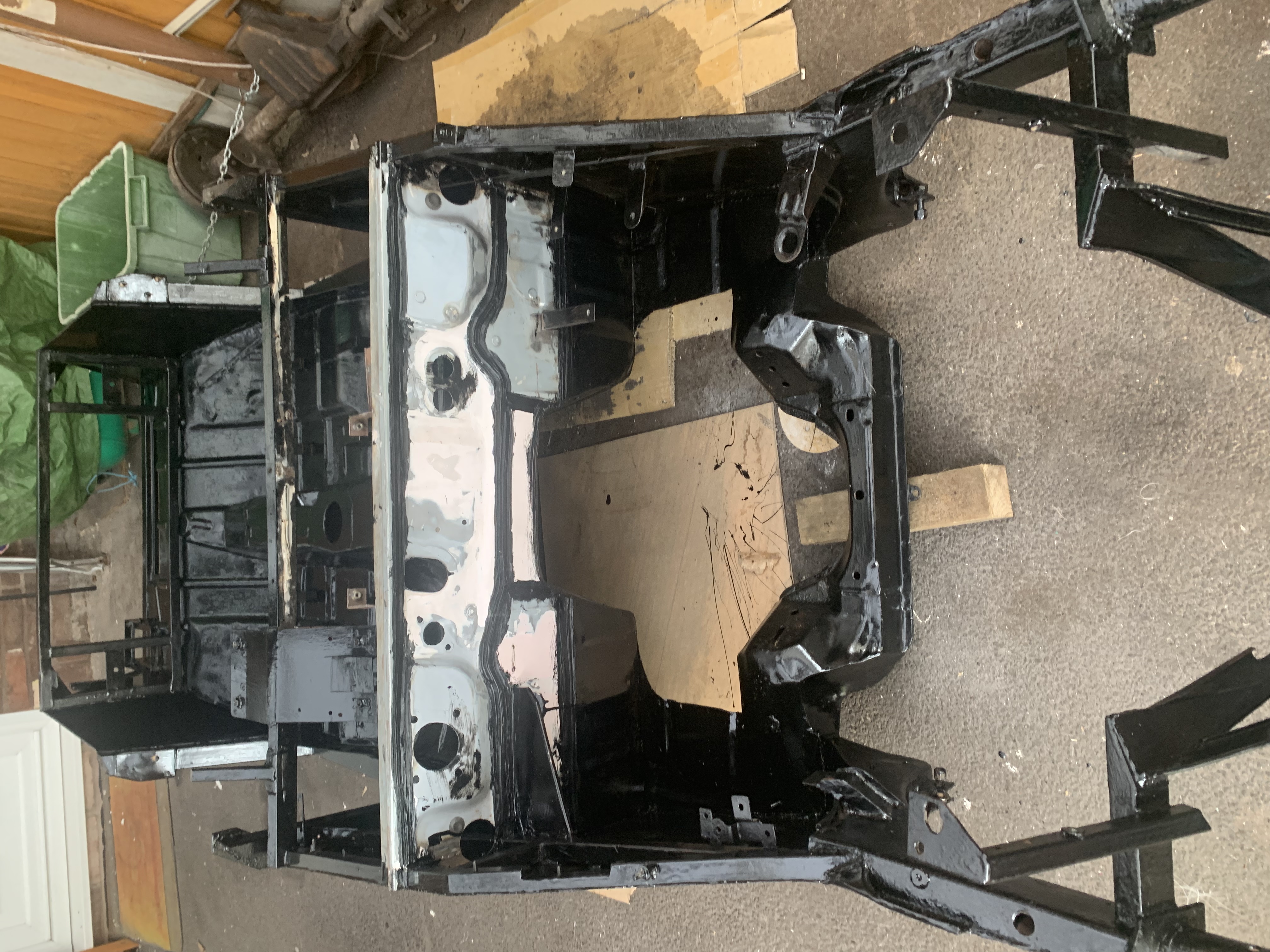

clean up all done. Underside has been painted in black hamerite the seam sealed followed by two coates of underbody shutz.
waltesefalcon
It's looking good.
You know that's upside down, right?
