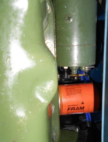

The question is: How in the world do you get to the oil filter in the Bugeye to change it? There appears to be no way to do it from above, through the engine compartment. I looks like the only possible way is from beneath, through a small hole more or less directly below the filter. But there doesn't seem to be enough room to wrestle the filter into place.

It's not difficult at all from underneath...

Shouldn't be that hard. Car on ramps, grab the filter from underneath. I usually use K&N filters because you can use a 1" stubby wrench on them. There's two or three variations on the spin on filter mount though...
