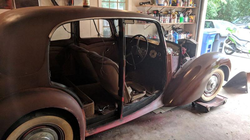

I wasn't looking, honest. This one just kind of dropped in my lap and I could NOT pass it up for the price. It's a 1949 Alvis TA 14 Saloon, Mulliner bodied. Obviously a bit of a project, but nowhere as bad as it looks in the picture: mechanically it's very sound and actually almost driveable except that the brakes (yes, mechanical) need to be adjusted properly. Legal to drive? Well, no, as there are no lights of any kind attached. They're over there, in a box. Actually there are several boxes, which is good because for the most part all of the bits seem to be there, just needing to be reinstalled. The bodywork is very, very solid. The structural wood is also very solid. Basically, the wood trimwork needs to be refinished, the upholstery needs to be refreshed, and the bodywork just needs a final going over before paint. Brand new tires were part of the deal, which made it much easier to fork over the cash. Most of the exterior brightwork such as headlamp housings, bumpers, etc. are already quite good and should polish up nicely.
I purchased it as an abandoned project (the previous owner had done the mechanicals, most of the body work, and then decided it wasn't really his cup of tea) so I take over from here. The paint you see is just paint he sprayed as he was working on it to cover the bare metal. In a perfect world, it needs nothing but my time (well, and paint) to finish. In the imperfect world we live in, I'm sure there will be some bits that need to be scavenged (not like there are a lot of Alvis parts suppliers out there) and cleaned up, etc. Still, it promises to be an interesting project.
The problem I've run into thus far is that there isn't a whole lot of information out there about specifics on these, manuals are non existent, and since I am not likely to see another one out in the field I'm pretty much resigned to looking at pictures on Google and trying to figure out exactly how things should appear, how they should go together, and little niggly things like what type of weatherstripping to use around the doors and such. All the details. Any advice is cheerfully accepted!

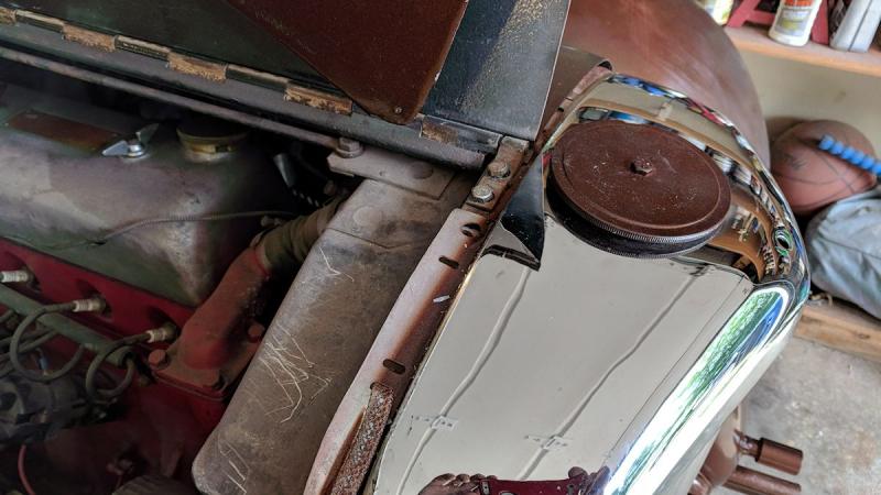

First order of business was to remove a number of parts, and I have to say (this being the first wood framed car I've ever worked on) that if it all goes this easily I'll be thrilled. The doors? Held on with wood screws. It was like removing your bathroom door. 10 minutes to remove all 4 doors. Bonnet was similar: two wood screws at the rear, and two machine screws (Whitworth, of course) at the front holding down the rod for the piano hinge. Most of the interior woodwork, including the wood dashboard, is also removed for reconditioning (and so as to not get paint on it). Wood screws all around for this stuff. And the seats and carpet are removed as well.
Whew.

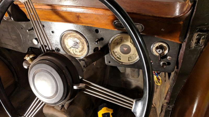

Progress being made on the TA14 Saloon. Doors removed, bonnet removed, seats removed, windscreen removed, dashboard and most of the interior woodwork removed. Placed an order for new inside and outside door handles and window winders today. The "temporary" paint in the photos starts coming off this week: hopefully the car will look much different in a month or so.

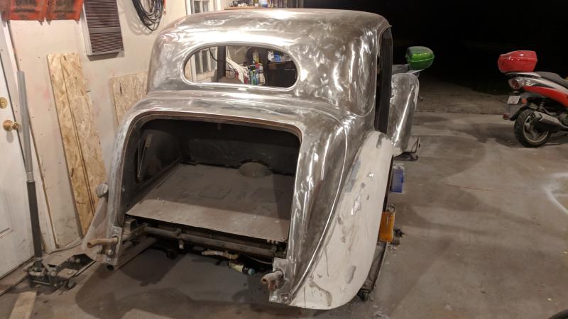

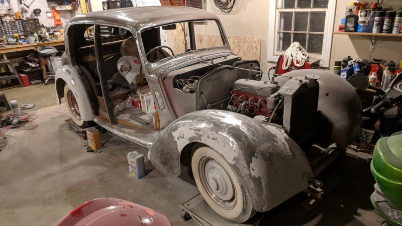

A bit more progress. Doors, bonnet, and boot lid are prepped and primed. The rest of the body is stripped to bare metal (and some Bondo, an unpleasant but not unexpected surprise). After I took the attached photos, I took the front fenders off since they will require the most work (the rear fenders were just skim coated, but the front ones are a bit of a mess). Hoping to have the rest of the body primed in the next week or two, and then go back to the front fenders.

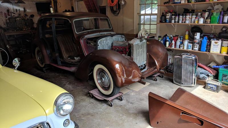

Thanks Mick. Yes, I am still here. The progress on the Alvis has gone much more slowly than I would have anticipated, not due to the car itself but more to life getting in the way.
I'll get some progress pictures up shortly, but where I'm basically at is that the body is done and painted, other than the front fenders which have presented their own unique set of challenges (it's ALL curves, not a flat spot to be found on them which makes body work very interesting). I may be in the process of moving, which is further putting things off, but one of the reasons for the move is that I will have a 1200 sq ft shop just for working on my projects! This should make things much more efficient as far as getting the Alvis done since I won't have to work around the rest of the garage uses (currently I only have a 2 car garage to work in and there's lots of other stuff taking up space in there as well).
