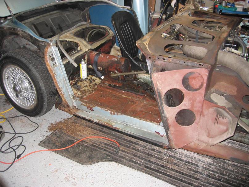

healeyblue
Yes definitely race the cockpit before doing any removal of panels or welding. I too had a fairly rust free car from New Mexico but I still did not risk any frame tweeking by not bracing the openings prior to any work. It has paid for itself because now that the car is going back together everything is still fitting. Don't risk it even though the chassis seems strong and sound...Brace it.
Jim
drambuie
59austin082206 006.jpgHello Matthew,
I live in Bali Indonesia part time and know many Australians who live in Bali and Oz! Welcome to the Healey world! In fact my first Healey was a 1959 BN4 I have alot of tear down pictures when i was doing a frame off.... replacing floors and sills as well! I do advise keeping your motor and transmission in place when Replacing your sills, and i also braced the door openings as they do when replacing sills in e-type Jaguars. There are many great people in the forum who are very keen when helping a fellow Healeyist! So fire away with any questions you many have. Michael, IL.View attachment 25056
Some years ago, I made up a pair of modular/adjustable braces. The turn-screws allow for fine tuning the door shut and swage lines. They are attached near the hinges and latch points, and the doors can still swing shut (a benefit to getting the positioning right.
A little time spent fabricating the right tools/fixtures can save you a lot of trouble later on.
Take a look at some of the details of construction, and see if you can rig yourself up something similar: https://www.spcarsplus.com/gallery3/index.php/Bic-Healey-Deluca-s/door_opening_fixtures

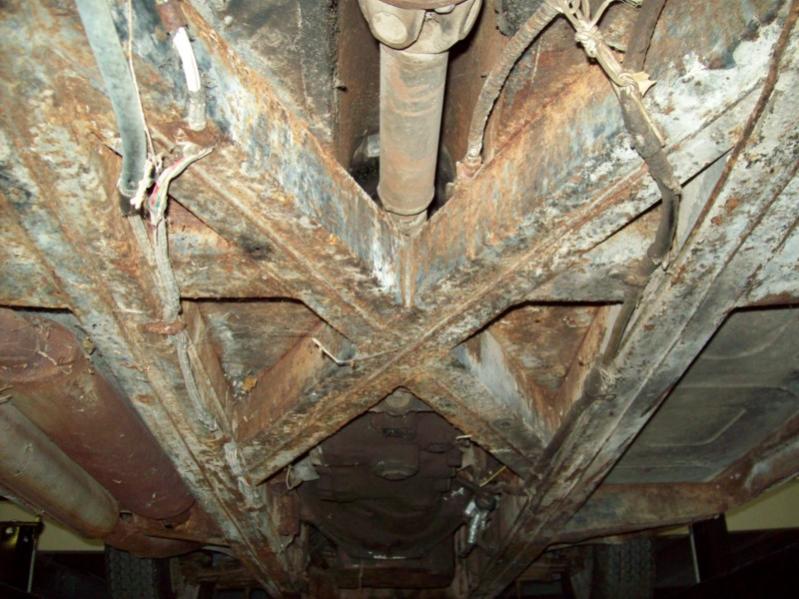

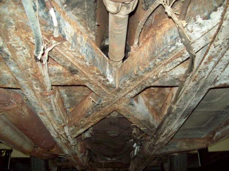

Great pictures! and very useful. Thanks so much for that.SN2727-13U.jpg Yes, I think my car is solid. Here's a pic of the underside: surface rust but (I think) generally strong.

Great pictures! and very useful. Thanks so much for that.View attachment 25058 Yes, I think my car is solid. Here's a pic of the underside: surface rust but (I think) generally strong.
Matthew
IT appear strong, but I see the quality of your harness -please don't switch the battery ON! or you have a welding machine
