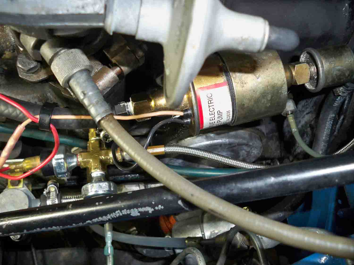

Hear is what I did. Due to some recent contractor changes around the house (too hot to work) I only had this weekend to fix the car so I went back to the electrical fuel pump. However this time I installed a oil pressure shut off switch that came from NAPA for only $8. Backed out the T connector and got an X connector. Made all the connections for the axillary oil line to the head, new oil pressure switch for the dummy light and the new 2 pole switch for the cut off to the pump. So far works great. The only thing I didn't figure in was a roll over. Just hope the engine cuts off quickly!!
