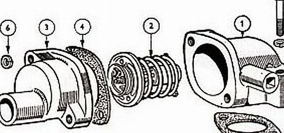

Anyone running one of these? I have been running a plug in the bypass hole with a 1/8 hole drilled in the plug. I did blow a bypass hose last summer but it may have been due to age. Is this new Moss thermostat a better way to go? Around $75 Incidently the temp gauge(which went to higher temp when tested in a pot of boiling water) failed to indicate the higher temperature when the bypass blew! It was only upon checking the rad that I realized I had lost a huge amount of coolant. Karl
Don Elliott
Karl - The sleeved Thermostat automatically blocks off the bypass so if yours is blocked off now and you have no overheat problems, don't "fix" it "if it ain't broke"!

Seems to me that would only be true if you have also drilled holes in the thermostat plate (as I do). The heater is partially in parallel with the bypass, so restricting the bypass should force more water through the heater core.
Also worth noting that the factory later went to a smaller bypass passage and a non-sleeved thermostat, around the introduction of the TR4 as I recall.
Not sure, but I believe those cheap sleeved thermostats from Moss were a different design, essentially a sleeve added onto a wax pellet type thermostat; instead of a reproduction of the original bellows (aneroid) thermostat.

Bob_Muzio said:
Randall, the TR4 also uses the sleeved stat.
Yup, I misremembered. The TR4A used a non-sleeved stat (140970). Curiously enough though, it used the same housing and bypass as the TR4.
