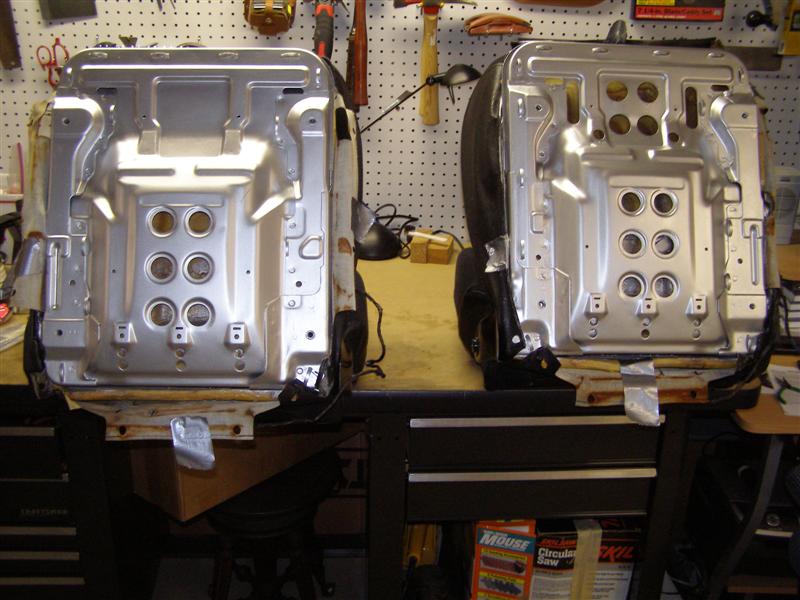

This morning was a good time to get rid of the Hog Rings the easy way and get the seat cushion pans ready for paint with some POR15 Rust Remover.
A few applications of this stuff, a few hits with a Scotch Brite Pad and brass brush and we're ready for paint as soon as the cracks and crevices dry.
These bad boys get rid of the Hog Rings in about two seconds each, with no effort at all.
A few before shots. This is the passenger seat. The drivers was worse, but no rust through, just surface coated.
Much better to cut the rings, move the seat cushions back and get all of the sides done as well.
Be smart if you ever use this chemical and wear gloves and eye protection. Oh yeah, ventilation helps too. It is acid based and smells a lot like Dupont Metal Prep we used in the 60-70's at the dealership. That stuff was green at the time. I should remember it, because I hated it and the smell that it left on your hands and what it did to your skin before we were smart enough to protect ourselves.
First coat on and ready for Scotch Brite.
After two coats, Scotch Brites, small wood handle brass brush once over the cracks and a soap and water wash down.
Now for some drying time and the paint will go on later today.

This picture of the pans with the second coat of Rustoleum applied. That will do it until they come back from the shop.

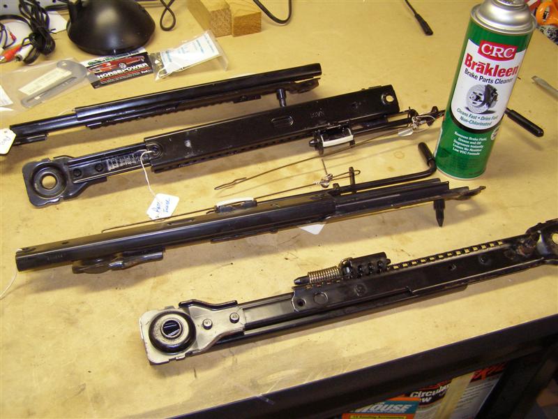

Seat tracks are all cleaned and degreased and straightened to fit the adapter kit. Now I have to cut off the studs and grind down a few ridges and paint those guys. Then a re-lube of the rollers and tracks and they'll be ready.

Picked up tracks and they are just about ready for paint. Two key things that you need to do, which I confirmed with Bob. All four (4) of the ends need to have the raised portion ground down to allow a flush fit with the adapter rails and the stud should stay above the surface of the track. The stud also is a big rivet which if cut flush with the track, might weaken and come loose. Staying just above allows it to hold the front section securely on the track itself.

Paul- You got a before and after of those tracks,the grinding
Brosky
Brosky
Sure do Don. I'll post them tonight when I get home. You can see it in these, but not that clearly. I think that I have better pics at home.

I could have pulled them off easily, but there was no need. I did lift the seat cushions and foam completely off the pans to check them up top. The upper pans were rust free and shiny. The shop will be using the covers to make patterns to cut the new seat covers, so he prefers to do it himself and do the disassembly there.
