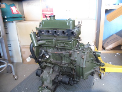

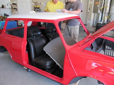

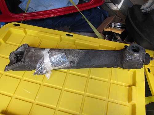

dklawson
Great pictures!
That is probably a 1275-S engine but I still cannot tell you for sure.
The distributor is a 23D4 which was used on the -S.
The gearbox is a remote shift (the yellow picture above is of the Cooper/Cooper-S remote shift extension).
The removable tappet covers (one with a breather) are clearly visible on the back of the block.
This is probably a late Mk2 or Mk3 1275 engine as the gearbox output shafts are the "pot joint" type.
What surprised me is that one picture shows a single carb on a manifold. An -S would use a pair of SU HS2 carbs from the factory and some people fit a pair of HS4 carbs. It wasn't until later that BL started fitting single large carbs. There is nothing wrong with a large single carb, it's easier to adjust one than two... it's just a surprise with everything else you have there.
It looks like the previous owner fitted a manual heater shut-off valve to the cylinder head. It's the type found on very early small bore engines. Did the seller provide you with a heater? If so, you may want to get a later heater valve and cable for it.
It looks like you got a great project there. I hope they did a good job on the paint and bodywork. When you get a chance, post a couple of pictures of the following areas.
Top down of the engine valve cover.
Underneath the shell, looking at the sills under the door opening.

EDIT: I have a question for you and the previous owner. In picture 17 you show the exhaust system. It LOOKS like you have a catalytic converter in the pipes. Why? Was emissions testing required for a 1968 car where you bought the car? The car certainly would not have had a converter from the factory.
