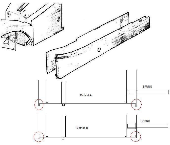

Hello,
I am replacing the sills, floor and much more on my sprite MKII. It has corroded in the extent that I am not able to check if I have received a left hand or right hand inner sill.
I have looked trough different parts manuals. None have detailed pictures of how it should be.
I hoped someone had pictures of there repair/restoration where these details are clear to see !
I attached a picture. Of two possibilities. I received an inner sill with the edges bent so Method A should be made.
If the edges are bent the other way, Method B could be made. But then the edges of the other panels have to be bent !
Please help to set my mind at rest !

welcome,
i will hazzard an educated guess... Method A. Makes more sense if the panels were originally spot welded. Also doesnt require further bending as you have noted.
I am sure some one here has done this and will be along shortly to confirm or correct this
Once again Welcome to The Forum
