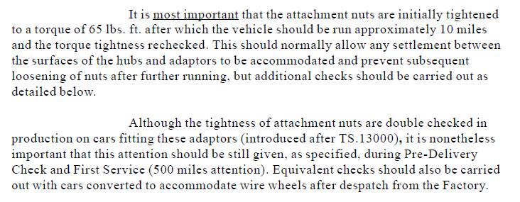

Hi guys - Geo has it right. I'm asking about the bevel nuts that secure the splined hub adaptors.
Seems like consensus would be impact to tighten and torque wrench to confirm - fair summary guys?
Considering that I've seen those nuts come loose twice now, with nearly disastrous results both times, I would not only use a torque wrench but follow the factory advice to recheck after 10 miles, and again after 500 miles.
