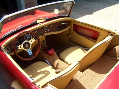

If I ever get around to restoring the ugly bug, I'm going to hire an upholstery guy to do the panels and seats so that I can get the exact color and vinyl style I want.
Go to the street rod shows and you can find out who does good work in the area.
I'm going off a few years of memory -- I think I ordered 5 yards. 3 for the seats & 2 for the panels. I still have lot's left over.
What color George?
Tan
