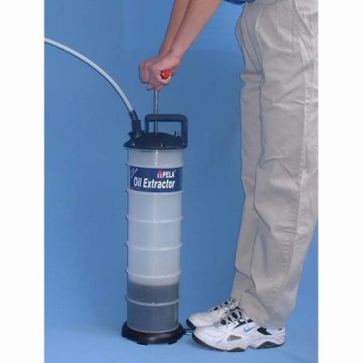

Chances are the missing part at the end is long gone. I've seen this more than once. It's not unusual for the plastic tube to be brittle and fragile. If you have all the plastic removed, I think what I would do next is get one of those pumps that will allow you to vacuum out the oil through the dipstick. If you can push the tube in straight, you may be able to suck up any potential bits directly below the opening. The next thin I would do is use a heat gun or an electric heater to warm the pan, and make the oil flow a little better. The remove the drain plug and drain any remaining oil. Next, I would get some motor flush or kerosine and put in a quart or two let it sit for a while (maybe an hour or two at least) so that any sludge will dissolve. Drain and repeat, depending on what comes out.
https://www.wholesalemarine.com/pel...apacity.html?gclid=CJ3i__vvib0CFc1j7Aod4BEAog

I'm liking the flush/suck ideas - if anything to see if something came out with it. I've already drained the oil as part of reawakening the Midget, so I could go directly to the flush.
If the thing leaked already or had any other big issues, I'd be more inclined to pull the engine. I'm hesitant to start working loose the pan with a putty knife with the engine in place, fearing I'd get part way, still not have it be removable, then HAVE to pull the engine to finish the job.
