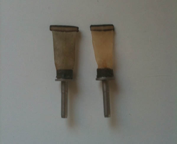

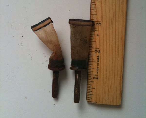

I just bought a set of new Brake Fluid reservoir bottles for my Series 1 EType. The new bottles look great but they did not come with the little filters that are in the original bottles (They are in the bottom of the bottles with the pipe pushed into the outlet hole at the bottom of the bottle. They have a cheese-cloth like filter that is meant to filter junk from eh brake system. I called all the usual suspects but no one seems to carry this item.
Does anyone have any ideas where I might find this part? I have tried the following EType vendors:
SNG Barratt (USA)
Terrys Jaguar
Classic Jaguar
XKS Unlimited
So far no luck. I have the originals and "could" possible clean them up (They are very bad from years of sitting around). If anyone has any contacts in UK perhaps who might carry these?
I've attached a picture.

I think I can clean up my existing filters and use them again. The Bases cleaned up pretty well in my abrasive cabinet (very fine glass abrasive). Then I am soaking the gauze part of the filters in Mineral Spirits. I'll then Epoxy the filters back to the base and see how that looks.
mikespain
Those filters look like the ones used by paint sprayers on the pick up pipe of the spray gun,they just push on might be worth a look/try

I'll look into that, thanks. In the mean time, I did the best I could to clean up the existing filters. I was able to take the filter part off of the base and soaked them in mineral spirits. Then I cleaning up the base/tube with a bead blaster (including inside the tube). They came out pretty good. The filter parts are still a little discolored, but other wise clean.

look good to me-if the filters are still intact no need for new ones
Yeah, the filters are basically in good shape, just a little discolored. I managed to get the base/tube cleaned up like new.
