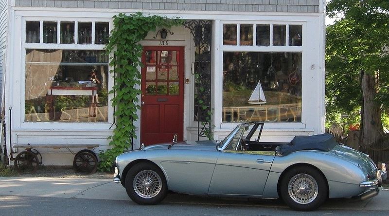

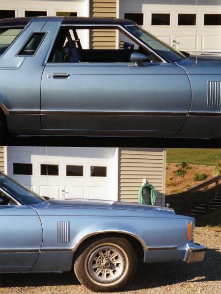

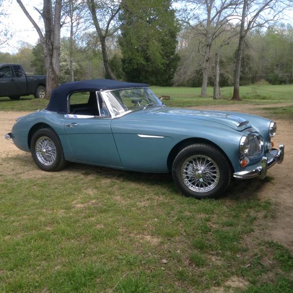

The Austin code BU-2 is the code given in all the resource books. But when I had my paint supplier mix it up it seemed way too dark for me. Even though I believe much of the original cars with Healey blue were darker than many of us remember, this mix was really just too dark. So as Derek has said, I picked out some cars that I thought looked alot like the Healey Blue that I remembered. As it turned out I settled on the light blue metallic of the 1979 Thunderbird. Attached are the pics of both of these cars that I painted. I'm very happy with the blue.

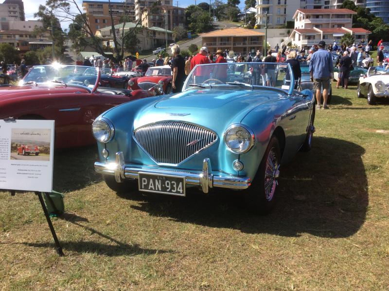

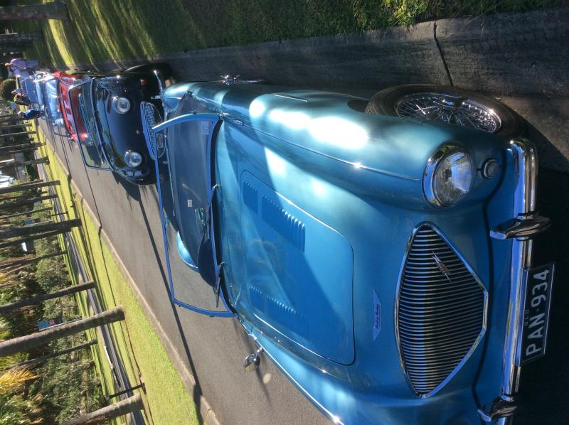

When I was restoring my BN1 a few years ago Mitsubishi had a colour in their catalogue called Island Blue. I thought it was a pretty good match so that is the colour that I used.IMG_0917.jpg

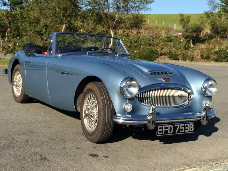

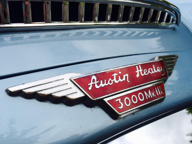

Best to see if you can get a sample of the original colour from a hidden area for matching. I matched from under the front shroud badge.

Thanks to all who have replied. It's a shame there is no definitive standard. Jeepster, yours is closest to what I think of as Healey Blue, but you could also make a case for any of the others. My car was not originally blue, so I have nothing to scan. I'll figure something out and eventually post some photos of the freshly painted car.

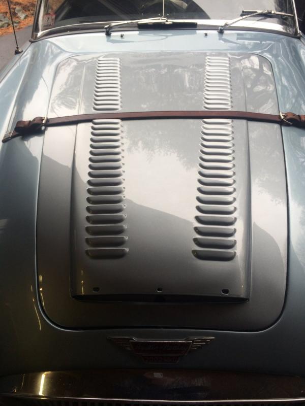

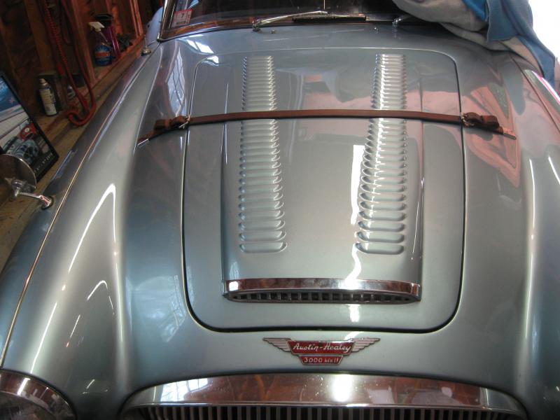

More fun with paint matching. When I louvered a replacement hood I took the originally repainted one to the body shop to have scanned. It came up with the same formula I already had. Perfect! Got the paint and this was the finished product:
Notice how bad the match is between the hood and the shroud? Thought I was going to have to find a shop that could jiggle the formula to get a better match. After a few attempts to find a place that said they could do it, took it to a hot rod shop that ended up plugging in the formula I gave them into their system and .... perfect match!
Was the trouble with the first shoot with the paint shop that mixed the formula or the place that shot it? I'll never know but it goes to show how fickle this stuff can be. And after all the work I had to do to hand prime and block all those louvers three times over, I was glad I could finally get it to look the way I had imagined.
